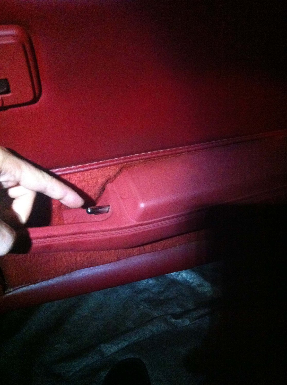

Hi, I have a vette C3 1979 and I can't find what is this silver handle I am pointing in the picture is for? I have the C3 79 manual but it doesnt appear...does anyone know what is it for?
thank you

Door lock ****.
Should look like a typical door lock **** from the 70's...someone has changed yours to a "custom" one.
Push it in and it locks the door, pull it out and it unlocks it.

That's the manual door lock button.
Push in=locked.
Pull out=unlocked

The only thing that I would add to the excellent responses above is: push it in , it locks; pull it out, it may unlock. Having read many threads on this forum, I would not lock both at the same time, unless you are sure they work, or you are sure that you can climb out thru the window.

One last thing, does anyone know how to re-attach it? Mine just came out and the manual again has NO trace of this piece...

Re-Attach? did the little silver "****" fall off? Stock ones are threaded on. You modified one may be a friction fit (stripped threads). Put some adhesive on and re-attach it.
Yes, only lock one door at a time to make sure your not locked out. My son locked himself in the other day, thankfully the tops were off.

Which manual? The AIM shows the lock ***** in the door section.

the entire piece came out when I dissassembled the door cover..the AIM I have doesn't show this piece...

I assume the "piece" that came out is the lock rod. Post a pic. UPC F01 to F12, Sheet 15 in my 79 AIM shows the lock rod. Callout #6. It clips to the lock lever assembly on the door. Turn the page to Sheet 16 and it shows the lock **** in the armrest and the lock rod on the door.
