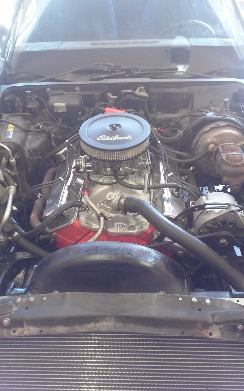

Here's a look at my engine bay after converting from cfi

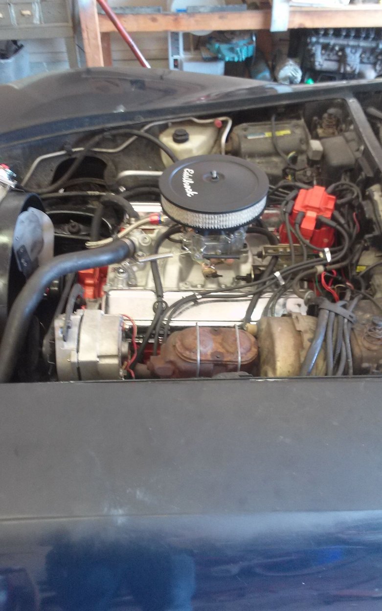

One important thing I noticed from your photos is the 'fit' of the fan to the shroud opening. I think that fan might not be the correct diamater for that shroud. But, you will have to take measurements to be sure.
The tips of the fan blades should be about 1/2" from the inner surface of the shroud. The larger than gap becomes, the less efficient the fan. And that efficiency decreases rapidly as the gap increases. At about 1" (tip gap), the fan is pretty useless.
Also, the fan blades should be about 2/3 inside the shroud envelope. In other words, only the back 1/3 of the blades should show behind the back edge of the shroud. Again, the less blade material inside the shroud, the less efficient. (This is also the case for a blade that is too far INTO the shroud.)
If my eyes are getting the right info from your photos, you may need to get a larger diameter fan and/or shim it to get the proper depth into the shroud.
BTW, have you checked to see that the lower radiator hose (suction side of the pump) has a metal spring inside to keep it from collapsing when rpms are above 2500? If your heating happens mostly at 50 mph and higher, that could be one of your problems. As well, the lower air dam (under the nose valence) is very important in directing cooling air UP and into the radiator. If that is not there, your car WILL have symptoms of overheating.
Oh wow., that's good info, I will be doing some measuring when I get hone, thanks so much for the info
