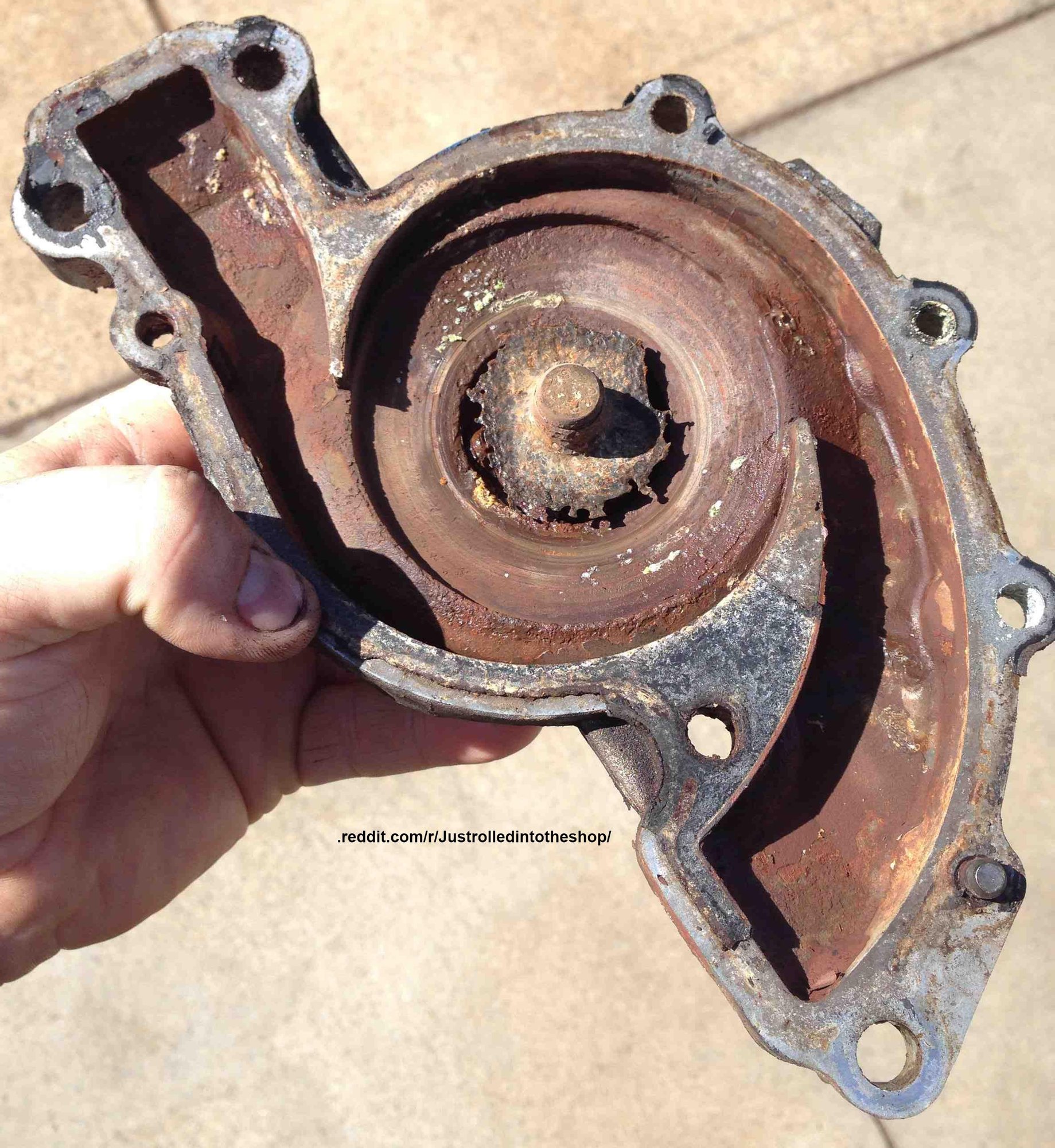

Has the water pump ever been replaced? If so, when? Original/old water pumps used a cast impellor. Over time the blades can corrode, then they don't push as much water as they should.
