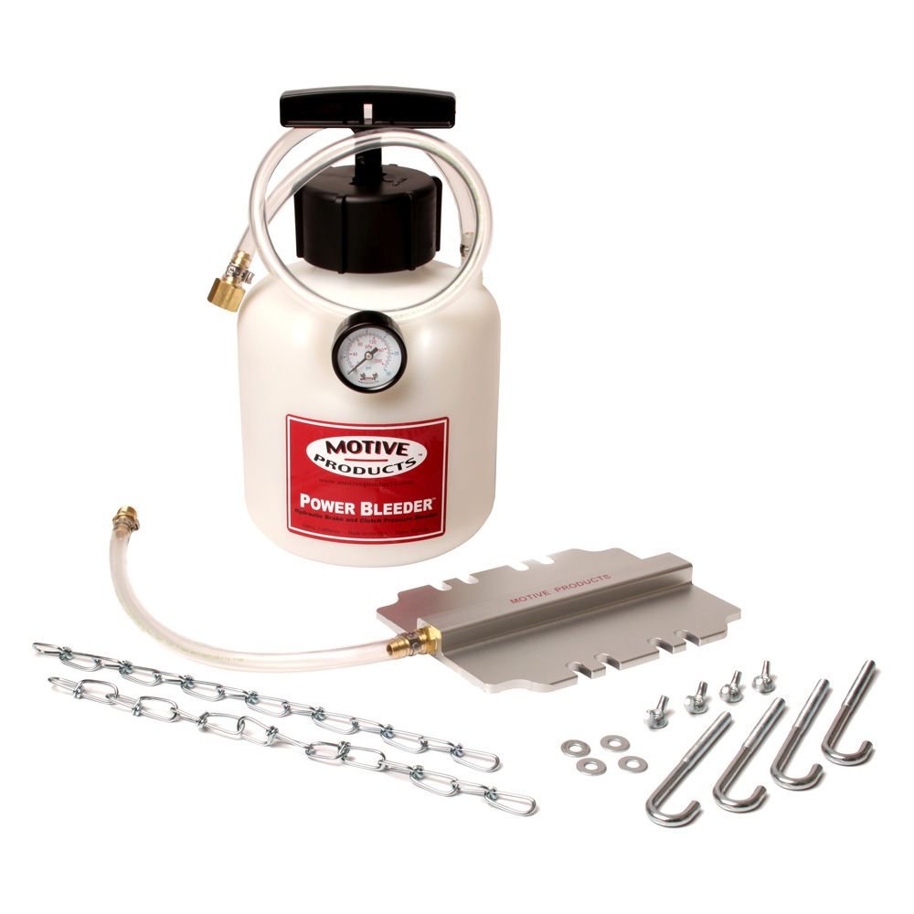

I'm going to purchase the Motive 0105..
I'll let folks know how it goes using that bleeder.
Will the rectangular plate version work on my car
Motive bleeder 0105 Early American Rectangular
Should work fine on your stock MC. You might want to do a search on Motive here in C3. Lots of tricks to make it work even better. For starters, lose the crappy chain and hooks and use c-clamps.

I am now using the Motive Power Bleeder and I am getting clear brake Fluid out of each bleeder valve..... =however.. still no pedal..
I'm thinking it's the master cylinder that's not working properly... I did not bench bleed the MC but I thought the Motive would push the air out..
Any thoughts on what I should do from this point? MC rebuild... and bench bleed?

Finally got good pedal using the Motive

The Motive bleeder 0105 really works.
