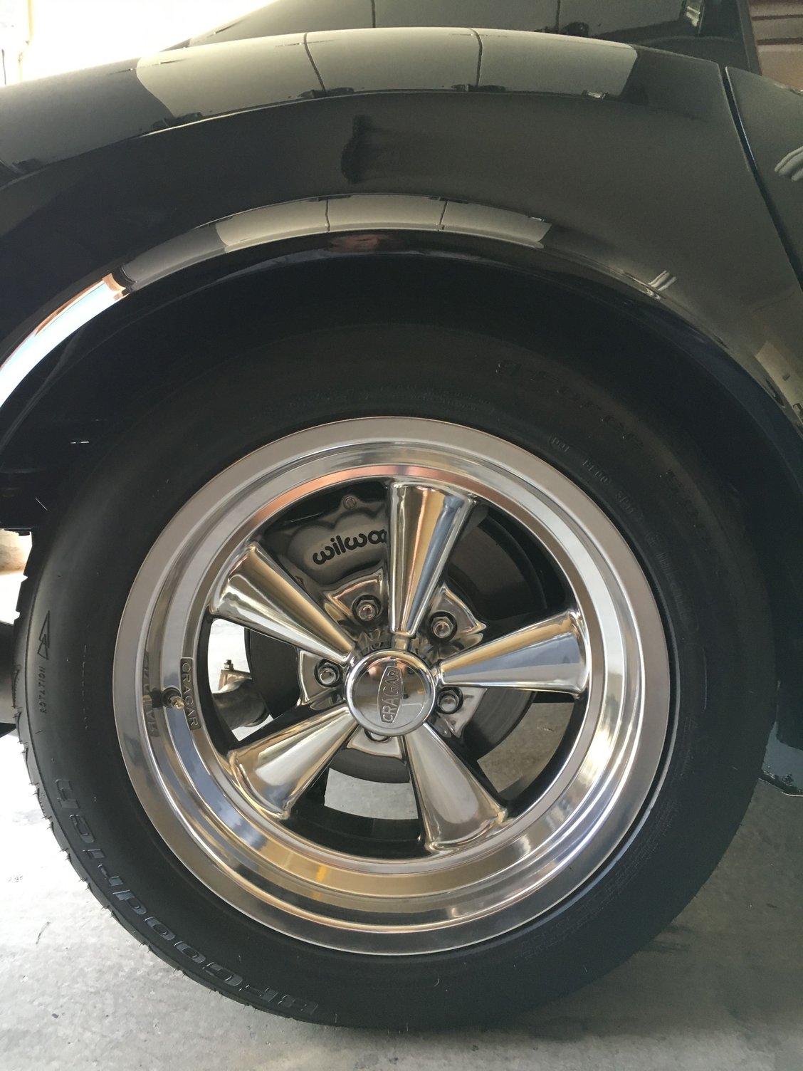

Well Im finally finished with a couple of recent additions to my corvette. Fitech had a great rebate running this spring and I jumped. I picked up the 600 hp unit for 899.00 after the $100 rebate. I also decided to utilize a tanks inc fuel tank with an internal walbro fuel pump. The tank installation was straight forward enough. Running the fuel pressure and return lines neatly was not a problem, but as usual for me, took longer than It should have. The FI throttle body is very straight forward, although I unneccessarily complicated matters by trying to also use FI tech to control timing too. In the end I reverted back to my timing setup I had previously had my car setup too. So after a little head scratching and deep drinking, I mean thinking, I proceeded on. I also added new rear brake calipers from wilwood, while under the car installing the tank and running lines I noticed the RR caliper leaking. Again. It was a sleeved unit and Ive thrown 2 seal kits at it previously.
So anyhow, today I took the all buttoned up car out for a good road test. All I can say is I am very pleased. Ive started and stopped the engine as well as driven around the block enough times for the computer to self learn, and adjust the map. Now with a good solid non leaking brake system, it was time for a nice cruise.
