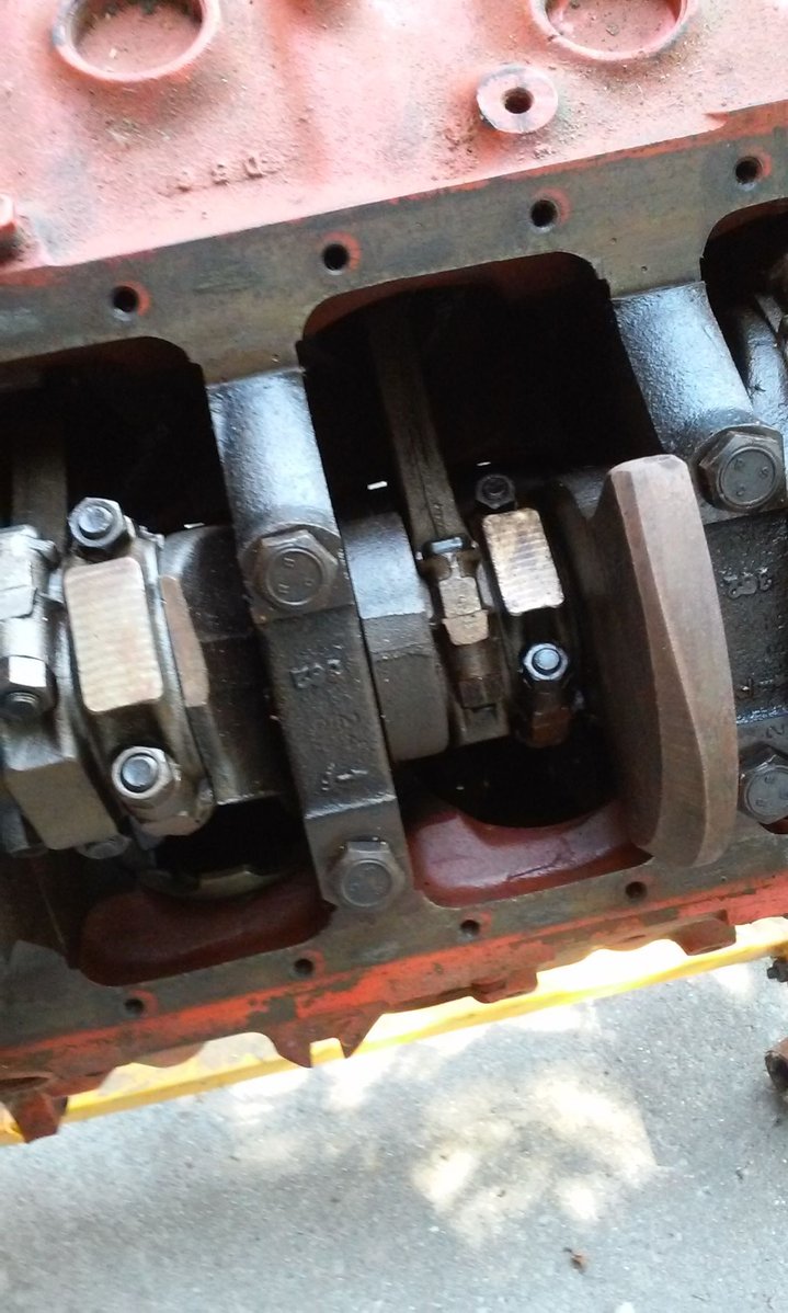

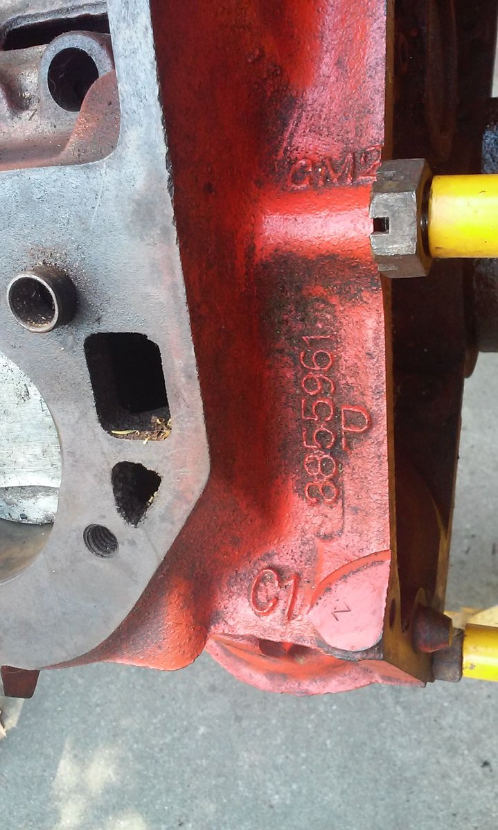

I have a engine it from 1966 it is a 396 hp I have had for a long time I would like to know what it is from I would like to put it my 1969 corvette but not sure it will mount ?

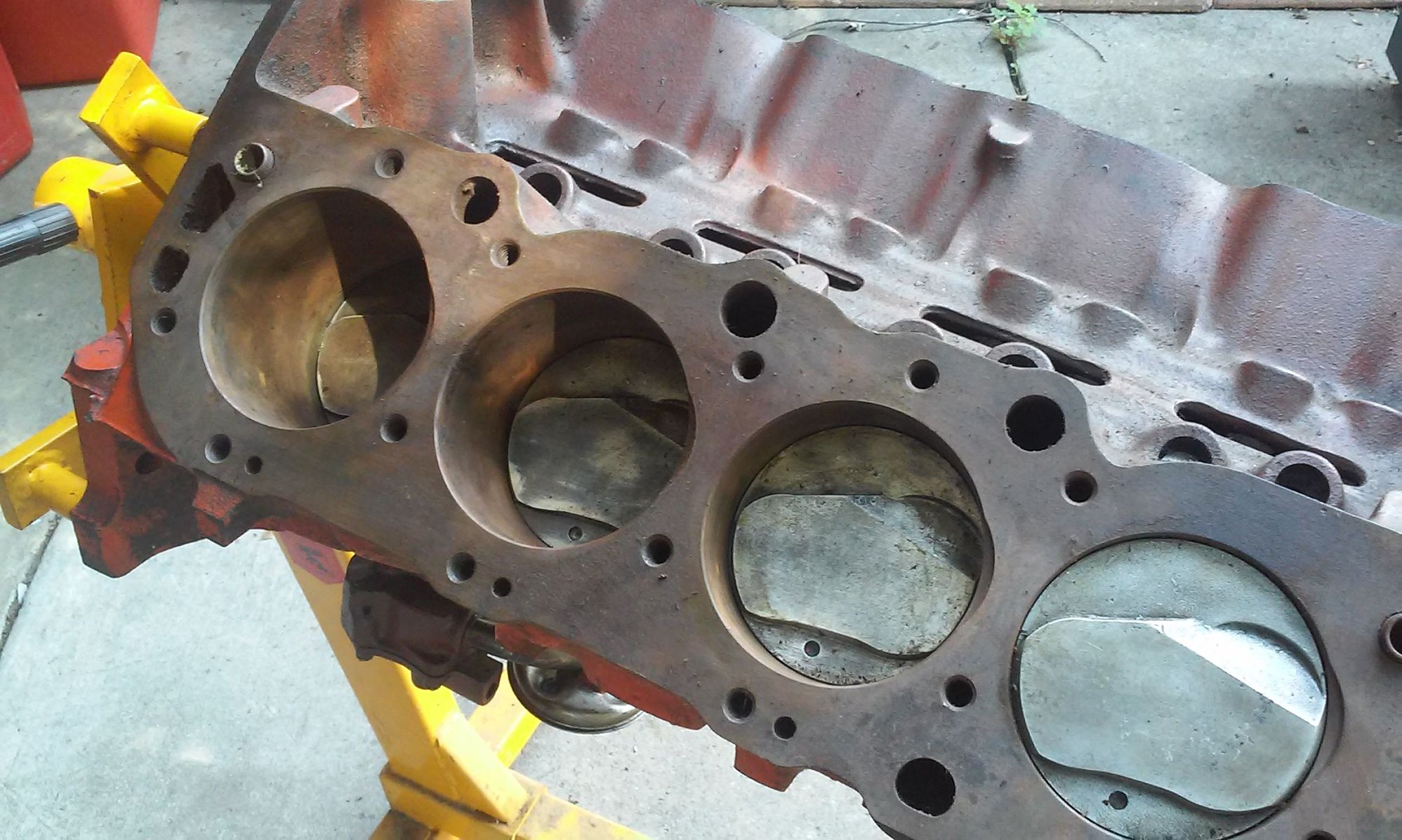

Should fit no problemlooks like pretty high compression pistons might have trouble on pump gas

Hi p,
This info is from the "chevelle stuff" site.
As 530 the engine goes in your car like most bb engines from the era.

3855961 1966-67 396ci 325 & 360 hp, 2 bolt
http://www.nastyz28.com/bbcmenu.php
The ED suffix was used in 66 & 67. The H could indicate Holley (intake manifold indicates that as well)
ED 1966 Chevelle 396 325 Mt
ED 1967 Chevelle 396 325 Mt
http://www.nastyz28.com/gm-chevy-cod...-suffix-13.php
Good luck... GUSTO
