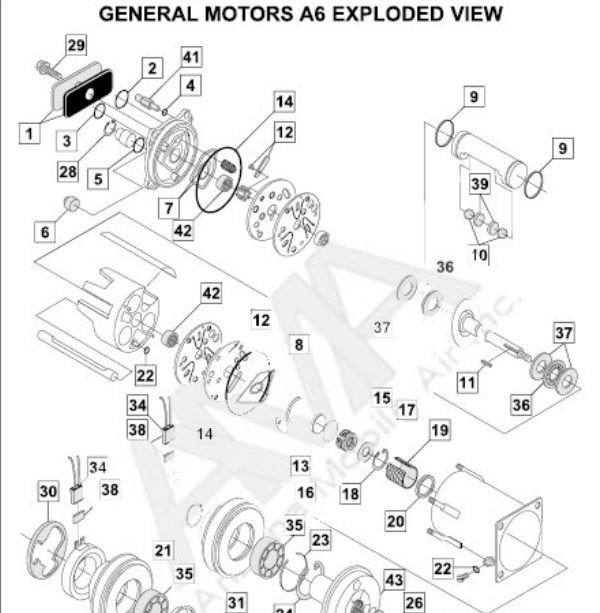

I purchased my 71 350 coupe this spring. My wife said to me if she was going to go in the car during the summer I had to get the air conditioning working. I did that, some electric wiring fixes and a charge the a/c was blowing 46 degrees. 3 months later it started to blow hot again. I went to the a/c shop and the guy put some nitrogen in the system and found a rubber hose had blown out. He said it was a 45 year old hose and for me to order new hoses and change them and come back for a charge. I did change both rubber hoses last week and took the car back today for a charge. When he vacuumed the system down it would not hold vacuume. After an hour of trying to find the leak he found the compressor was leaking from the back on the bottom ( see picture but on the bottom).
My question is does this look like something that can be fixed. The a/c guy said just put a new compressor in. I would like to try and keep the original one if possible.

Looks like the O-ring at the rear location is leaking, #14 on the diagram.

I have been looking on line and found I can get a new o-ring for the rear of the compressor. I will take it out and see if I can change it. I really don't have anything to loose at this point.

There are some excellent vids on YouTube rebuilding the A6 compressor.

If your a/c compressor otherwise functions well I have learned that you are better off fixing it vs buying a replacement do to the variable quality you get in a replacement compressor.
If you are going to take the compressor apart you may want to invest in a seal kit for it and replace the front main seal and other o-rings that may not be far behind that one in failure.
Make sure you replace whatever oil comes out of the compressor when you put it back together, and maybe an ounce or so more just to be sure. Mineral oil for R12, Pag oil for 134a or ester oil if you're not sure.

My car is not a collector or a show car by any means. It is a driver that is mostly original. However I would like to keep it original as much as I can. I have ordered a seal kit for the compressor and will take my time and change everything.
If it works out I will have the satisfaction of doing it myself and still have the original part in the car. If not it will have cost me $12 and some time.
When the hose blew out I thought the oil would have come out of the system under pressure. DO you think I will have to replace all of the oil?

There will be some oil left in the rest of the system, but over half of it will be gone due to removing/rebuilding the compressor. If you knew a real A/C guy, he would be the one to ask. But, I would suggest putting 1/2 to 3/4 of the initial charge amount back in when you recharge it.

Was me, and since your going to have the thing all apart, I would go ahead and flush the lines, condensor and evaporator. Then add in the full oil load. Being a little up or down I really doubt will cause problems but it can't be off by much.
