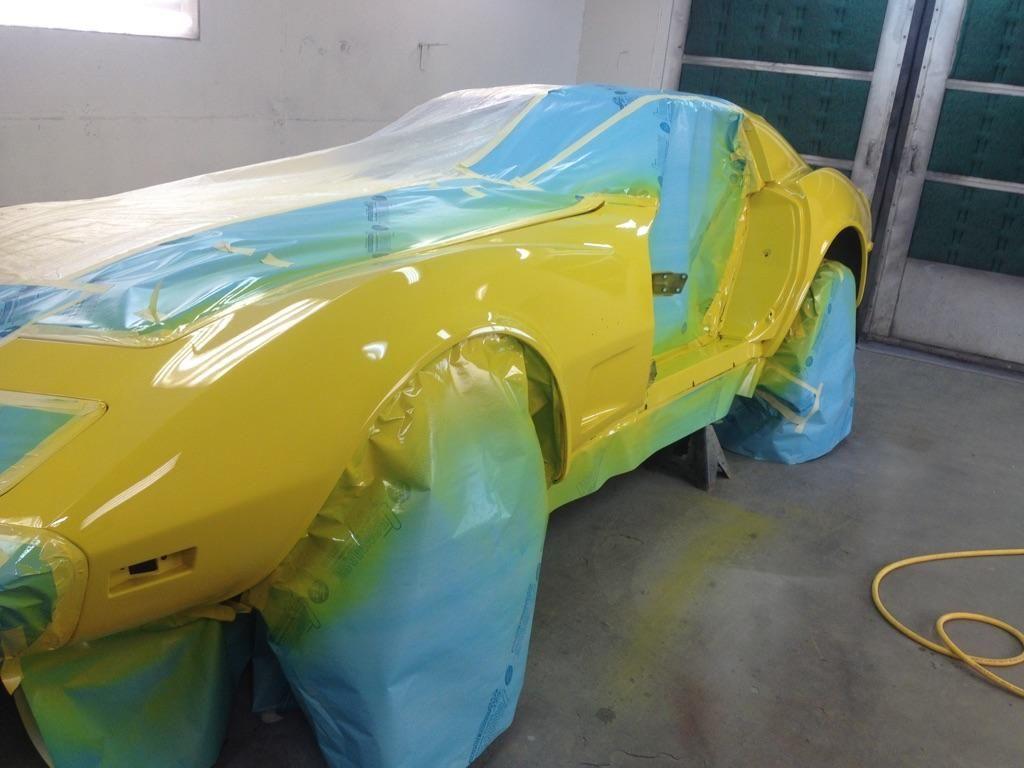

The body shop is pretty sure they can match the base coat. I had a sample made up at the local body shop supply store and it is pretty close. The body shop says the clear is where the issue will be. They need to blend the clear out and need to find an end point. With the front and rear sections of the body being one piece it will be interesting.

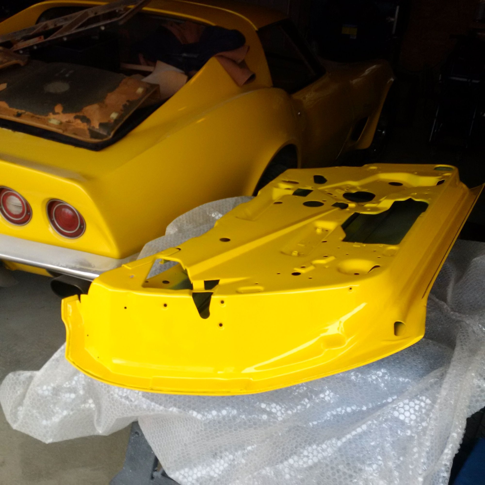

So the inner door was stripped to bare metal and painted. It is a pretty close match. I will install the door and then send it back to the shop to do the outer skin and blend the clear. I am having issues installing the weatherstrip though. Brand new, wiped the strip and the door with acetone, applied the permatex to both the door and the strip, left to tack up and installed. It has already pulled off the tight corner by the upper hinge and it seems I can literally peel it right off. Any suggestions?

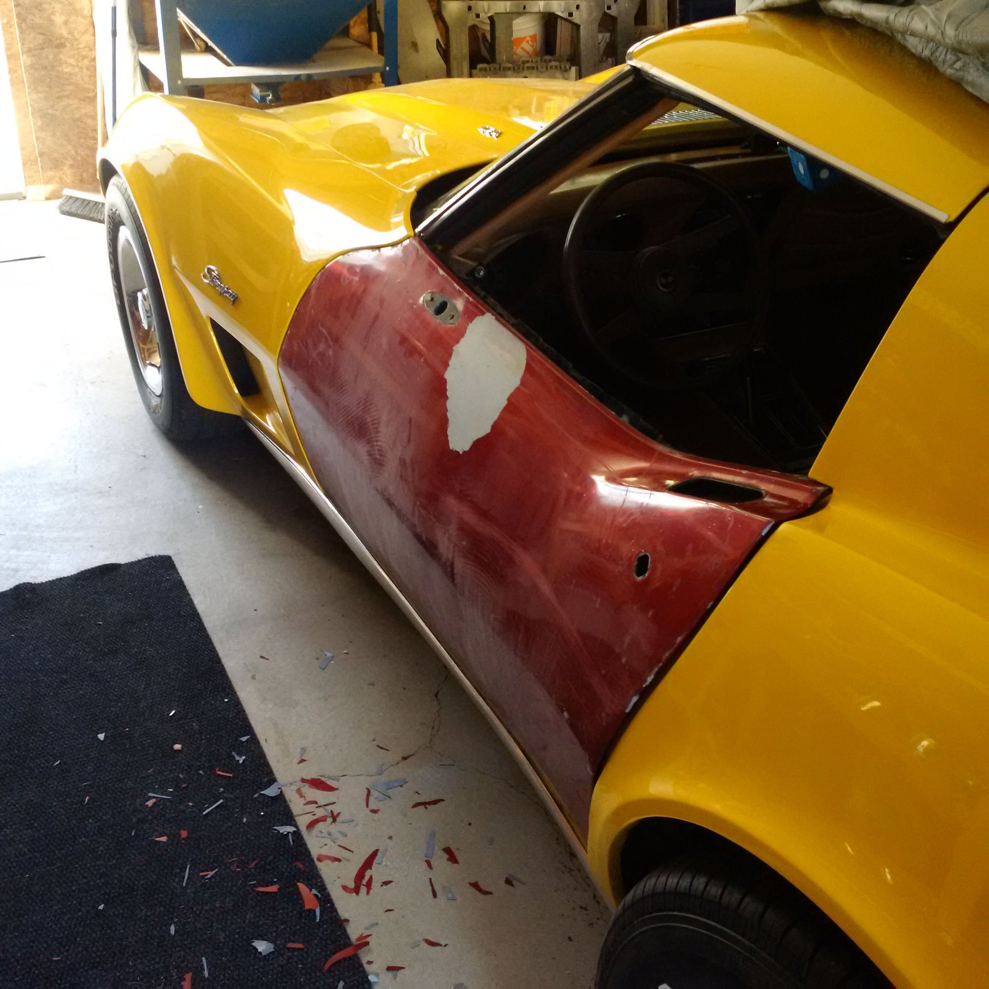

The 3M worked well. outer door is stripped and the door is on the car. Anyone know how to access the upper hinge bolts? I need to add a shim.

Paint blended
Turned out well
