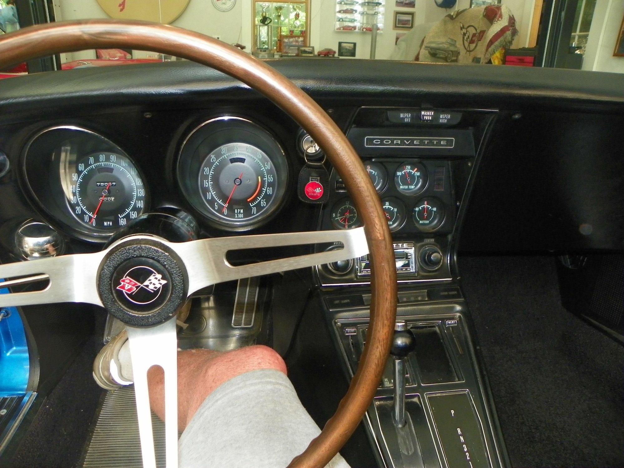

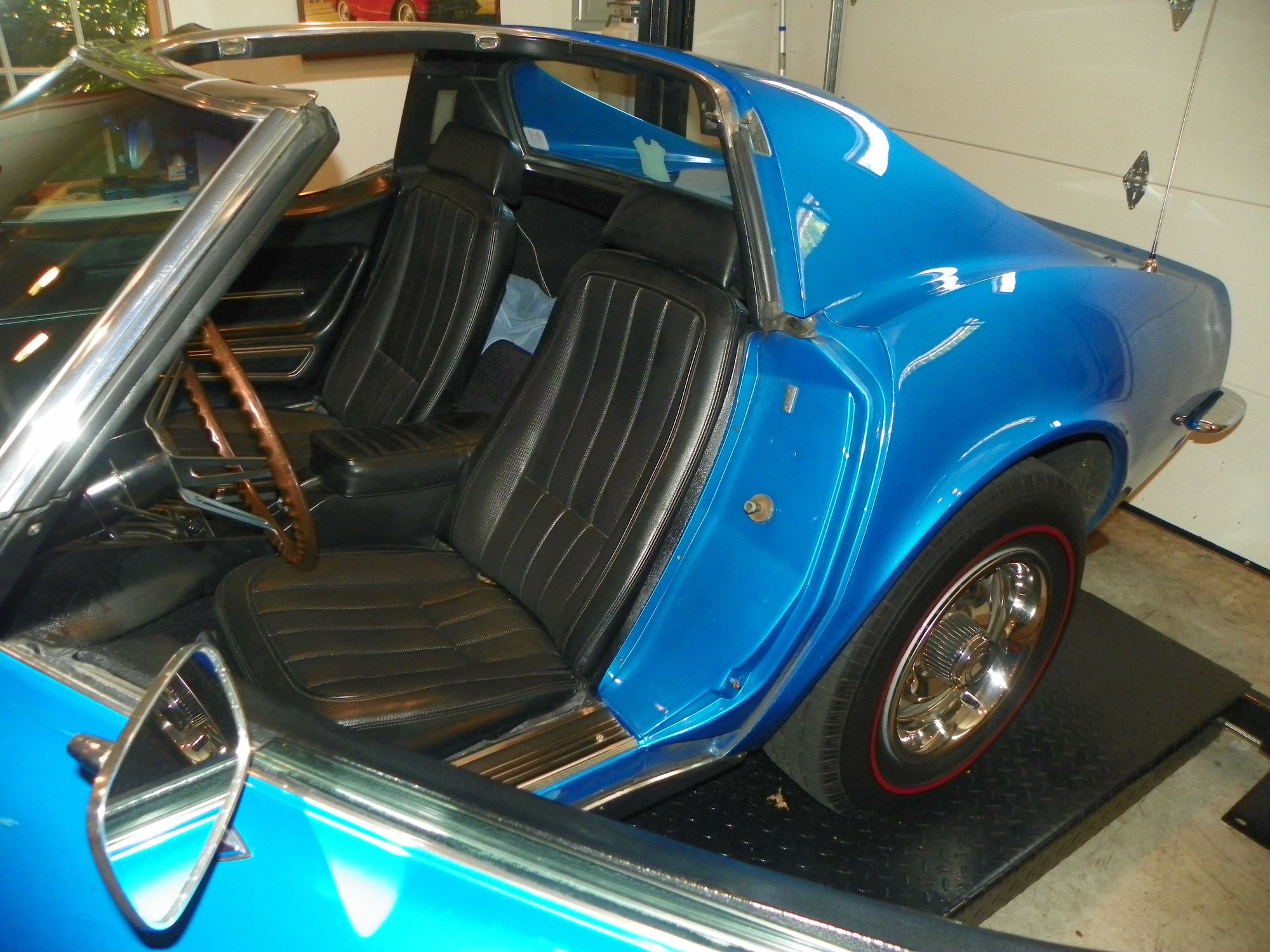

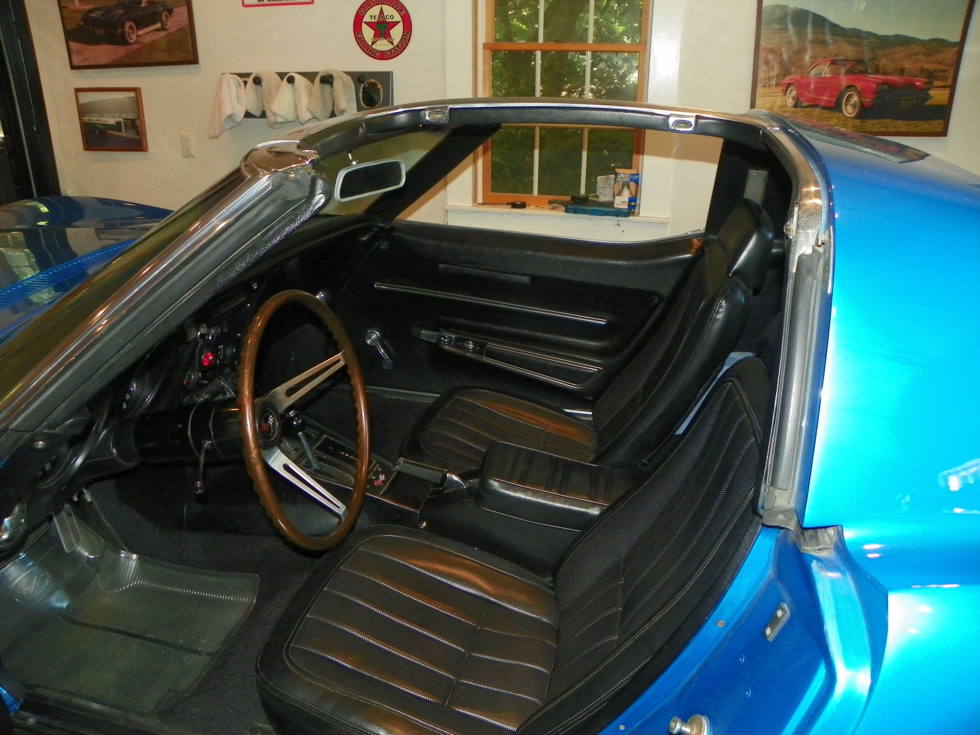

Rich, Everything's been pretty well covered. Mine is a pretty original 68. A picture is worth a thousand words. Headrest seats were optional in 68, standard in 69. My interior is original. They are great cars. Love the ignition on the dash and no column lock. Early cars, like mine had recessed door pulls. Later cars had regular door pulls. I had a 69 but preferred the 68. My radio was changed. If you throw up some pics, maybe we can assess the car for you. Good luck.
