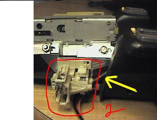

here is what I have, the third pic is an older column with the two screws, am I to understand the ignition switch shares the bolt/stud you mentioned with the hi/low beam switch? I don`t see any other holes in my column to mount the hi/low switch though

This is a newer car, but it is pretty much the same. Ignition at the top, then dimmer, and you see the stud Dub is talking about on the left. Yellow arrow points at dimmer rod.
