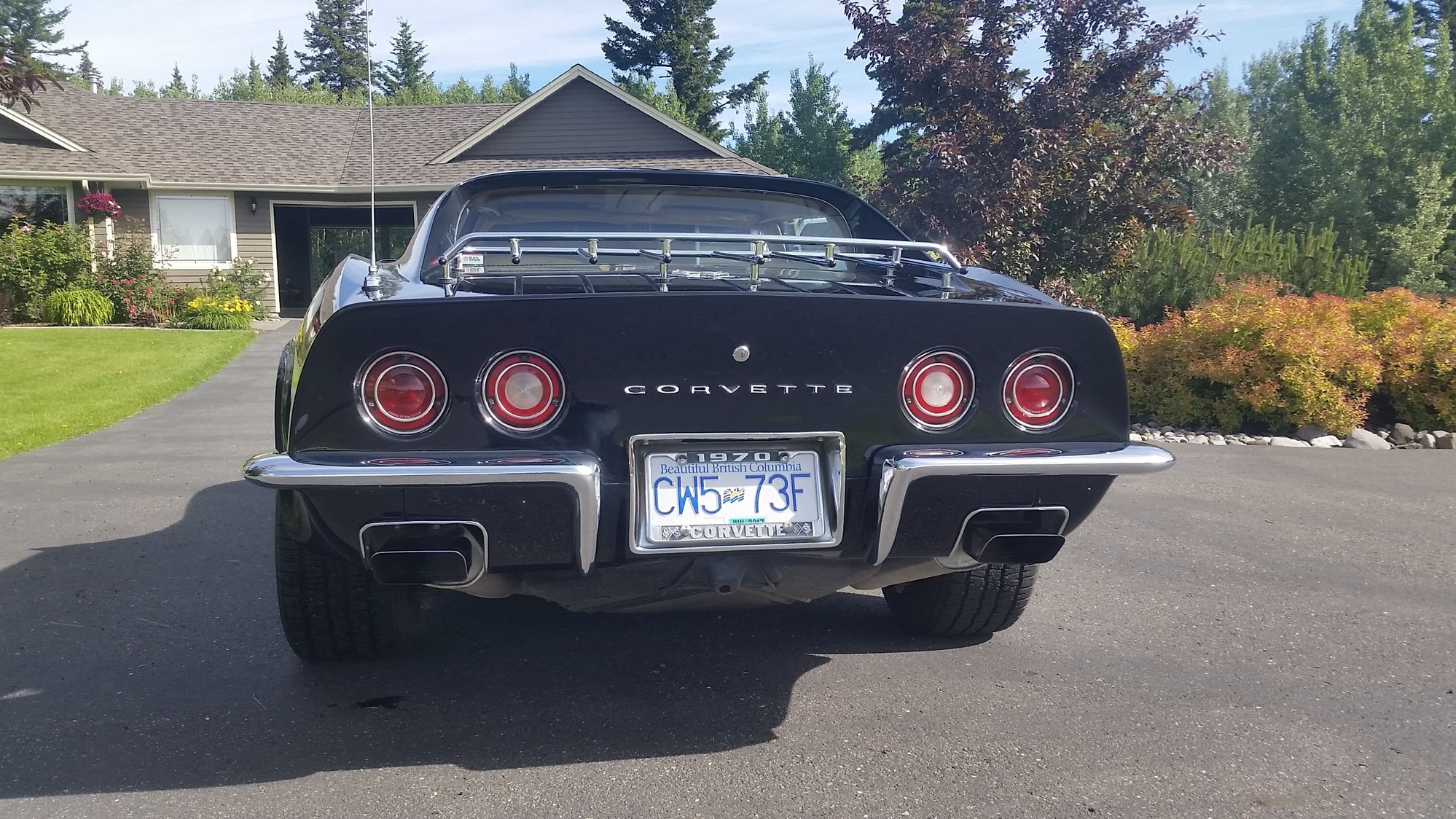

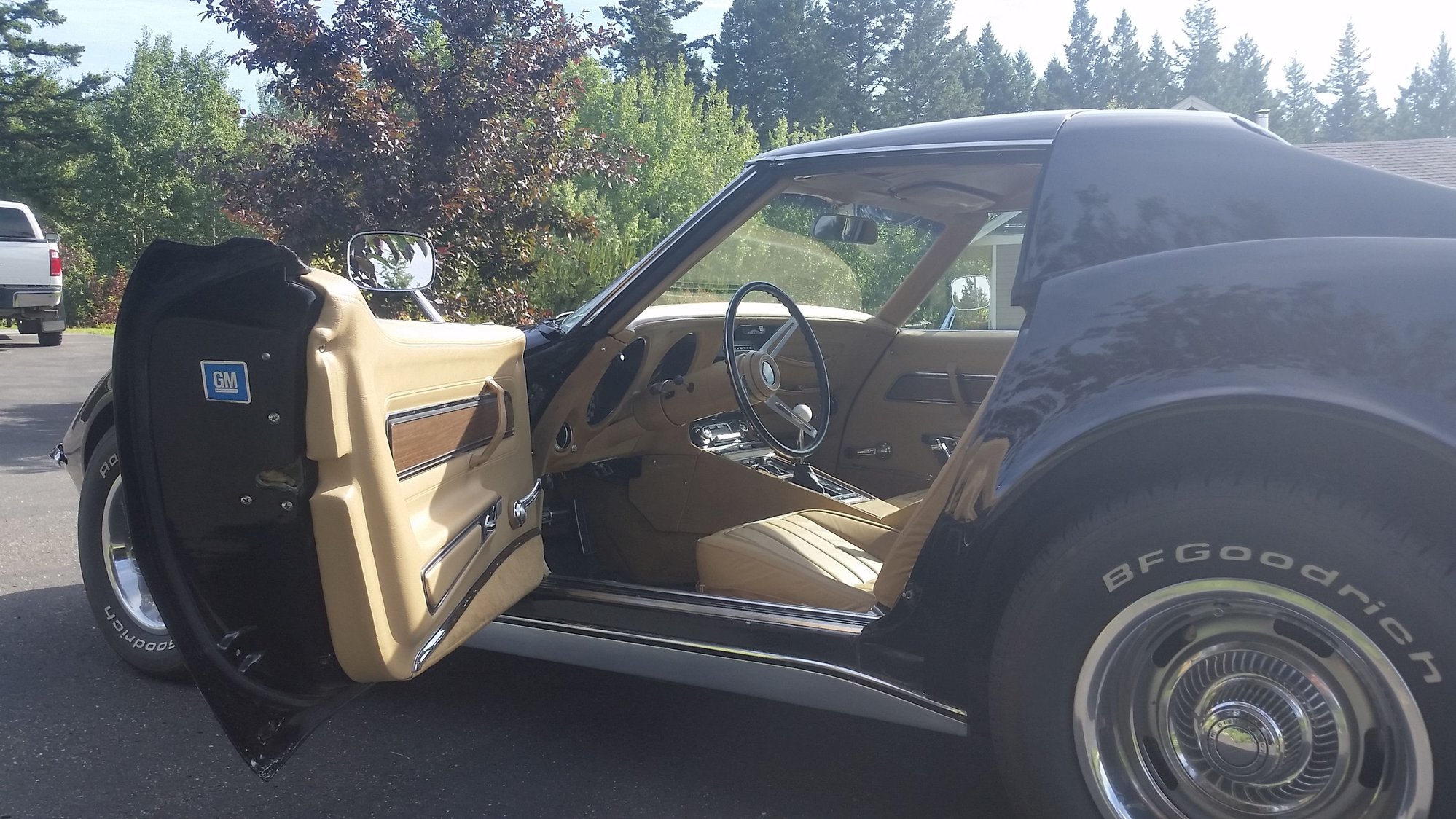

Hi guys, New owner from BC Canada.
1970 LS5 4 speed car. Low option (except deluxe interior). Special 3.70 rear axle ratio. Looks like 139000 miles. Canadian import from new. The car is in very good condition in my opinion. Previous Owner claims a restored in 1986 by another previous owner.
Drive train (eng trans and diff)numbers are matching. However the trans was on its way out. I elected to install a TKO600 overdrive. I bought the car to use and drive on sunny days in the summer and fall. I have saved the original trans and will rebuild at my leisure.
I have a question regarding long term value and numbers matching. I notice from my build sheet that a few items of this car have been upgraded. Number one is the paint colour(was red originally). 2 is added power steering. 3 is changed steering column to tilt / tele. Not to mention my 5 speed upgrade. So in the long run will these detract from the value of the car or not a big deal.
I plan on keeping and enjoying the car, just want to have the right plan in mind as time roles on.

The main thing is the engine which you have and you still have the original transmission so that would help mitigate any detraction due to your tranny swap.
The color change will put off some, but at least the original color is highly desirable should you or a future owner want to repaint back to stock.
If the other added components are correct for the year, but not original to that specific car, I don’t think it will have much impact.
Welcome and congratulations looks like a very nice ride!

I agree with TMU. The changes made, with the exception of paint are easily changed back if someone wanted to. The P/s and tilt/tell column are nice additions. Keeping the born with trans will allow someone to return to stock, if they desire, with very little expense.
Looks like a very nice car.

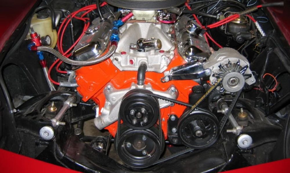

Welcome to the LS5 club.
Not my engine, but with power steering and no AC, your belt routing should look like this:

The belt diagram is in the assembly manual.. as a new LS5 owner the assembly manual and the wiring diagram should be your 1st purchase!
notice there is no way to tighten the crankshaft pulley to water pump pulley belt.
there has always been lots of head scratching on that one.

That's most likely what happened. It's an easy fix if you want to duplicate the factory configuration. I can't see your alternator pulley in the photo. Be aware there the LS5 had a different pulley for the alternator. Most vendors sell reproductions.

Was that belt installed on non AC cars? There's an idler pulley available to tension that belt, think it's part of the AC option.

Thanks for the heads up on the alternator pulley. It looks to me like the alternator is mounted with the wrong bracket. I will have to investigate the correct parts. I will also look for the assembly manual. I really want to get rid of the chrome one and go back to stock.

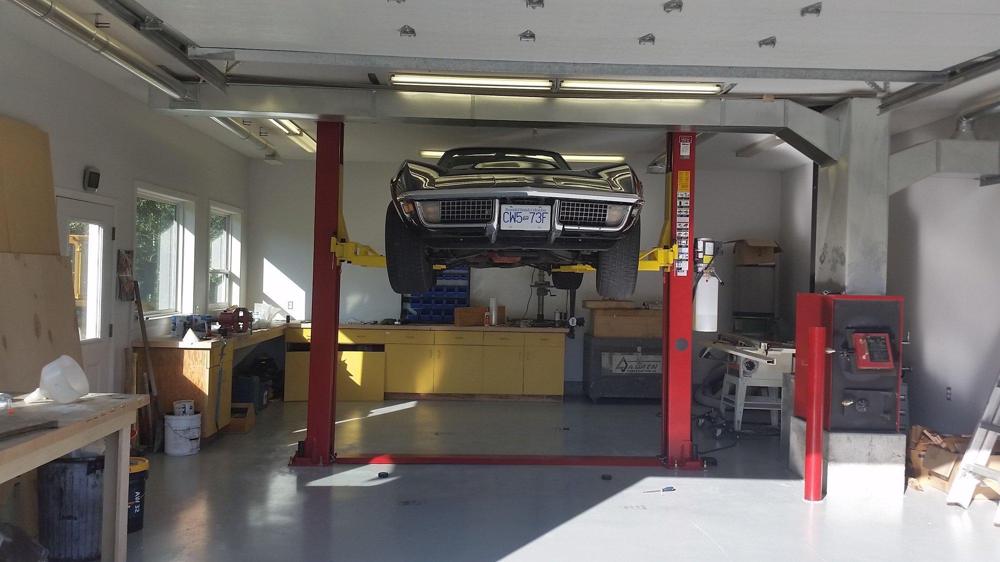

It is a fun hobby for sure. I didnt ever think that I would enjoy it this much.
Lol I even treated myself to a new shop toy!

Looking at the backside, it looks like you have the right brackets. I can't see the front. As someone else suggested, an AIM would be very helpful, showing you exactly how it was configured complete with part numbers. I mentioned the pulley because I had the wrong one for years, the stock belt seemed a bit long, adjustment was near the end of travel. The correct pulley is a bit larger diameter than the one I had before.
