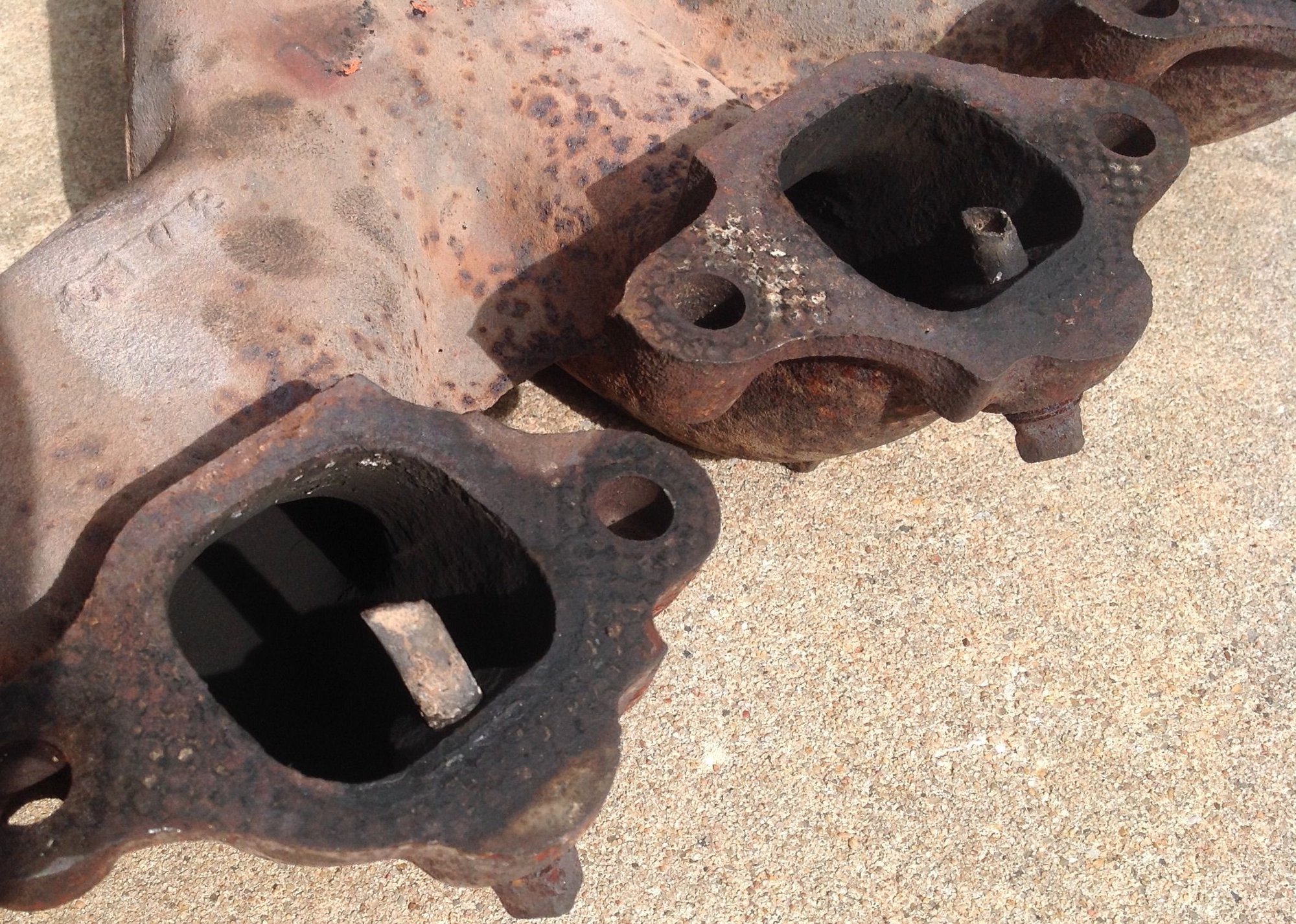

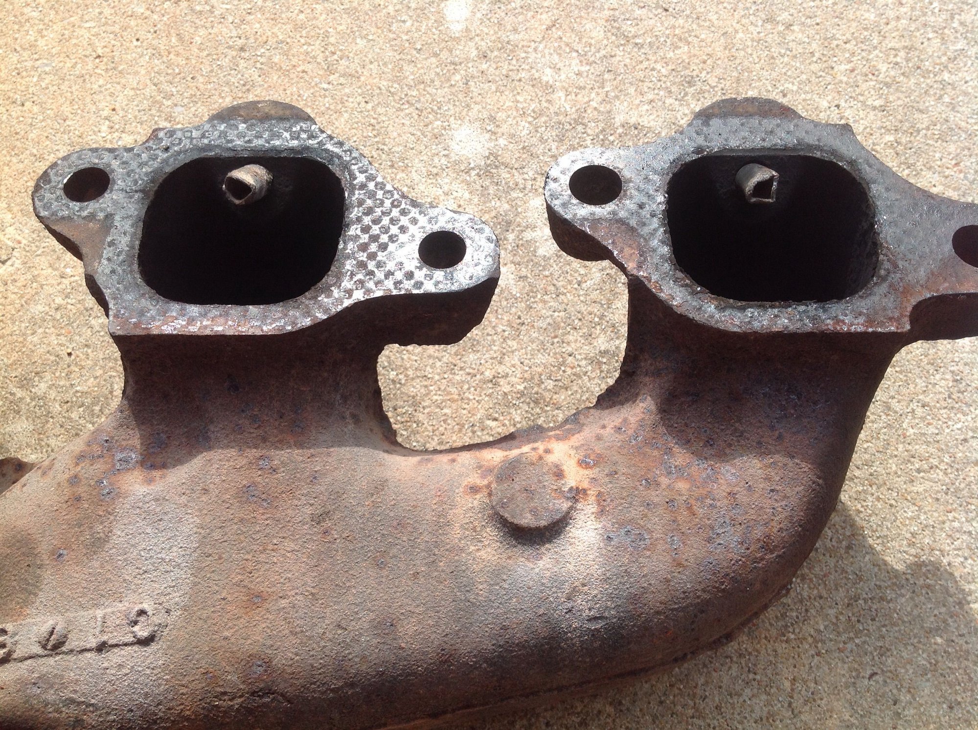

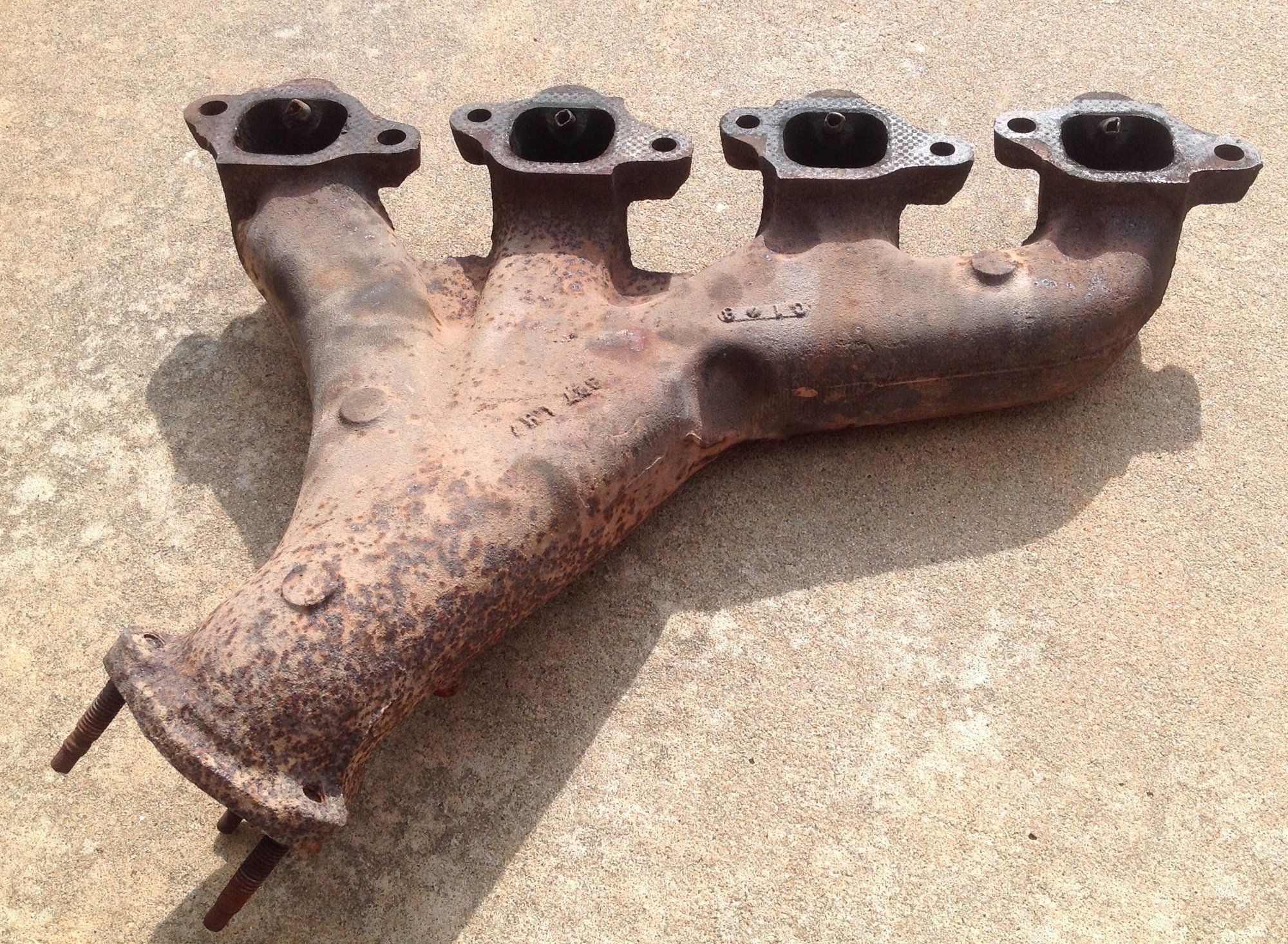

Lots of choices here. Plan to sand blast them later this week. I called around about ceramic coating and they want $175 to $300! Have heard good reviews on VHT as well as the BBQ paint. Please offer your opinion. Ceramic coating is not in the budget at this time. Also, how do I remove the remaining bolts that appear "distorted"?

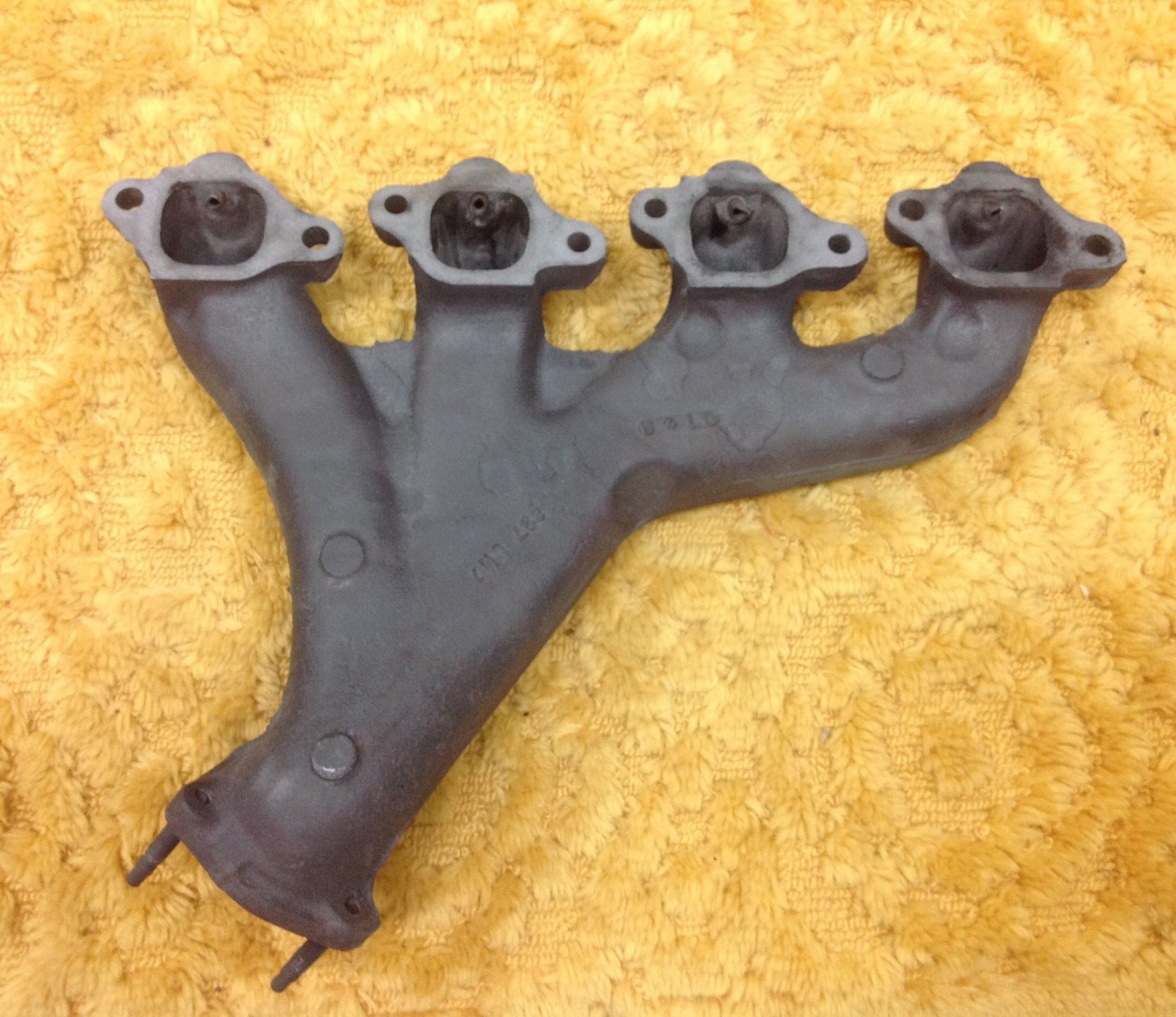

Below is my original 69 manifold in VHT Silica Ceramic. It was done just over 2 years ago and the pic was taken this morning. No cracks, chipping, peeling or any other problems and no primer was used.
That looks good
