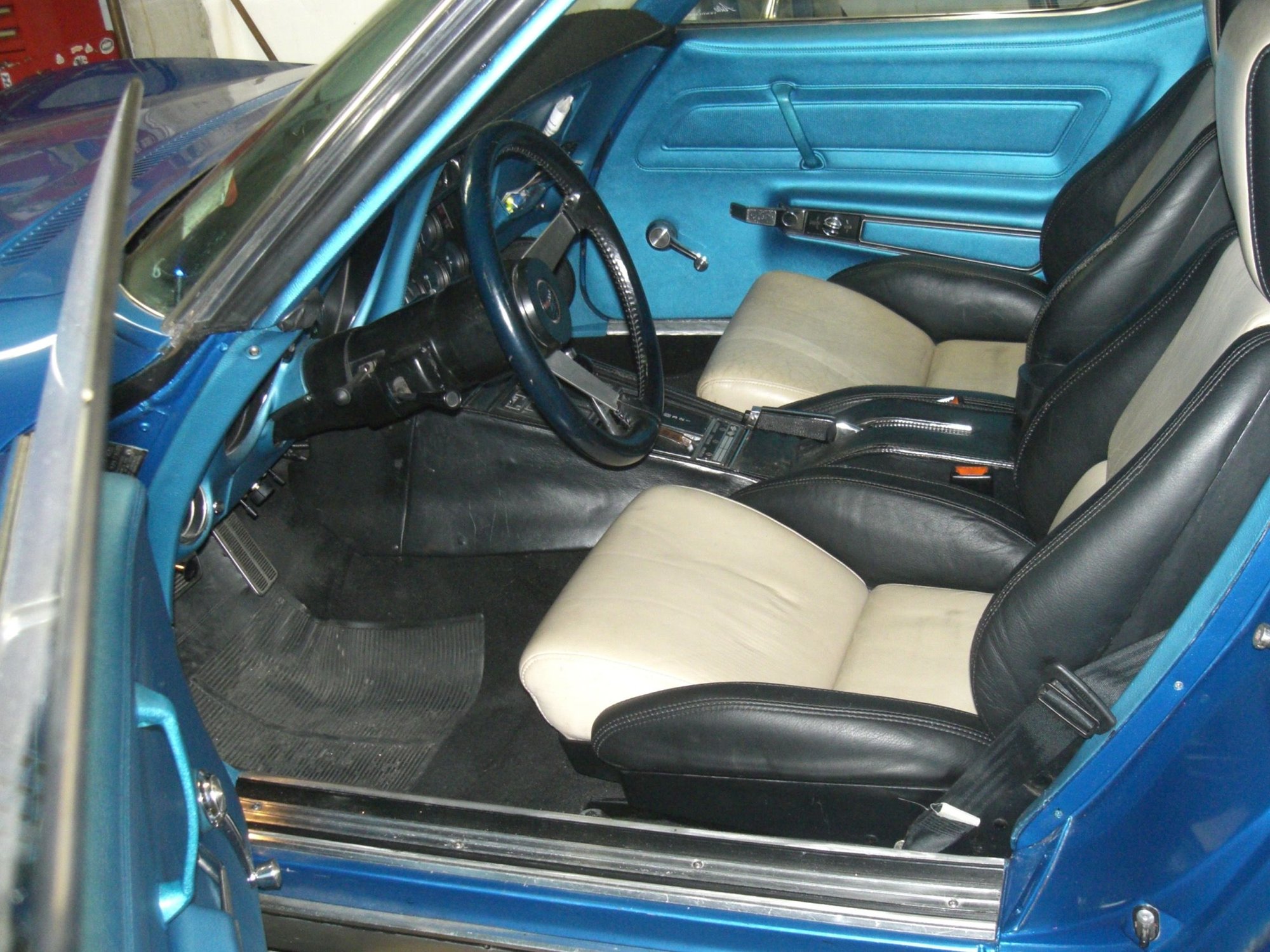

I recently fitted C4 seats to my '70 You use the original tracks from the C3 seats and have to make adapter plates for the rear mounting holes of the C4 seats to the C3 tracks.
Pics is after fitting seats but before I had them recoloured.
