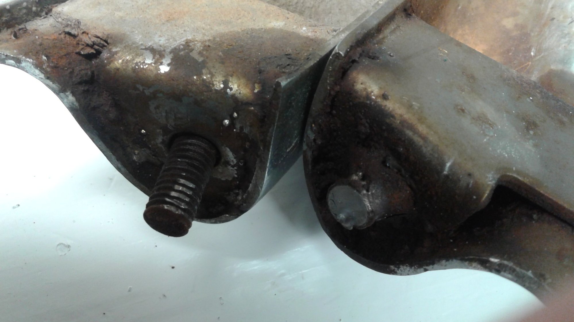

My guard tops have holes to thread a bolt into. like what I expected for all 4 from what I've never seen and heard .
MY bottoms on both have a thread coming out of the guard that you put a nut on.
Now the drivers idea one looks legit but the passenger side one that broke looks like maybe it was spot welded in.
When I shake the passenger side one, I can hear a rattle inside that may have been the welded nut head inside of the guard which I think you guys mentioned.
Should there be a Gm parts number on these? they are pretty dirty and old but the numbers are not jumping out at me. it makes me wonder if these had broke on the bottom before and had been fixed or they are old replacements .
here is a picture of bottom part of guards.
jim

Hi x,
What you describe and show certainly appears to be a repair due to rusty bolts.
I really believe the nuts for those bolts were welded into the guards before they were plated.
I'd think getting the threaded parts of the nuts plated would be pretty difficult which would lead to the real possibility of rust.
Regards,
Alan

Looks like it's aftermarket replacements for me. at least I can feel better about it now. these aren't worth replating.
