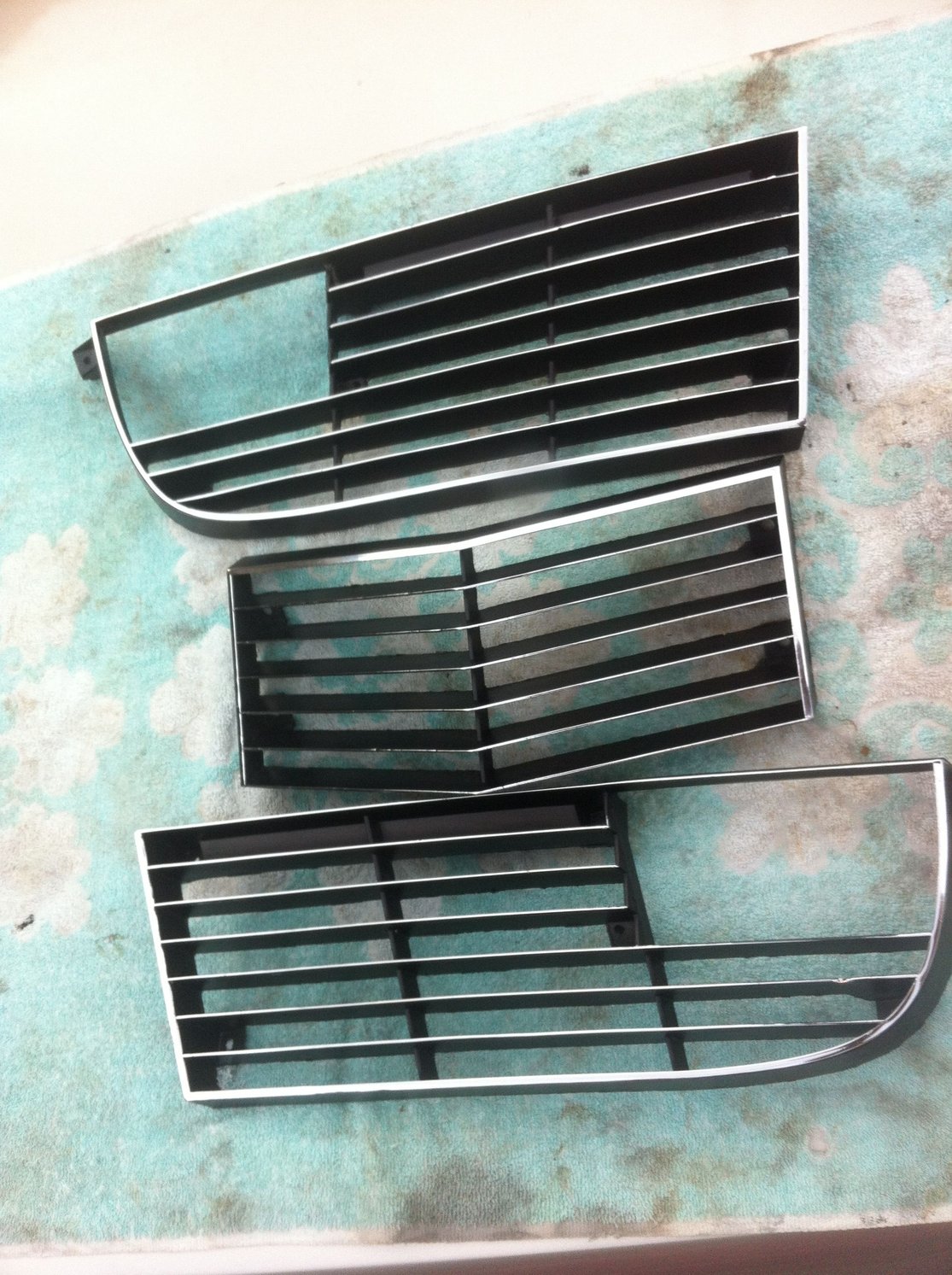

Semi-flat black bars with bright front edges.
The front edges were chrome plated. Use wet, fine grit sand paper (400) to sand the black paint off the edges to revel the chrome. If you are not too picky, you can use chrome paint to touch up bad spots after the grilles are painted black.

Picture is worth a thousand words. Tomorrow I'll seek chrome under black.

Here's a pic of an 1973 OEM grille set
