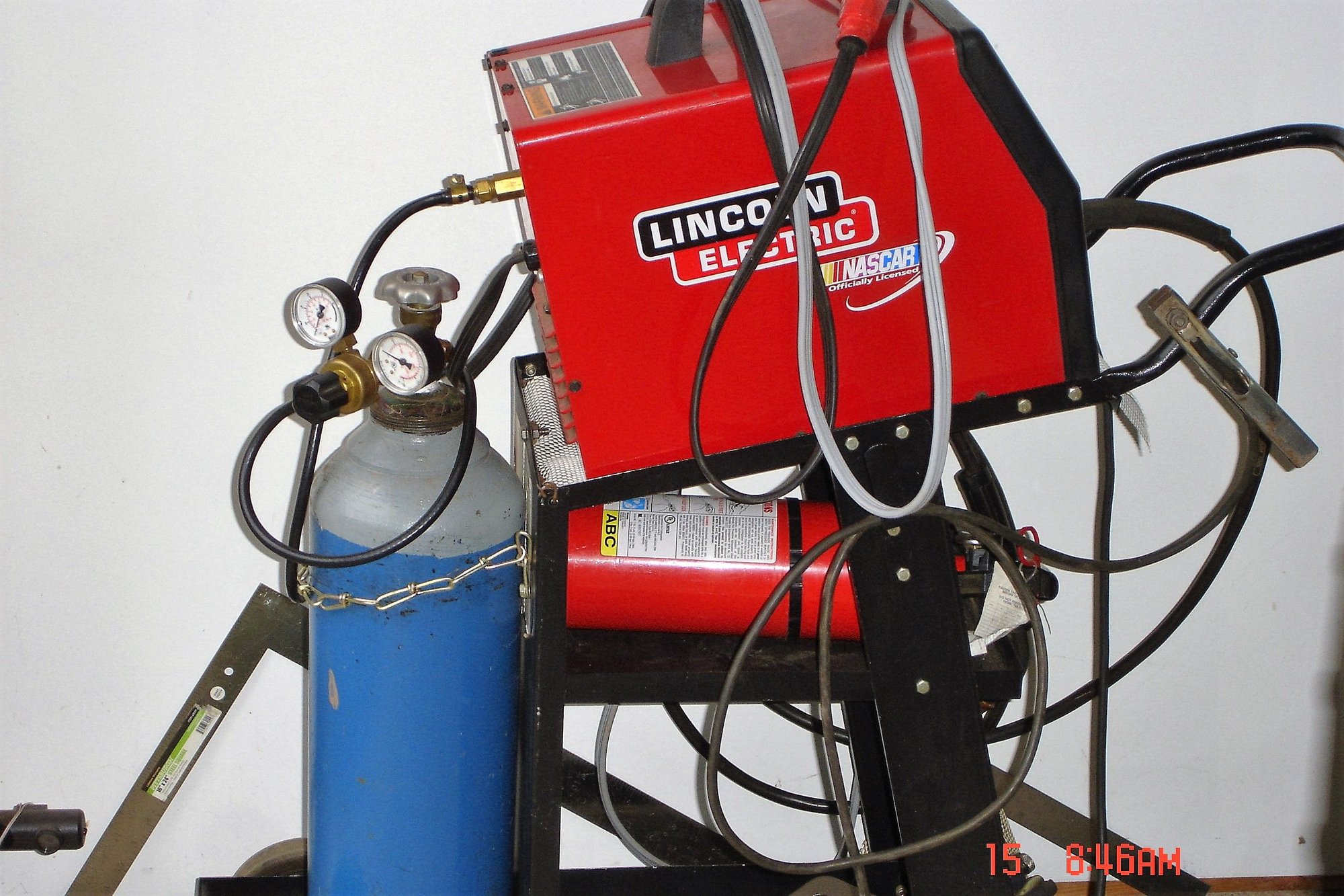

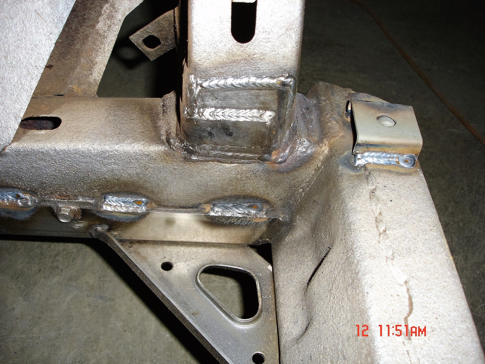

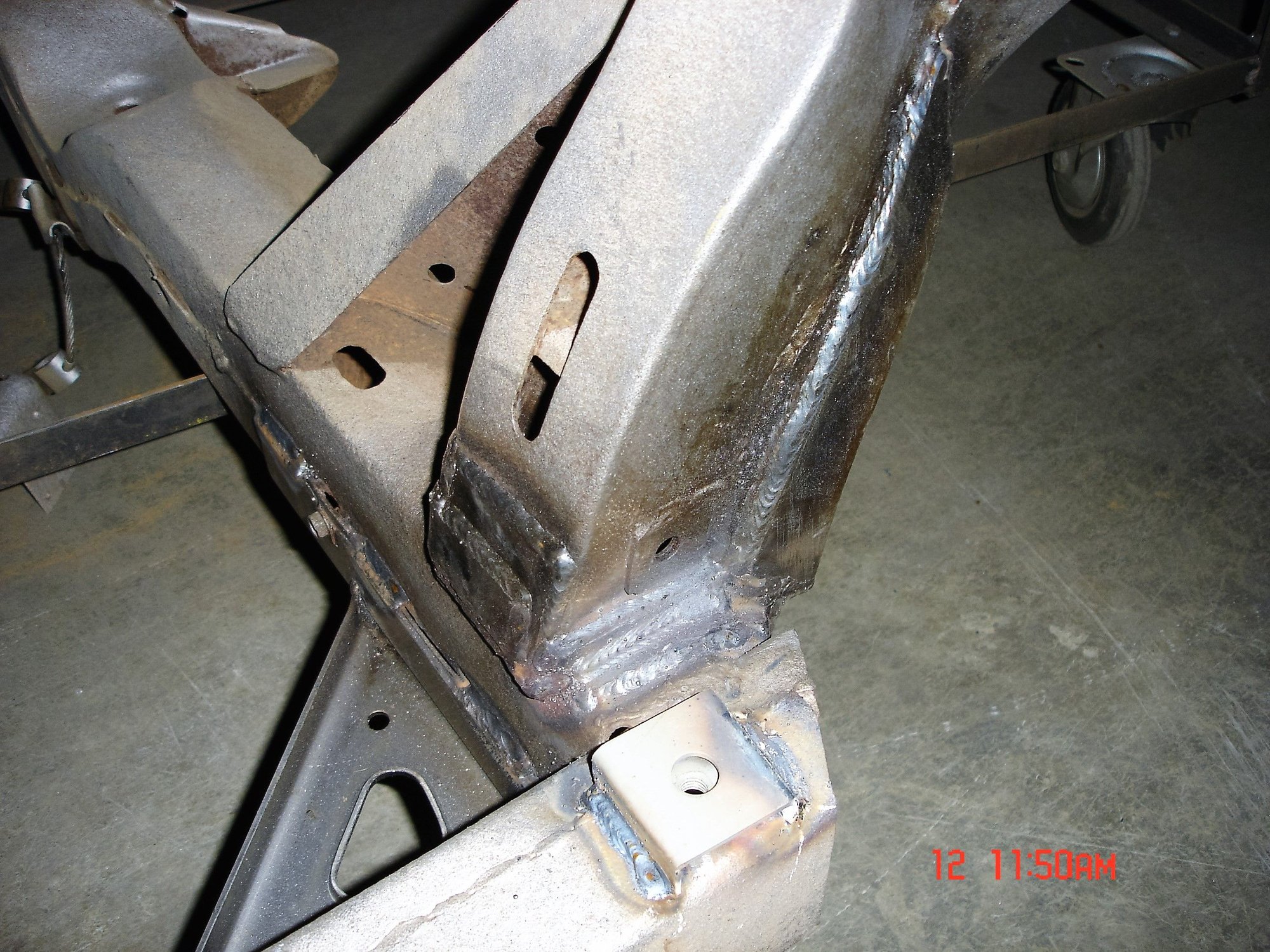

This was the setup I used to make the needed repairs to my frame.
Worked out pretty good.

Hey RVZIO, I have the same welder and the only way I can get welds to look that good is to have someone else do the welding. T
That's funny Terry68. Practice, and patience. I find that sometimes I get excited to do things and that's when I screw up. Hard for me to keep my emotions under control. Slow down and you can do it!
Thanks you for the comments!
RVZIO
RVZIO
Those are nice looking welds. I also have that welder, no argon gas though.
No reason to take a grinder to that to make it look good, unlike many of mine.
One of the secrets of a nice weld like that is not only experience although it helps , is a good clean welding surface like you saw on RVZIO's frame and the right mixture of argon/amps . Keep practicing .
