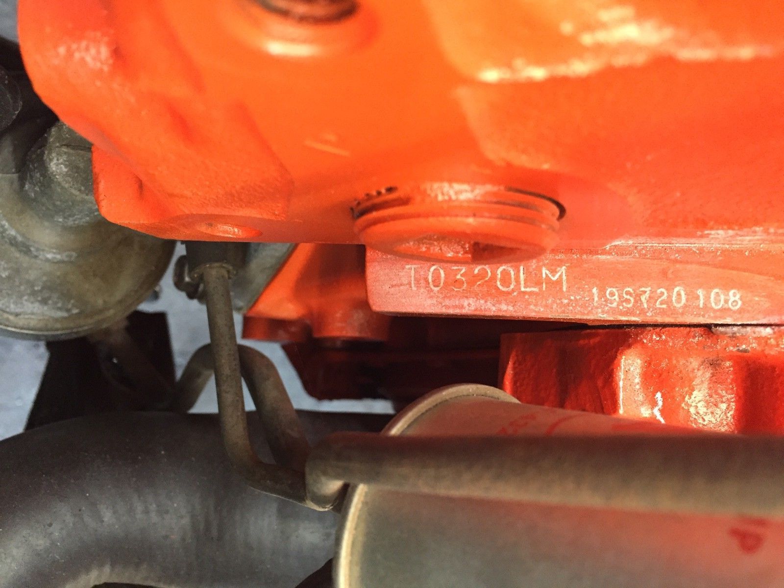

Hello, I am starting the restore process of my vette that i purchased. The vette is suppose to be a number matching 427 390hp. I started going though it and the engine stamp just seems off to me. Is this how they normally look? I looked at other threads that were similar.
Thank you

Other than being painted, looks good to me. If you decide to remove the paint, just be careful what you use and DO NOT scratch the surface of the stamp pad. Your motor was built 5 days before mine.

K Thank you just they way the 0108 looked seemed a little funny.

What is it about the stamp that seems "off" to you?
It's really difficult to form an opinion about a stamp pad when there's paint on the pad.
You should probably remove the paint using a non abrasive method. You just want to remove the paint…. you don't want to change anything about the stamp or the pad's surface.
You might for instance use some lacquer thinner on a rag or a paint remover with no abrasive in it.
Don't use any kind of sand paper or wire brush on it.
Then post some more photos and you'll get all the opinions you'll be able to stand!
Regards,
Alan
As FR mentioned the SAME stamp is used at the SAME time to stamp the transmission case. Look for it on the side of the rear case.
Is this 'swoop in the paint or in the surface of the pad?

Post a picture of the stamp on the tranny case. Look for the same number "0" raised above the line of the other characters.

You need to clean ALL the paint off the engine pad as others have stated, again without anything abrasive. I too would like a pic of the trans Vin derivative. Also post another pic of the pillar vin plate after removing the pillar molding. Ithe looks to be painted over and I cannot see the original rivets, seems strange.

Maybe it is just me but it looks like after someone painted the pad (it was not this way from the factory) they went over the numbers with a white paint? Maybe wiped it on so you could read the numbers and make them stand out? If that is the case maybe that is why the numbers look a little smeared. Again, maybe it is just me.
I can tell you (in my opinion) the placement of the engine build date and suffix indicate it was stamped with head off, which is how big blocks were originally, so that is good.
Was the engine rebuilt at one time?
I totally agree with everyone here. CAREFULLY remove all the paint from the pad with a non-abrasive. After that, post up some clear pictures.

The stamp looks pretty good as far as the characters and fonts go.
Wipe the pad carefully, gentley with lacquer thinner and a soft cloth. Do not scratch it up as the broach marks are an important part of the pad and can be used to indentify an original pad. There is a company that can indentify the pattern of the marks to a time frame from when the engine was originally decked. The company is CCAS. So, be gentle.

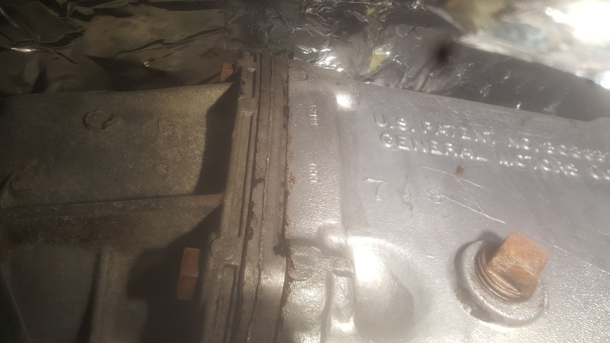

Hello,
I finally had a free moment to go to the shop to look at the tranny. Unfortunately and sadden to find out that it doesn't appear to be the original one for the car. I can make out cco and 38124 on it. Unless i am looking at the wrong spot . Any other place i should check? also i did check and see the rivets on the main vin. I will upload those pic monday.
I will also be removing the paint on the engine stamp pad. I did look it over and it actually seems to rises up to the stamp. I wondering if it was from when they painted it? Hopefully Monday i will have the paint removed carefully to see.
Also I did try to find out what the CC0 meant and it seems that it was a warranty replacement done on the transmission. I have read that the first letter C could stand for chevrolet or Counter and the second C meant case. The 3 number was for the year 70?

I believe that's the typical location for the transmission stamps.
There were typically 2 stamps:
The first identifies the transmission and when it was assembled.
The second identifies what car the transmission was first installed in.
I'm not familiar enough with transmissions to even guess what the stamps on your transmission might indicate.
Hopefully someone else will!
Regards,
Alan
Engines replaced under warranty had different stamps than the engines used in production… perhaps the same is true for transmissions?
