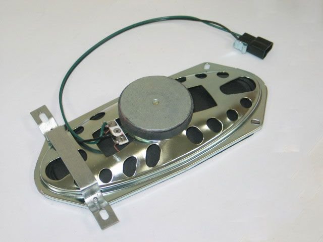

Stock replacement 68-69 speakers fit behind the kick panels.

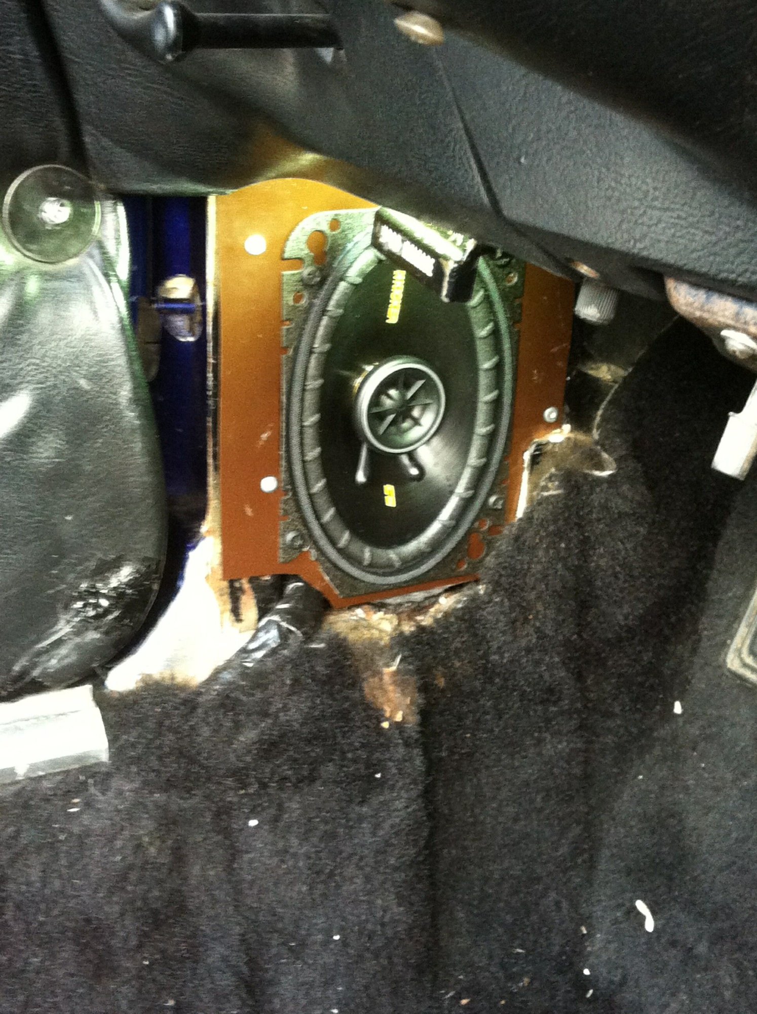

I put 4x6's in the dash and the kicks. Some people don't like the smaller kicks but I wanted it to look stock with the cover on it.
I grabbed some scrap metal I had lying around and cut out the hole for the speaker, then went into the car to make it fit. Once done, I grabbed some left over rust paint and coated all sides of the metal.
I ended up pop riveting the metal in to make it easier on myself.
I also put in some foam backing in case I had another leak down the bird cage.
