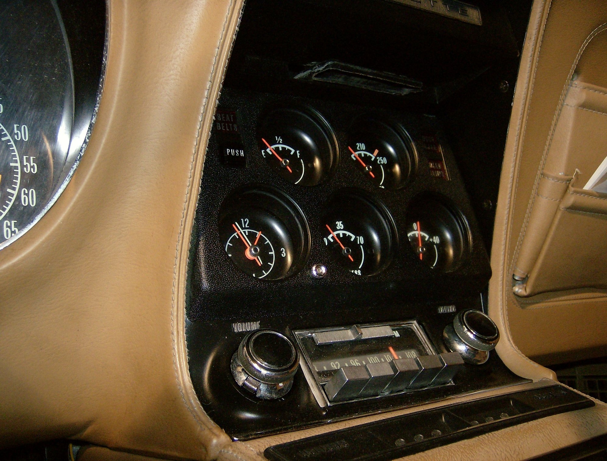

Hi spf,
I looked and don't see a 'generic' pad at the Willcox site.
I believe it can't be a 69 pad because the 69 pad doesn't have the stitching along the edge at the center gauge bezel.
I'm not sure what makes a 70 pad a one year only? Did it have the stitching or not? What you present pad look like?
I think the myriad of pads available is because of the numerous interior colors.
Regards,
Alan
The double row of stitching at the center gauge bezel.

70 lower dash panels are different in the way the mate to the shifter console. 70 has a longer point with no interlocking with the center console. This caused the points to flare out over time. 71 has a shorten tip that interlocks with the center console. i believe this was the correction to the 70's issue. You can see this difference from Alan's pic. Obviously the center console is also different Pic from my 70

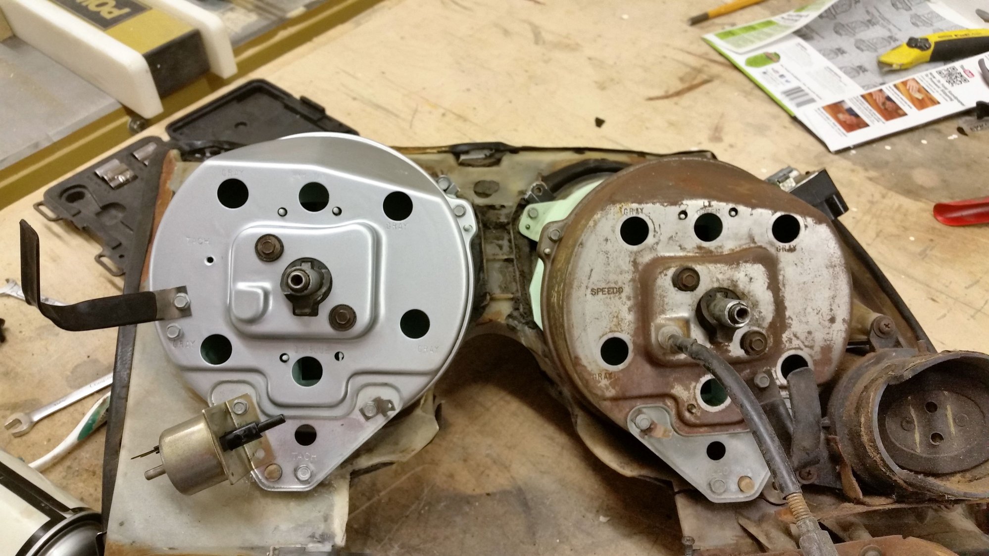

Hi spf,
Here's the tach mount on a 71 pad. I don't know if it shows enough?
The 70 is different?
Regards,
Alan
Here's the tiny 'tab' that was added to the shifter console. You can just see it extending out at the left side forward corner. It's
VERY tiny.

SB64's Avatar
SB64
Joined: Jun 2013
Posts: 4,399
Likes: 793
Default gauge
Here is the back of my 69, if it helps.
RVZIO
Before and after!
