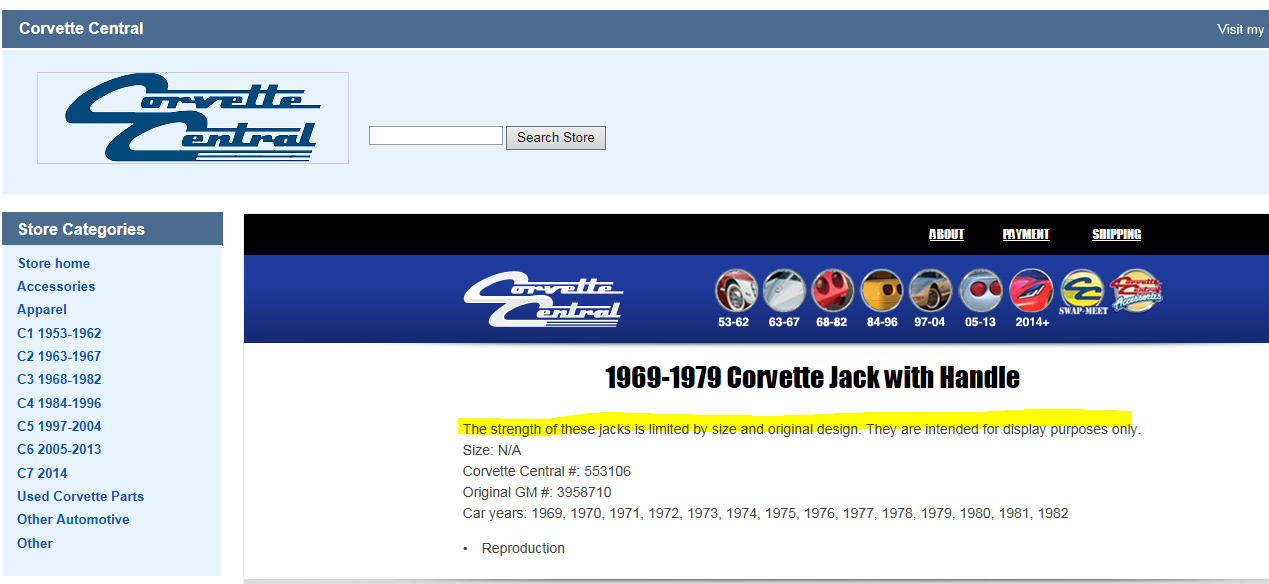

Old Feb 1, 2018 | 03:23 PM
kahibbi's Avatar
kahibbi
Joined: Oct 2003
Posts: 44
From: Little Elm TX
I had the same question about the 'reproduction' jack for my '58 working because it was contradictory on the Corvette Central site. It said "The strength of these jacks is limited by size and original design. They are intended for display purposes only."
I called to talk to them and I got to one of the parts experts. He said it worked as designed and intended ... to change spare tires.
I ordered one and I'll immediately test it to jack up a corner for wheel clearance (they're back-ordered until early March).

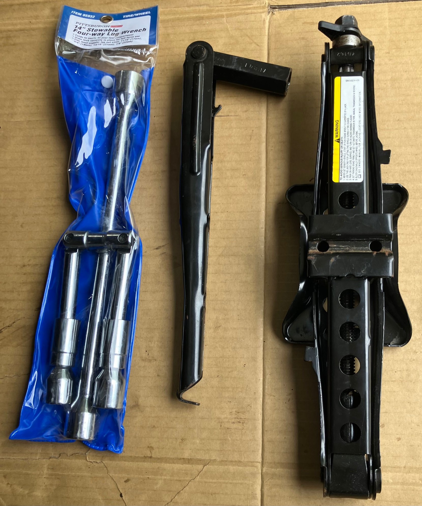

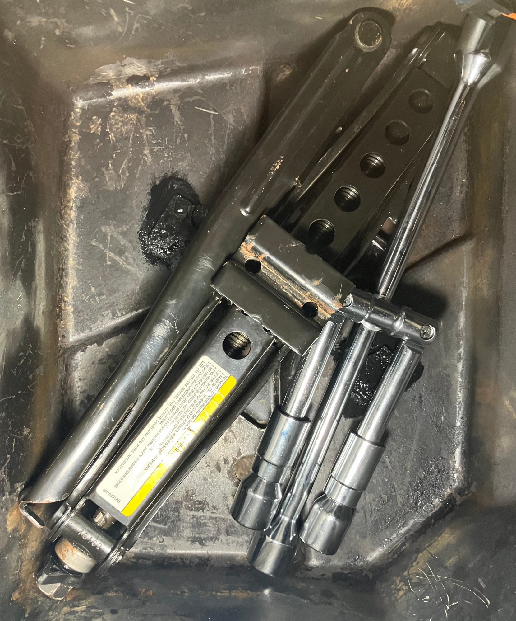

I picked up a scissors jack and handle from a 2008 Jeep Patriot, and a pair of wheel chocks from a 1999-2006 GM PU all for $10. Fits the Vette’s jack well perfectly. I also got a collapsible X-wrench from Harbor Freight for $16. I just need to fab some sort of hold-down using the jack well’s two hooks.
