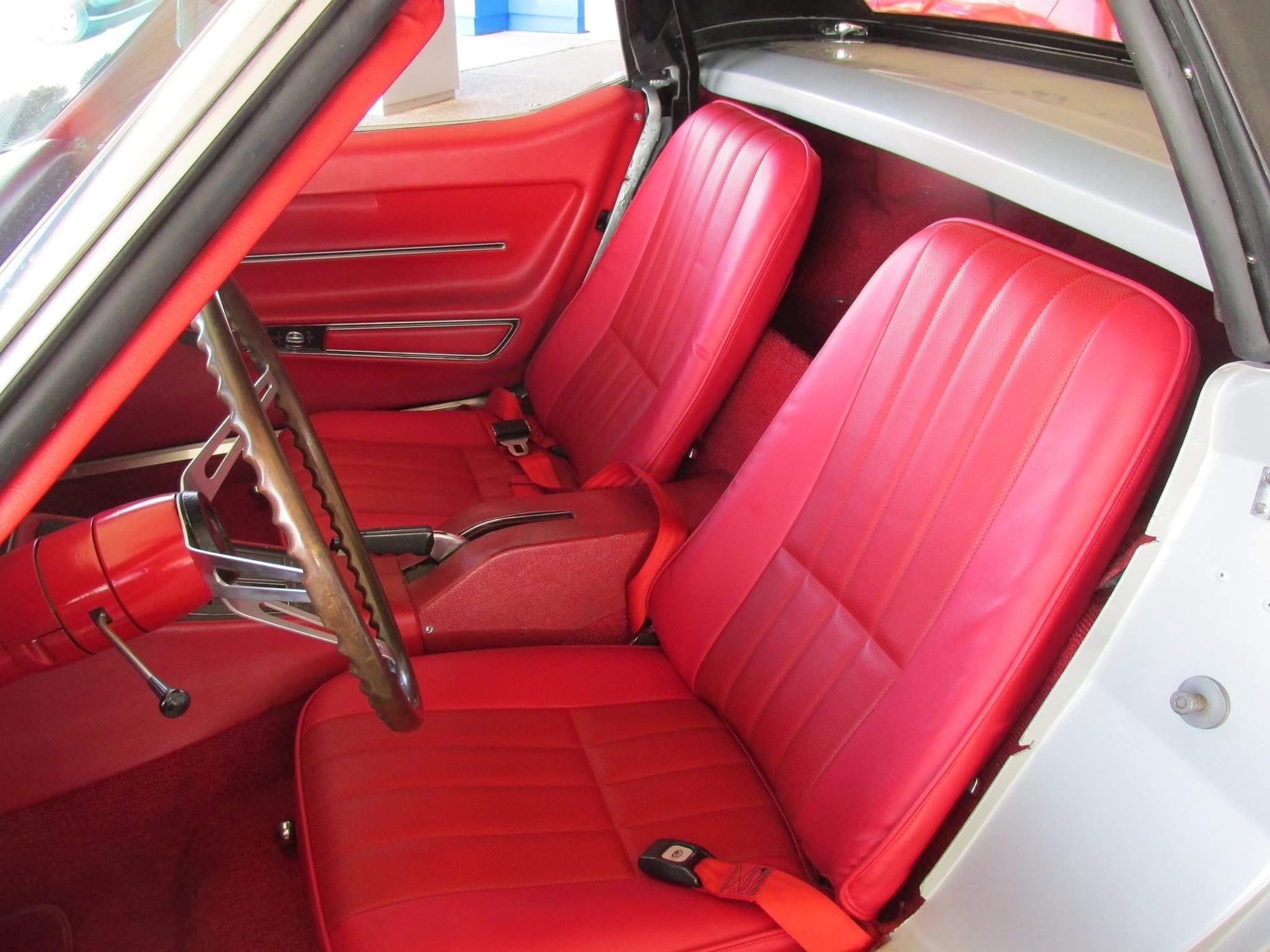

Hi C,
More interesting photos.
I'll make just one comment.
The seat covers are in the 68 Corvette style…. they're just sort of similar.
Regards,
Alan
The more photos you post the more I'd lower the car's value.

Also, isn't the parking brake console the incorrect '68 style. I would correct the drive belt configuration if it were mine. I don't like seeing one belt for the wp, ps, and alternator. Should be 3 belts, 1- crank to wp belt, 2- crank to wp to ps belt, and 3- ps to alt belt.

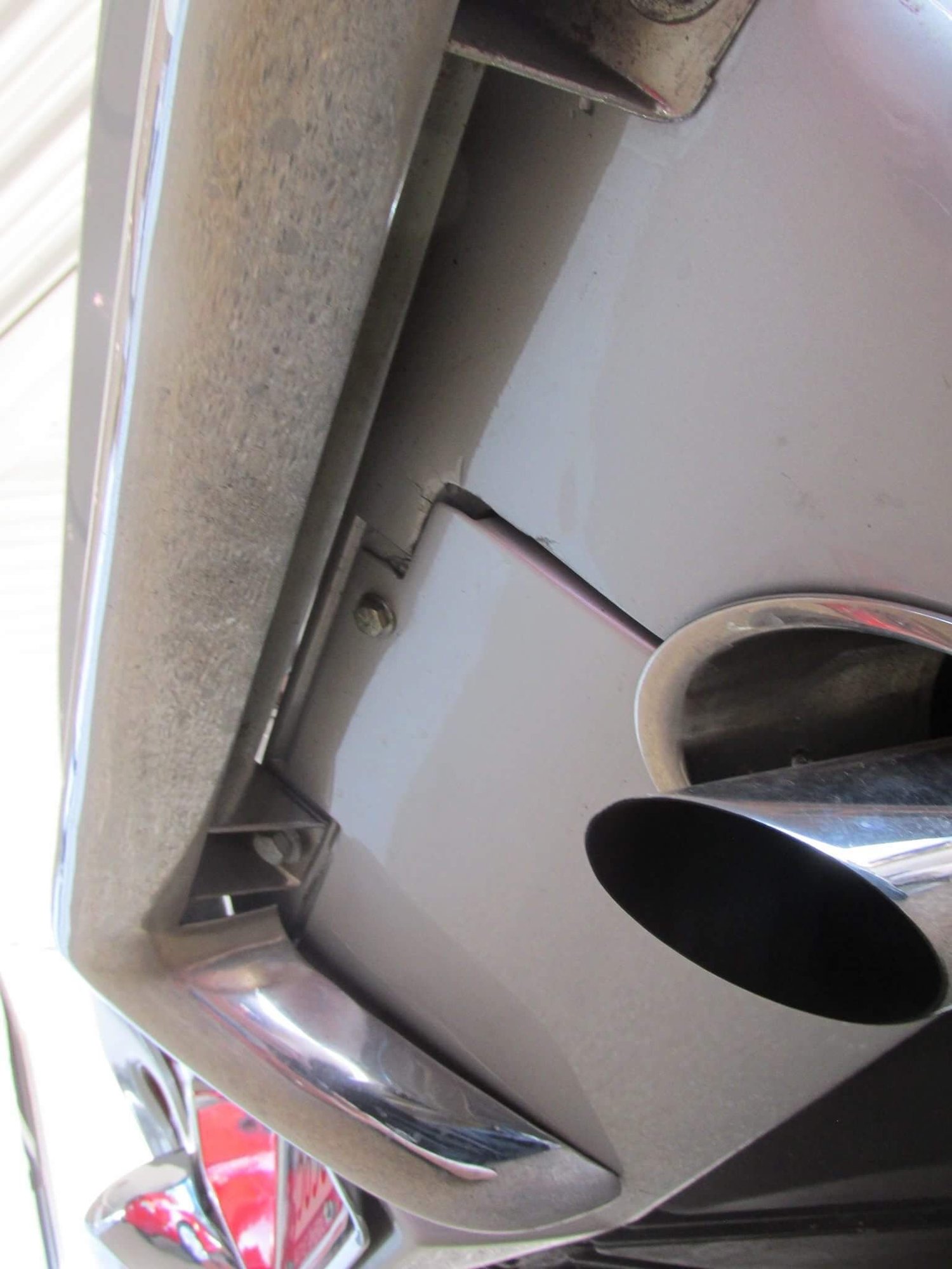

What happened to the backup lights? I don't see them in the lower valance. Could it be that the rear clip isn't from a 68? Seems as though the asking price should be even lower.
This seems to me to be the biggest catch yet - the car does not have any backup lights at all.
I'd run for the hills on this one unless it was cheap (and it isn't).

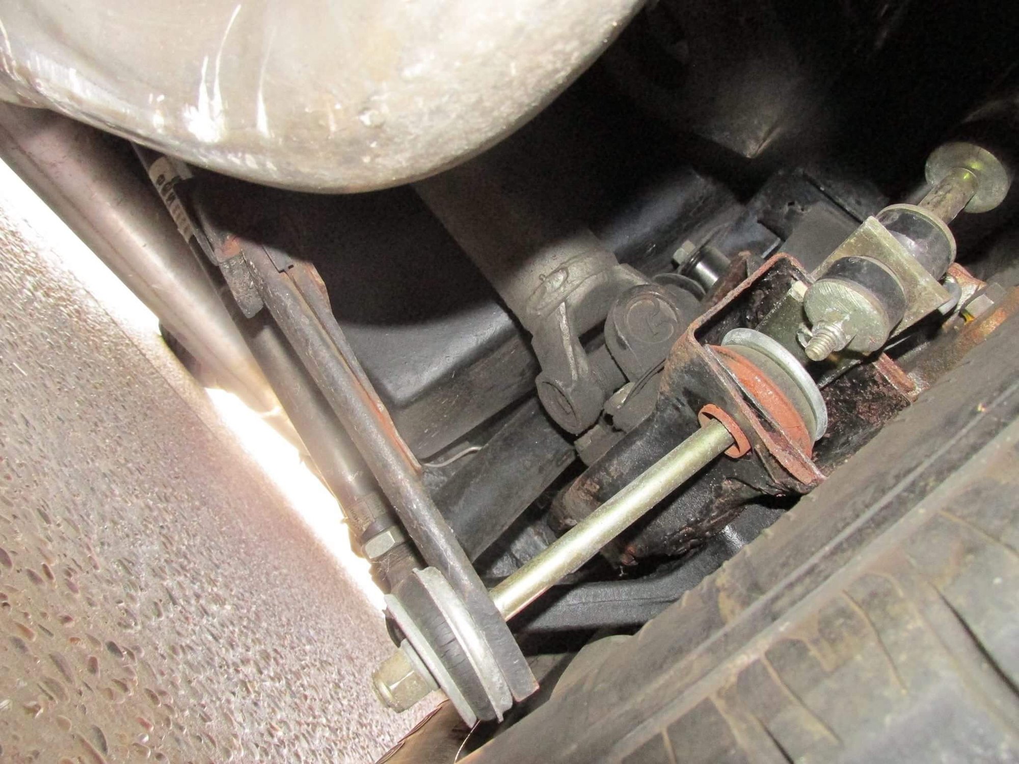

Non stock rear sway bar. I bet it's a Small block car.

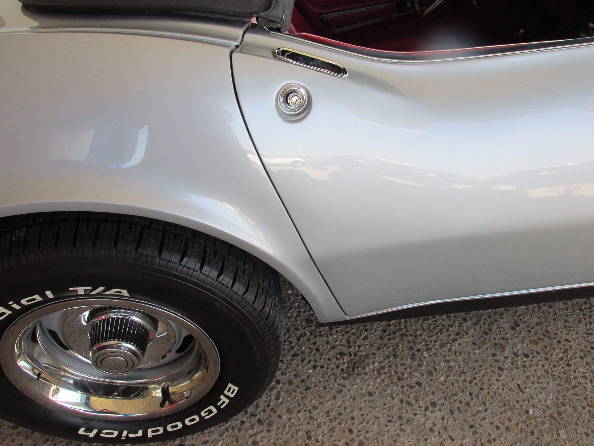

Mirrors are wrong for a 68. It looks like a nice car just don't spend matching numbers money for it.

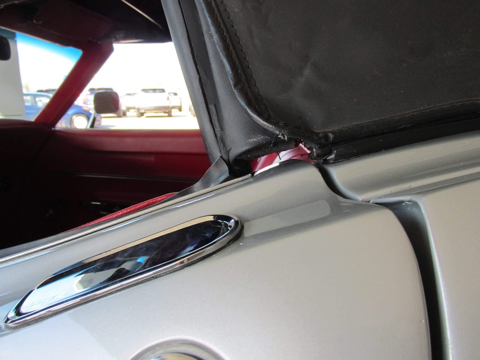

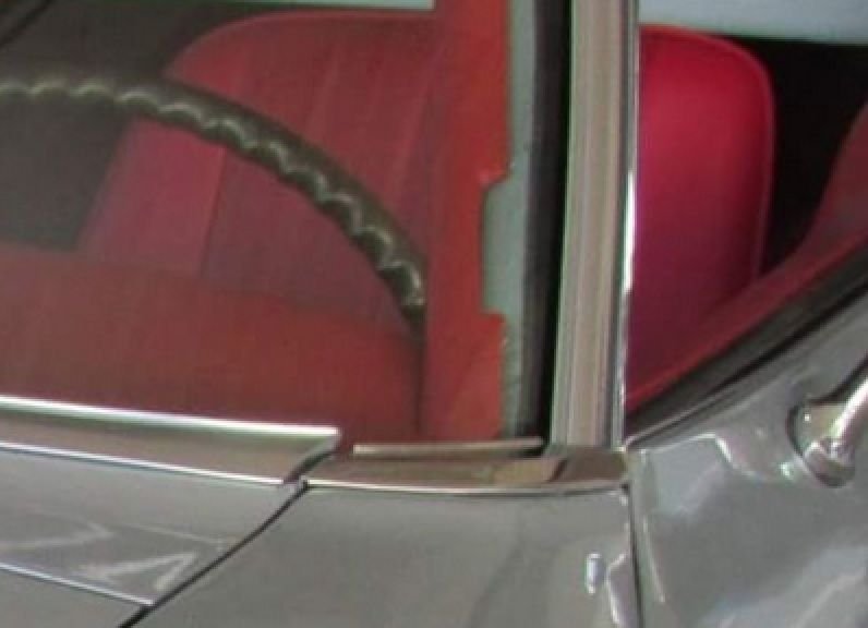

Hi Tim,
"I haven't seen anything written here that says the car is in bad shape."

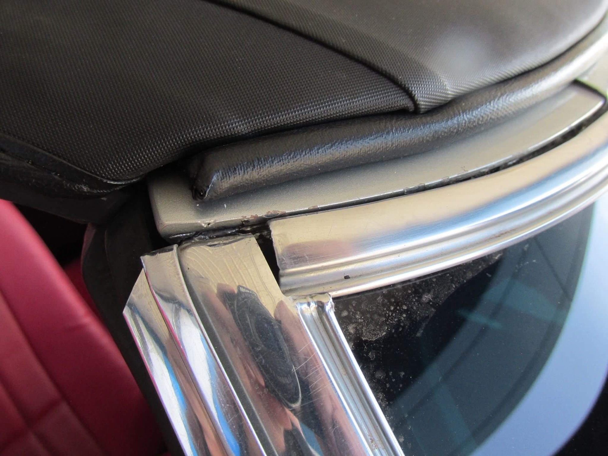

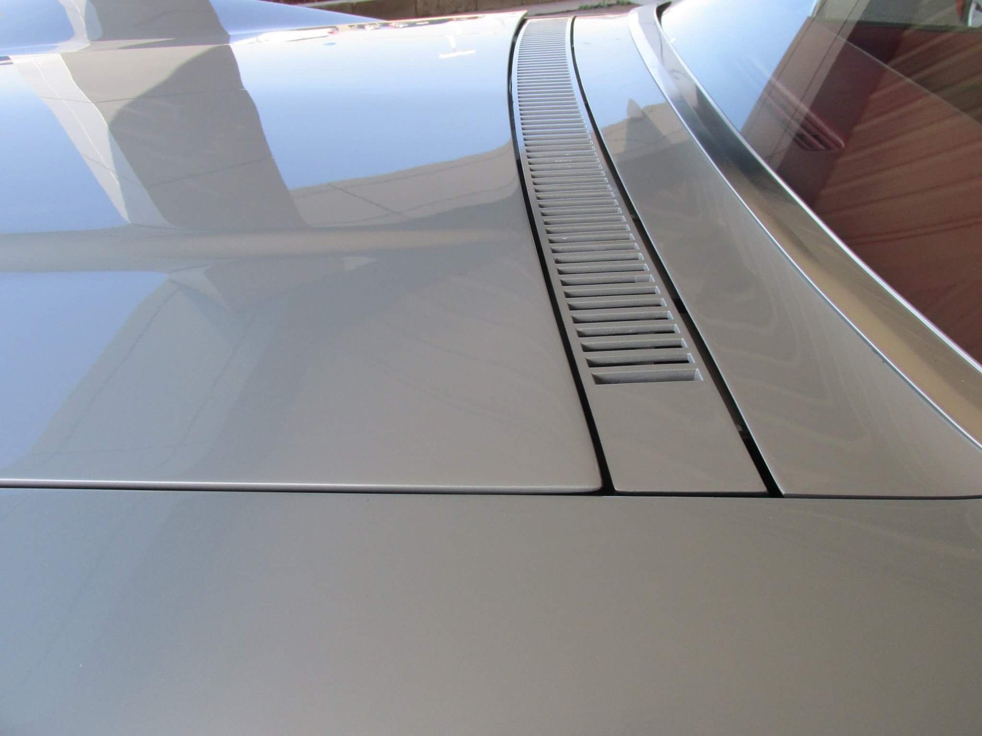

While not 'written', the photo showing the left side upper corner of the windshield header/pillar gives me reason to pause!
Regards,
Alan
Old Feb 19, 2017 | 03:58 PM
  #52
71 Green 454's Avatar
71 Green 454
Joined: Jun 2006
Posts: 6,400
Likes: 1,226
From: Tampa Florida

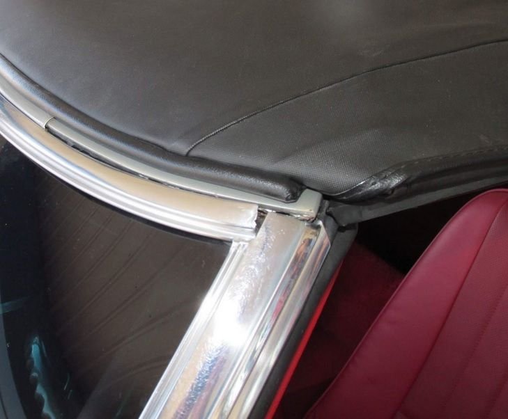

Originally Posted by Alan 71
Hi Tim,
Regards,
Alan
Alan, are you referring to the vin, or lack of? I didn't notice it the first time I looked. Is it missing, or painted over like the trim tag? How would a dealer check/verify the vin?
Or, are you referring to the windshield trim fit?

Alan: I agree that there are several areas that would cause me some concern also. But we can always find something that will give us a reason to pause. Are there ANY perfect driver's cars out there ? My point was that the car doesn't look like it went through a hurricane or dropped off a building and can be corrected to any level the buyer can afford. $$$$ But why jump into a car that he knows needs work & has a few questionable issues. At $37,000. I feel that he can get a better car that doesn't need as much work and has more useable options.
But if he likes the color, that's a decision only he can make.
ME ?? I would be interested at no more than $25,000.-$29,000. max, knowing it would need more work and $$ after the purchase.
joeinbcs: Pay close attention to what Allan & others are saying. It will save you money and, most importantly, aggravation later.

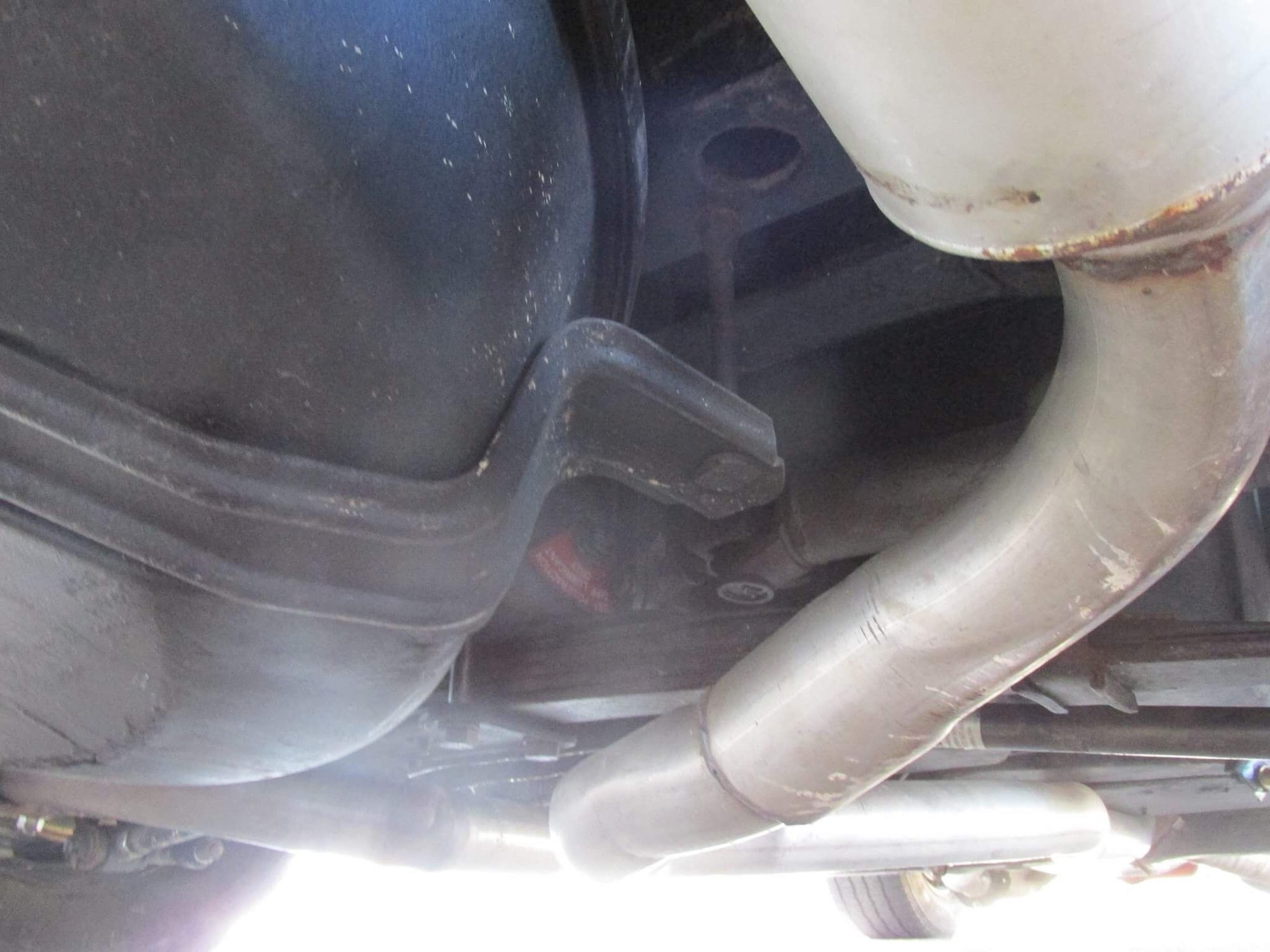

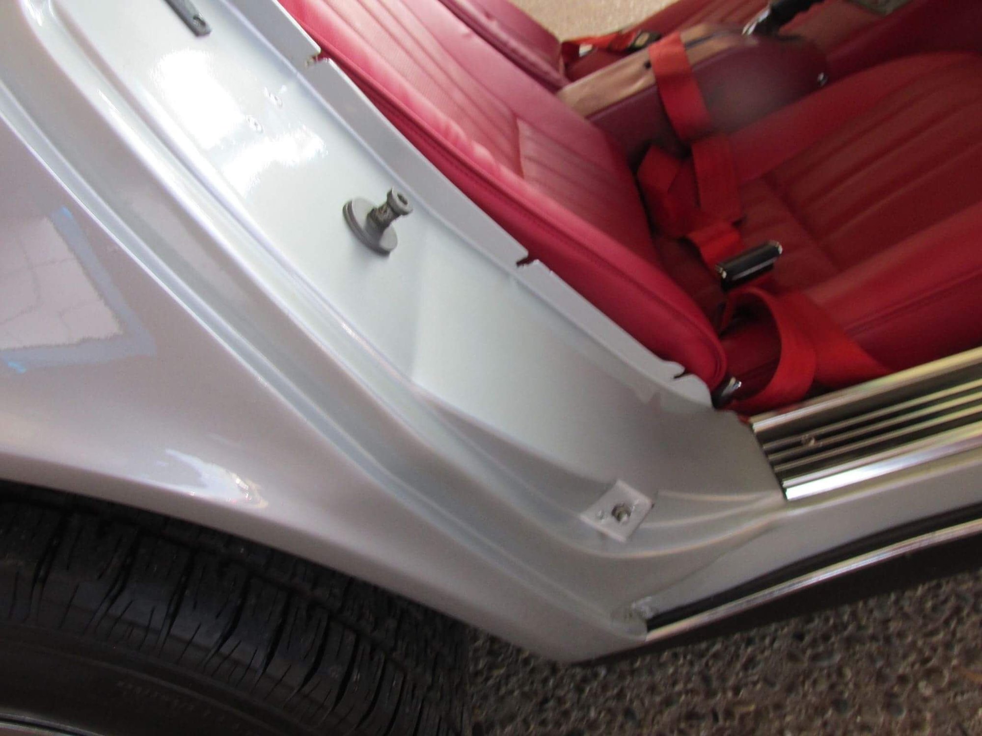

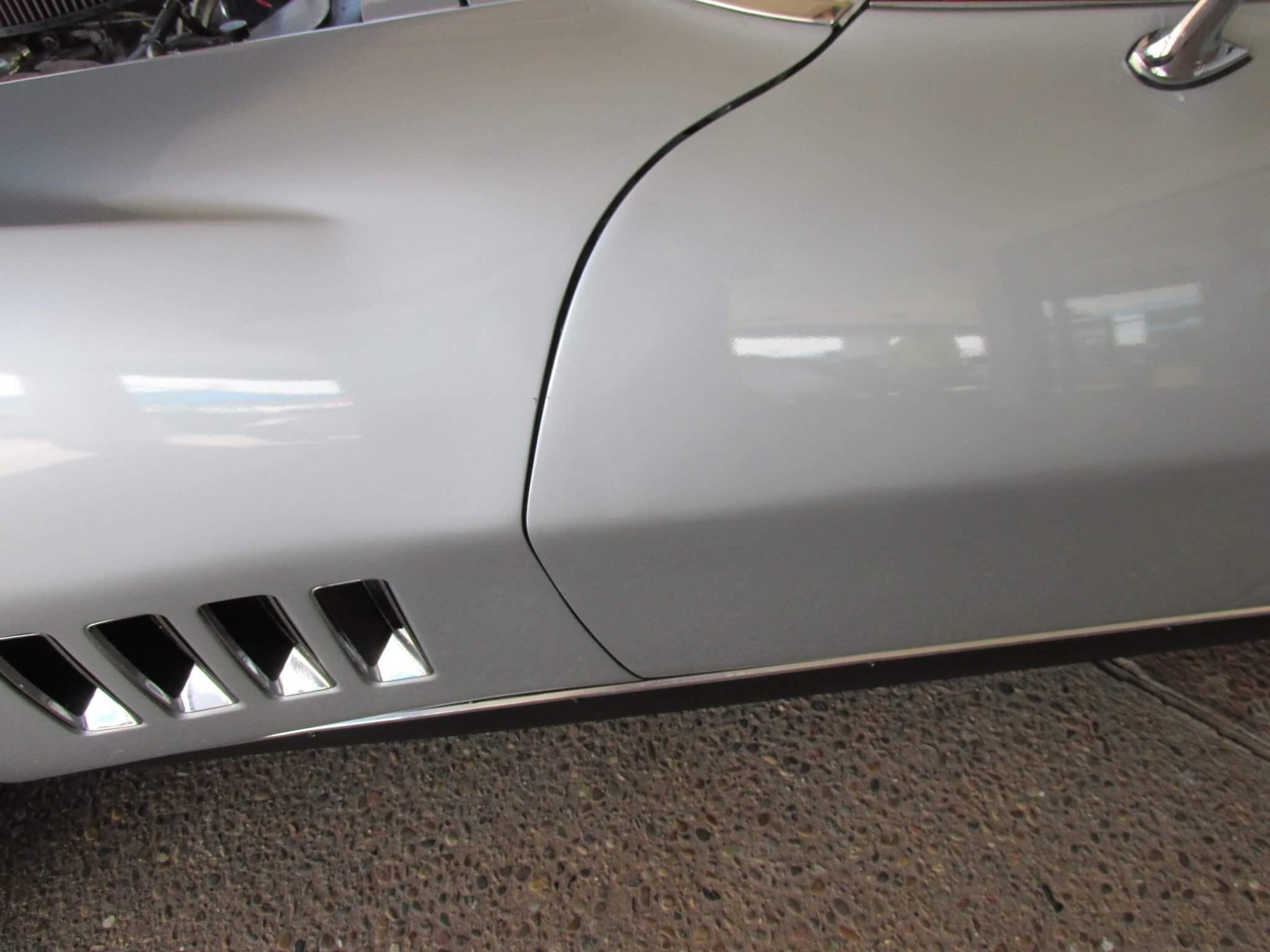

The more pictures you post, the more that shows up.
From the underside pictures, it looks like it may need a radiator, and maybe even a core support.
As has been pointed out, the rear valance is a 69, without the back up lights, and it looks like it has later one piece rocker panels on it, not the 68-69 two piece ones. The parking brake console is a 69-76, and the seat belts are replacements. The fender louver trim inserts were not available in 68, they were only offered in 69. The car also has headers, aftermarket sway bars, adjustable strut rods, chrome timing cover, electric cooling fan, and the belt set up is all wrong. I'm not sure why it has a ballast resister, or what's going on with the overflow hose on the expansion tank? Allen's right about the seat covers too.

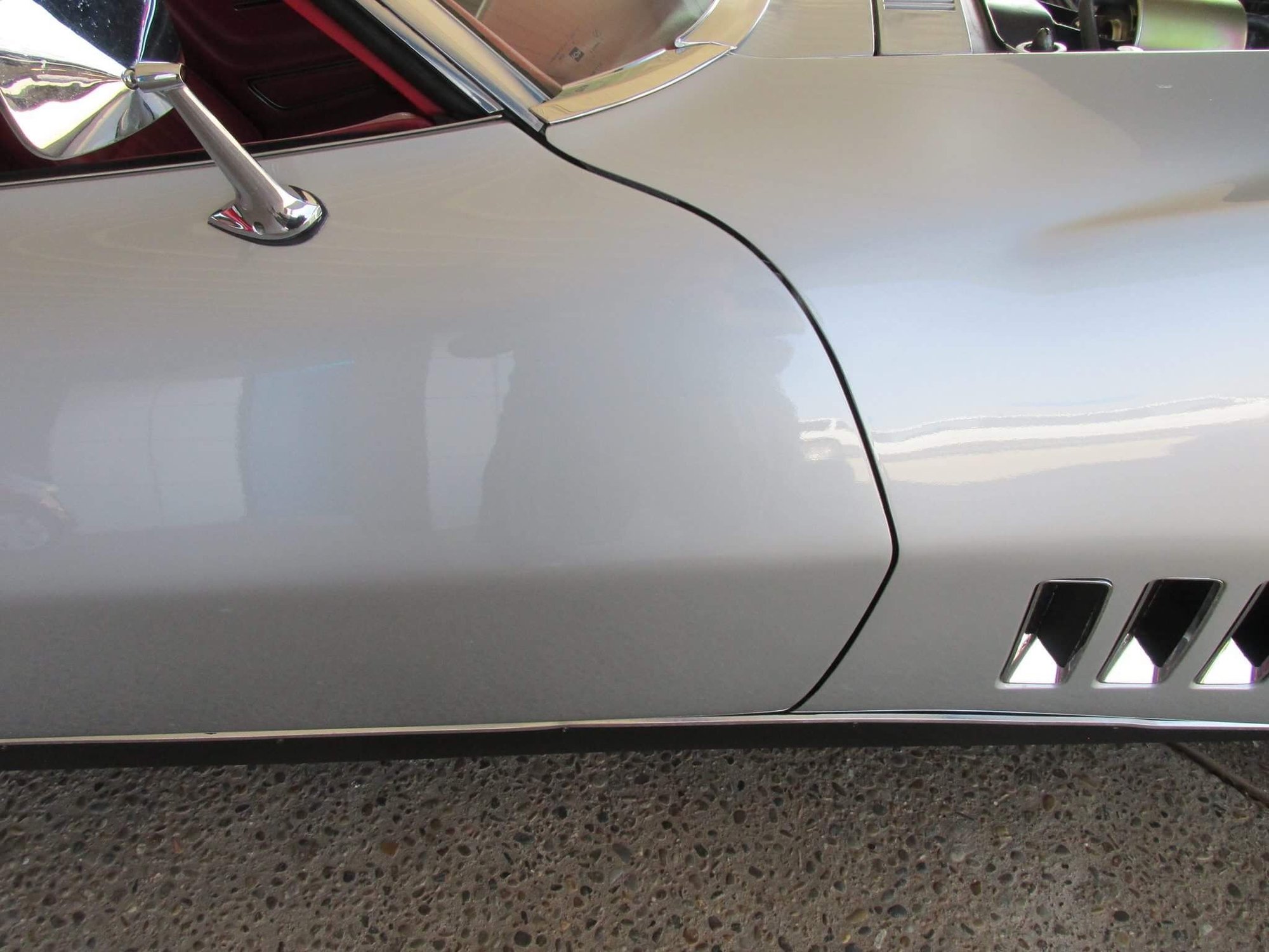

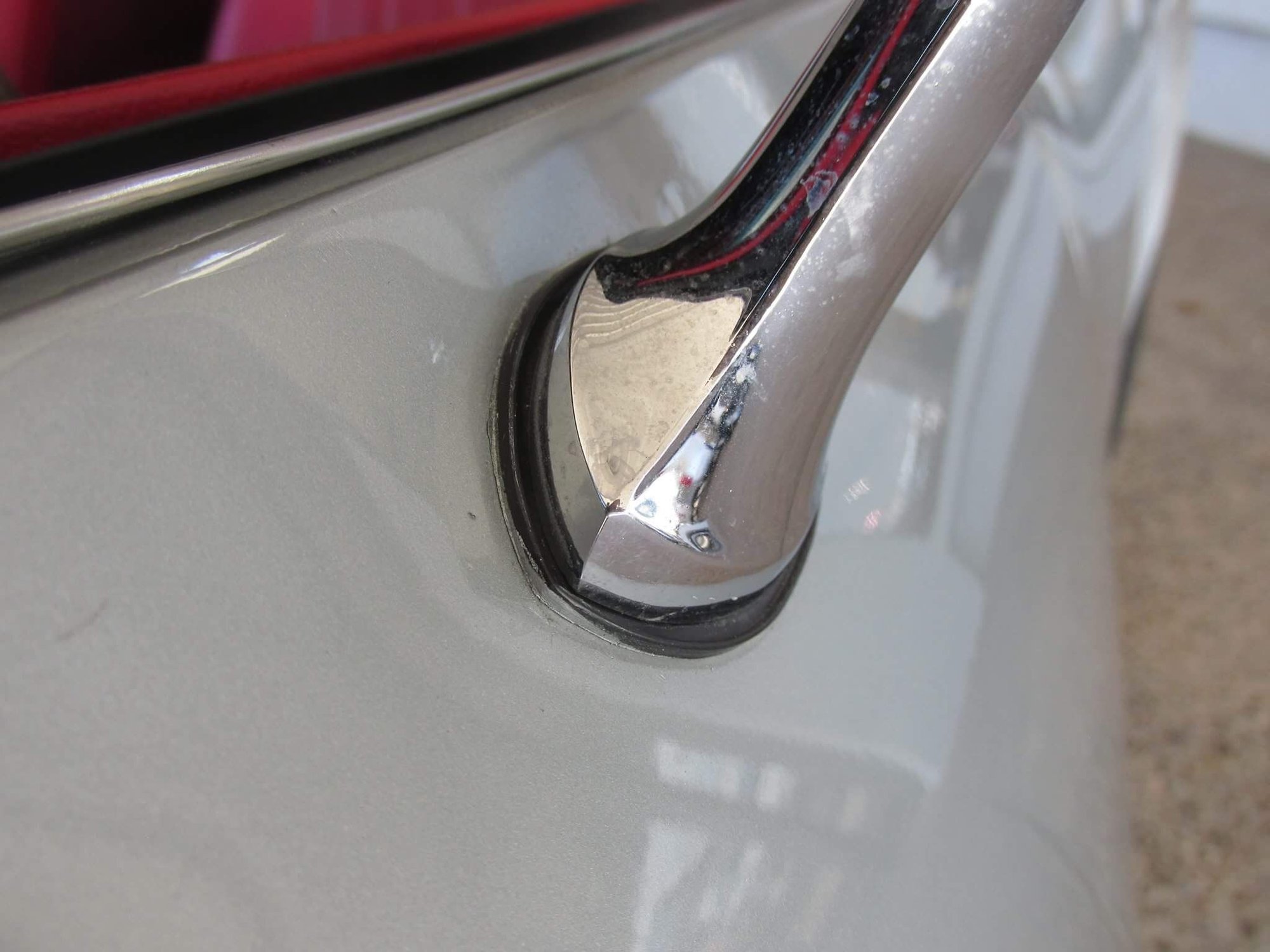

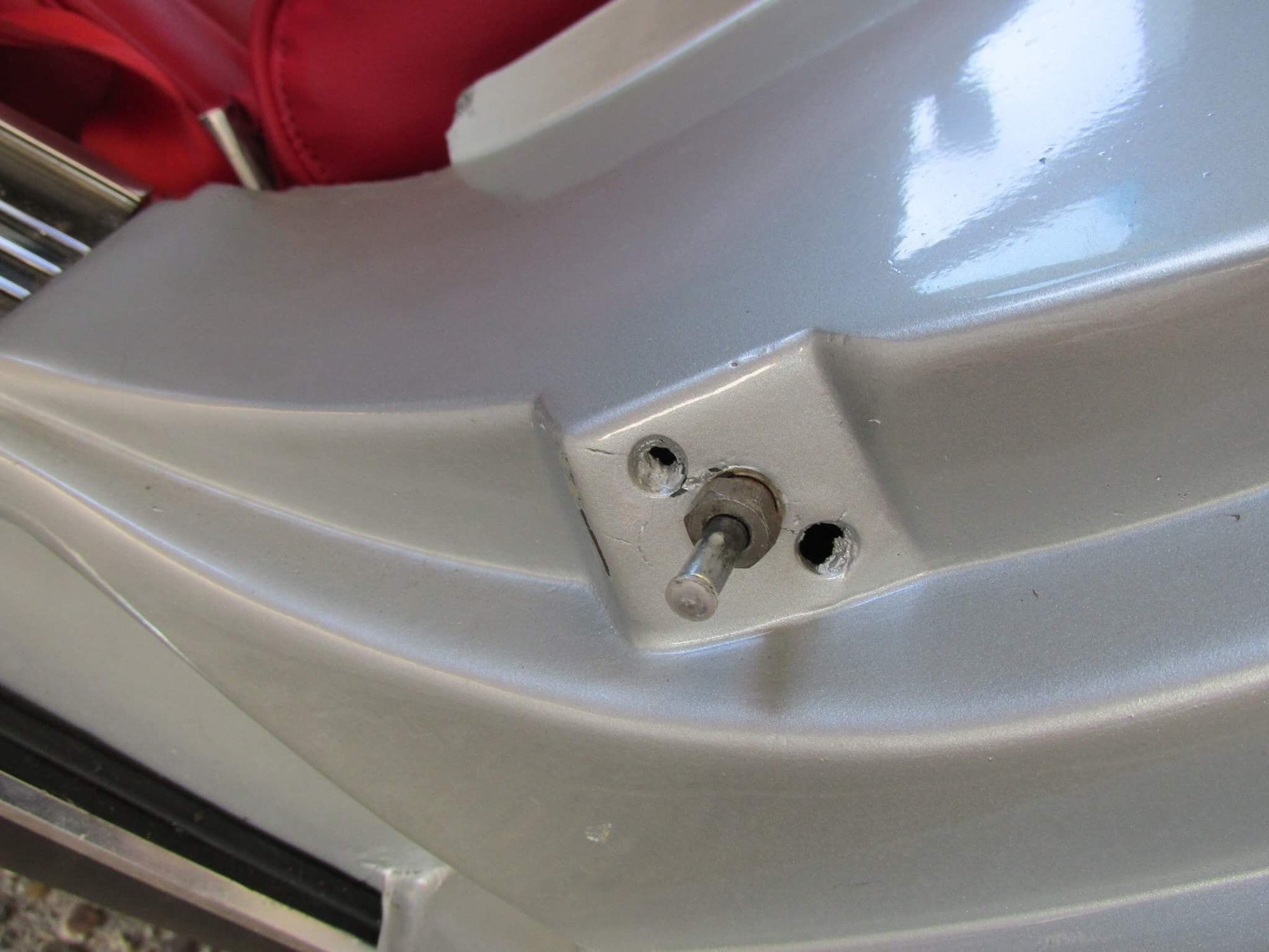

This really bothers me. Whoever painted it, couldn't even be bothered to remove the mirror. Just one Allen screw holds the mirror on, but they chose to tape it off instead of removing it. You can see that they only taped the outer wipes too, oh and it looks like they may be 69 up wipes, not the two piece wipes used on 68's? I've got to wonder what other short cuts they took when painting it.

its missing the rear quarter trim in the interior, the parking brake console is cracked, wrong parking brake console( its missing the two seat belt pockets) and its missing the dust shield, the seat belts are wrong, the rear carpet is a different color than the front, was that a paint bubble, the passenger side windshield trim is not looking like it wants to stay on, the bluing at the bottom of the radiator might suggest a leak, the wiring at the ballast resister doesnt look like it was restored well.
As ALAN says, the more we see the lower the price goes, and the vin missing from the windshield post isnt a good sign,might have been repaired and not replaced.

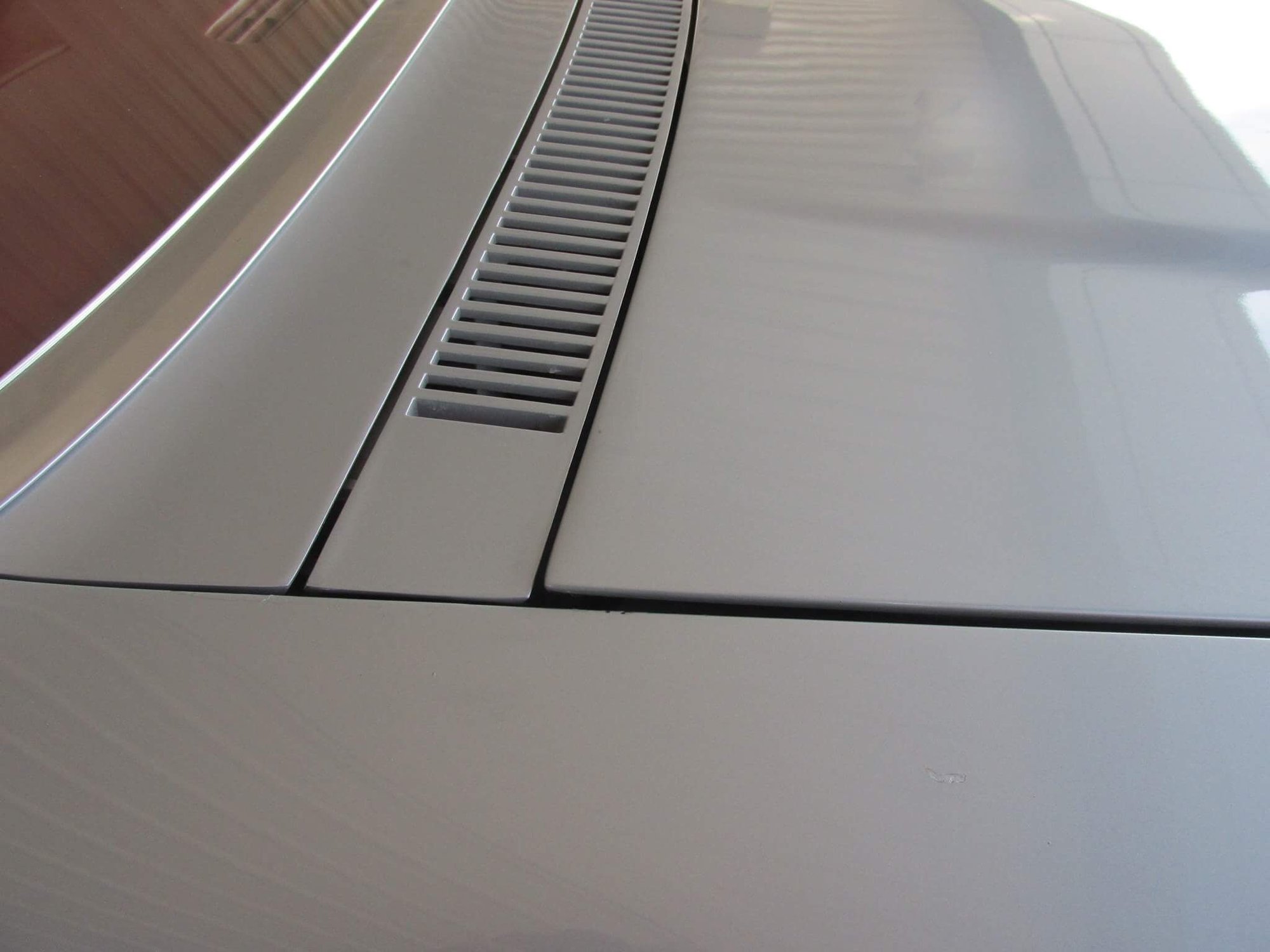

the positives are the paint looks good, no visible rust on the frame, the door and hood gaps look good
You may want to wait for the auction and stay around $30-33K , you will have to make repairs and add parts to this car
