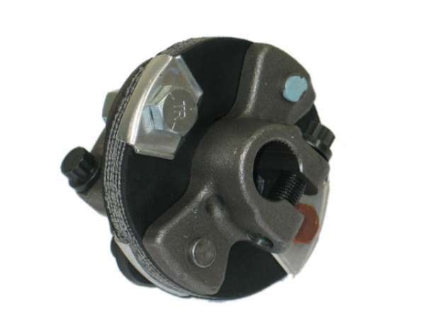

Picked this up from a forum member. Pretty sure it's for a C2. What says all knowing CF. also, is it GM or aftermarket?

It looks like a 63-66 coupler for the standard column (tele columns used a different coupler).

Yes, that is a C2

Default Looks like coupler on my 1968 too...
just pulled my column last week.
Originally Posted by Mr D.
Yes, that is a C2
The 68 coupler should have an upper flange, similar to the 63-66 coupler that CA-Legal-Vette posted, but the lower flange of the 68 coupler should be the short flange, pictured below.
This is the steering coupler used on all 67-69 Corvettes, with the round shaft steering box, and the cast iron top.
