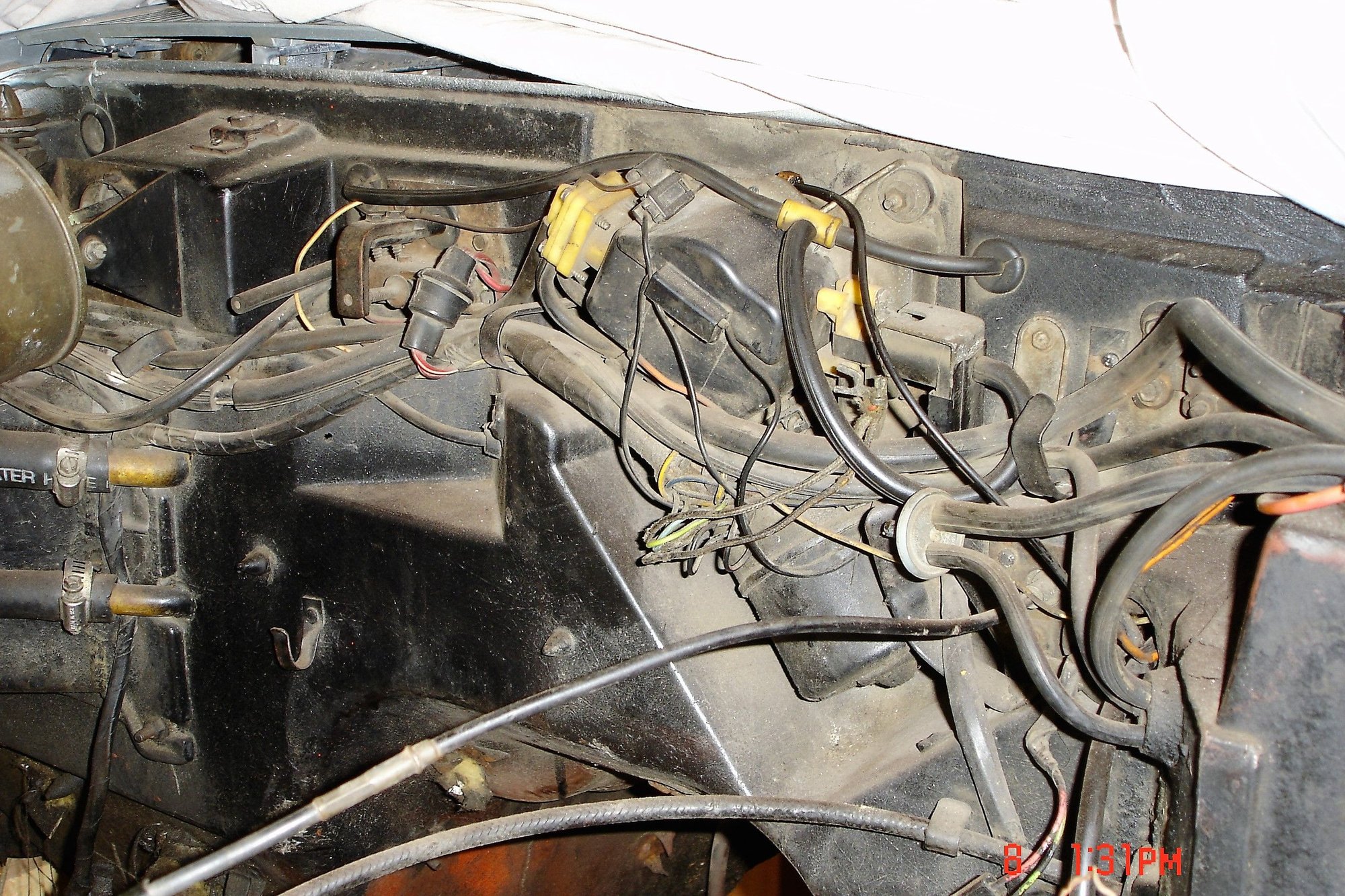

Have engine bay pretty much gutted except for the main wiring harness that goes through a hole in the fire wall because I can't figure out how to remove it... any suggestions (can post pics if needed)

Remove the bolt in the harness connector at the firewall and unplug the connector. The two sides of the harness will then pull apart.
Purchase the AIM and chassis service manual for your car. They will be a help for you.
