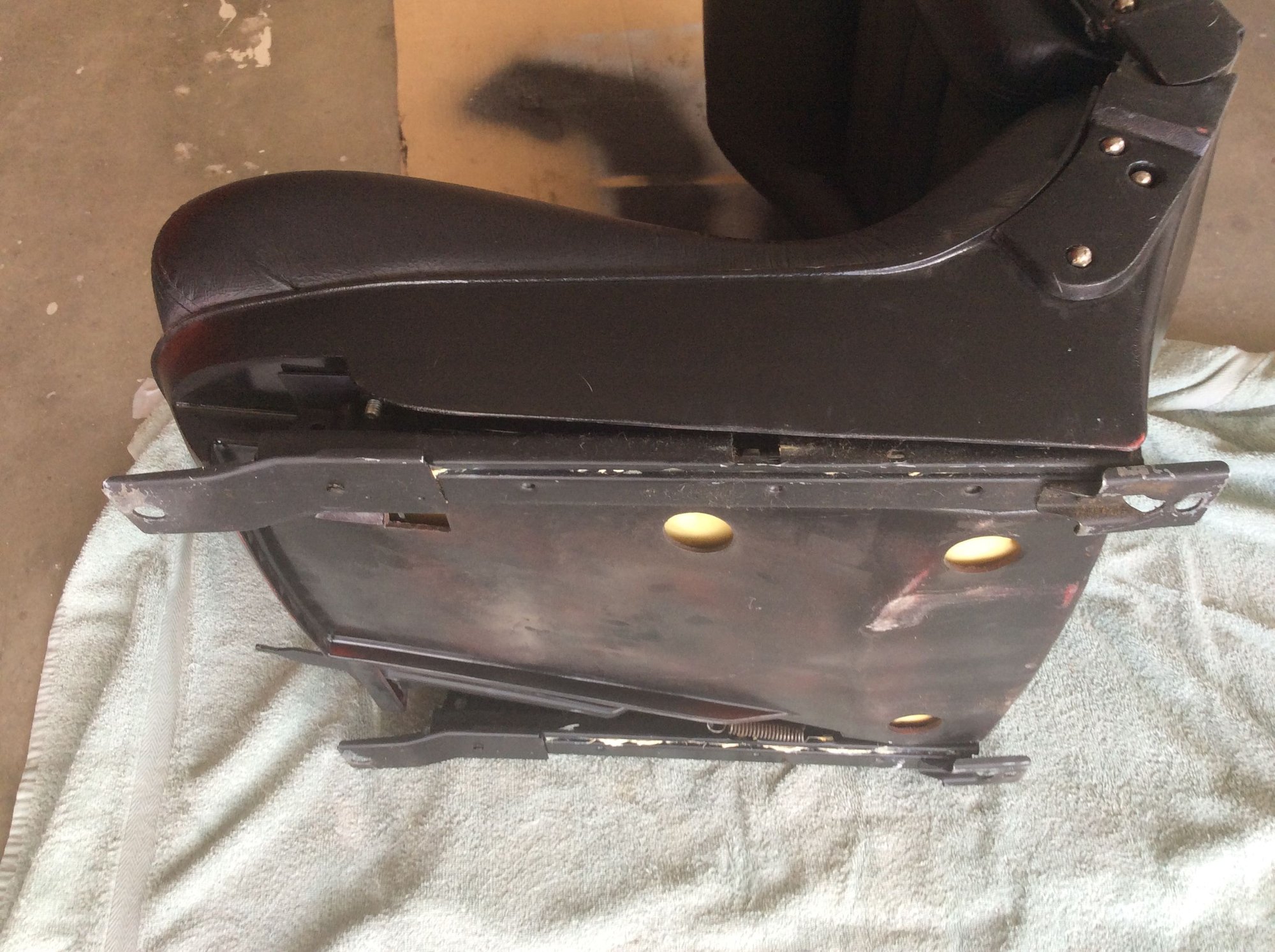

my late model seats, in my 69 ... using the later rails modified.
