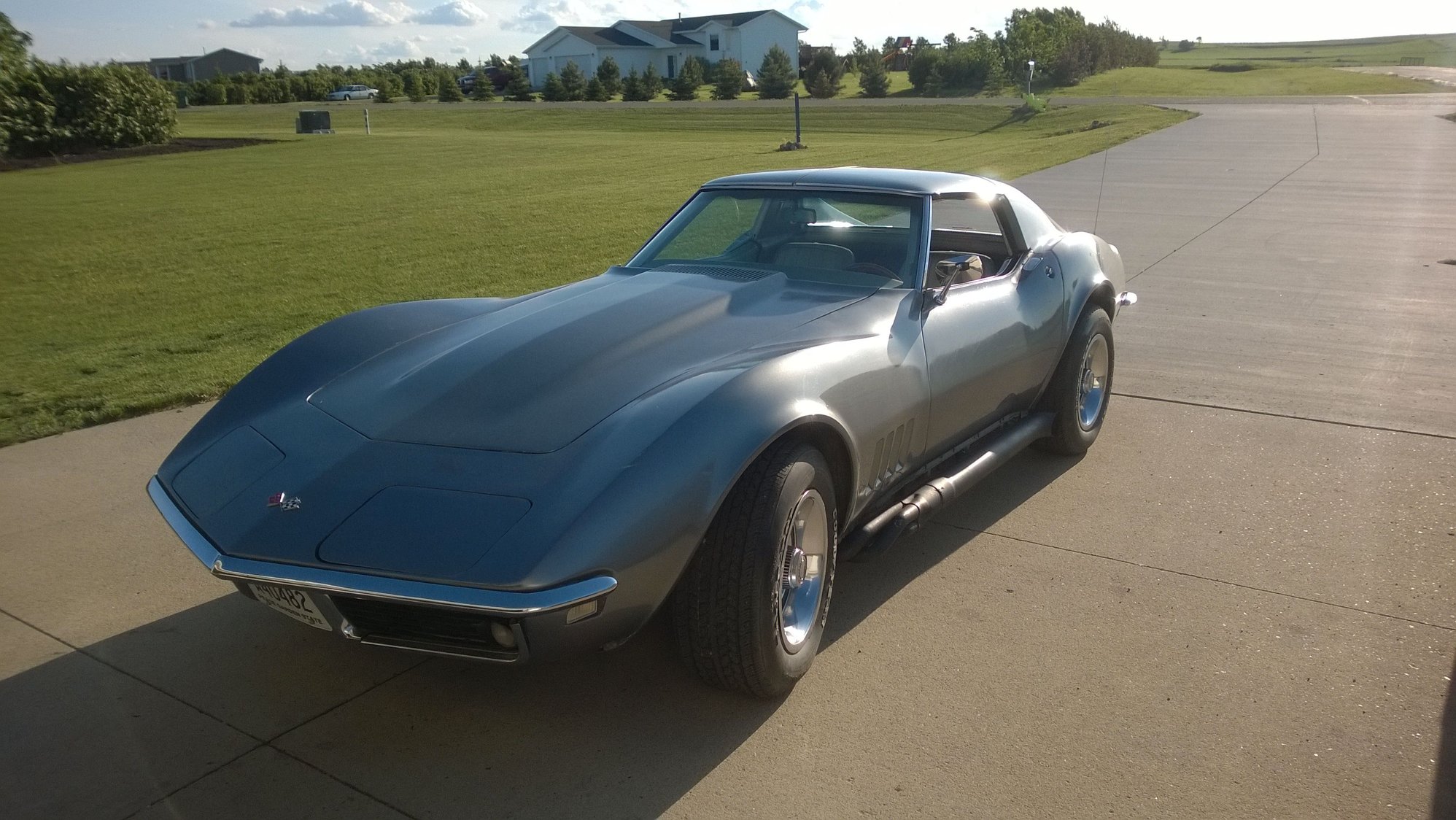

i have a long hood on mine, not 100% sure what year it is off of but all the latches match up well and without the fender extensions the hood lines up there also.
i have a victor jr intake on with a drop base air cleaner and it fits with about 1/2" to spare

good info guys and thanks a lot nice pics Phil
