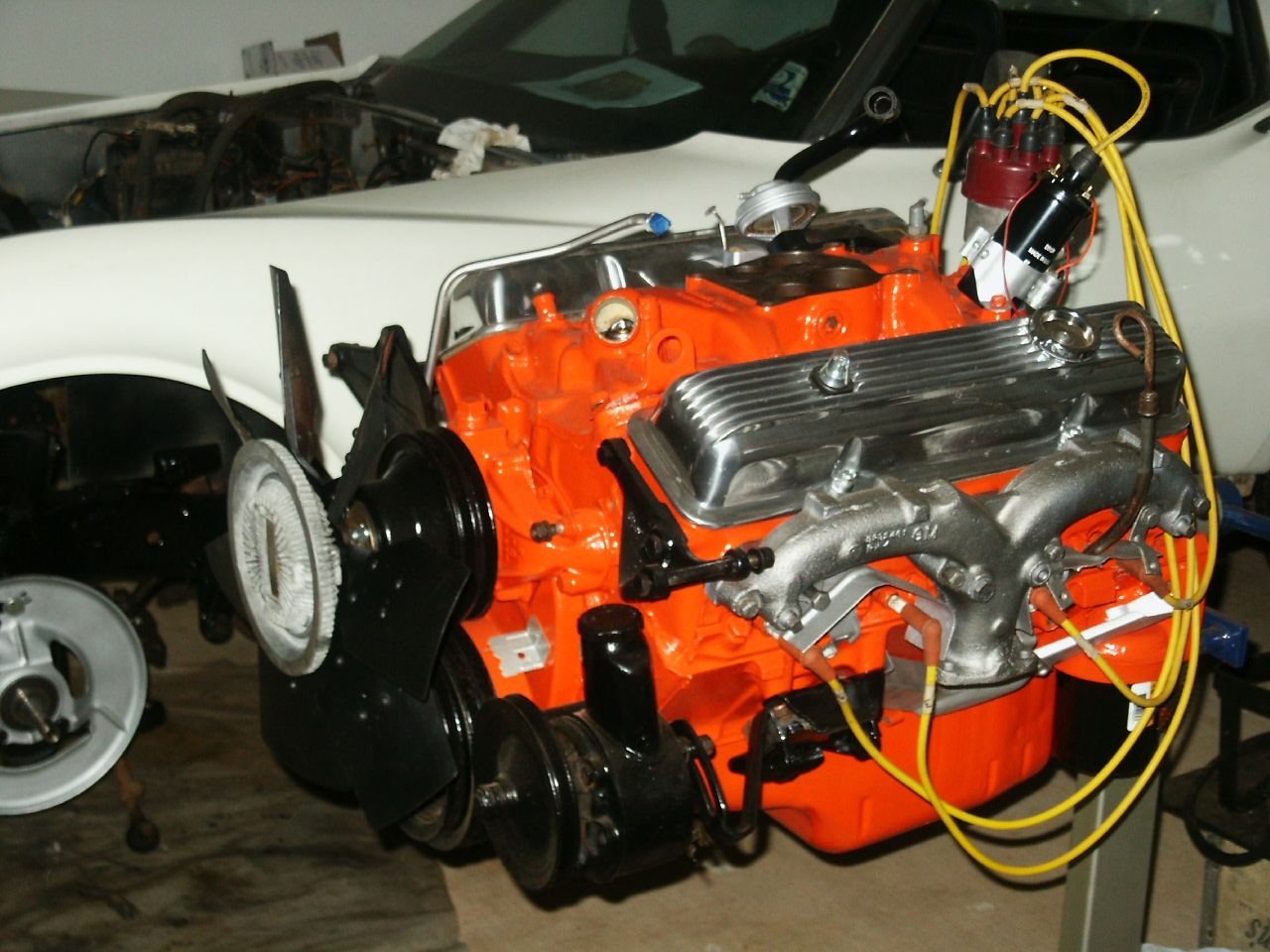

This is a photo of my 73 timing marker that is original.
Donnie

yeh thats what I expected. Mine is tucked up under the water pump pulley at top. Stupid place for it on any engine. Is your attached to your block?
Thanks
Gary

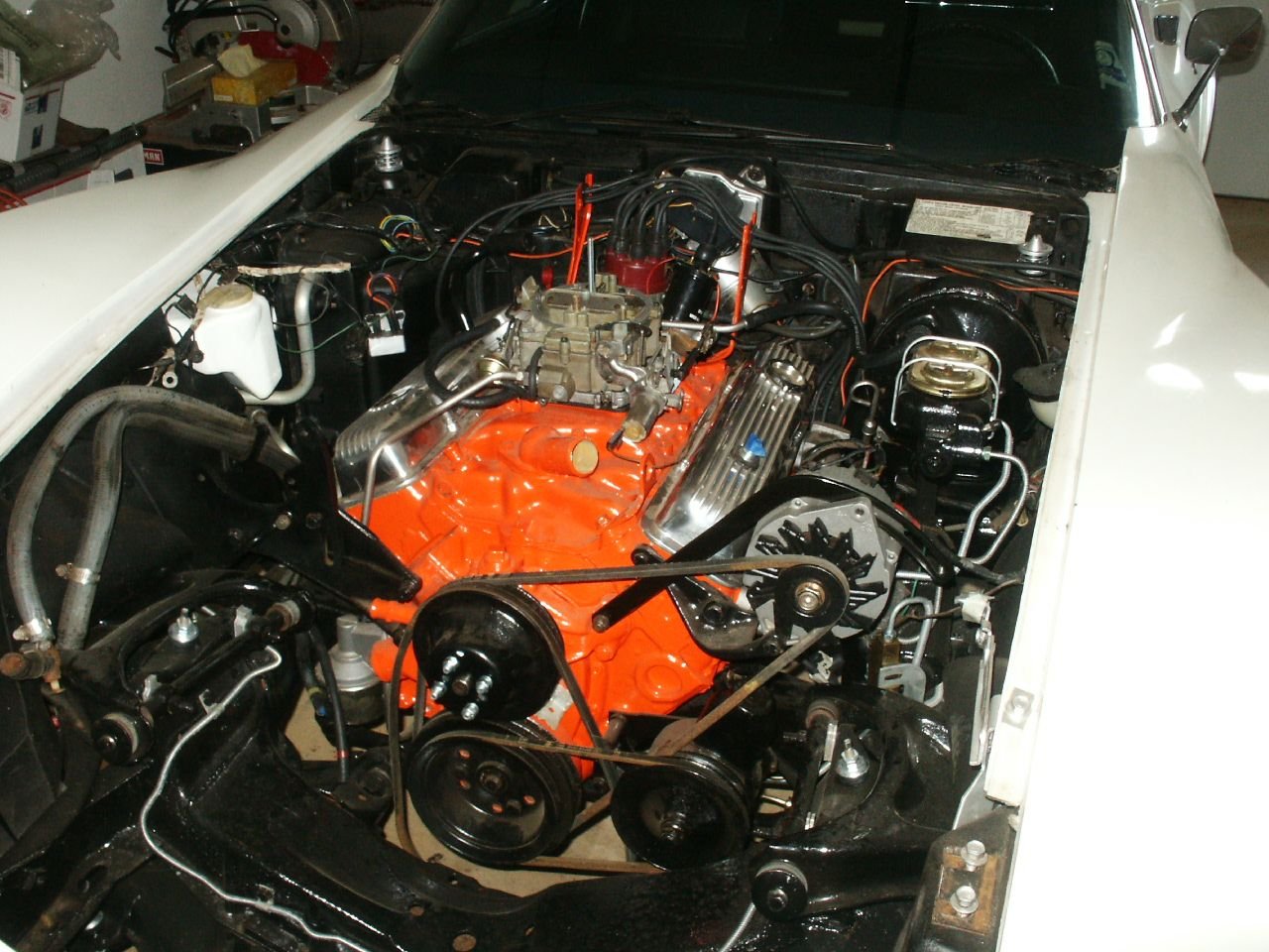

No, it is attached to the time chain cover. Maybe you can see better
on this photo.
Donnie
