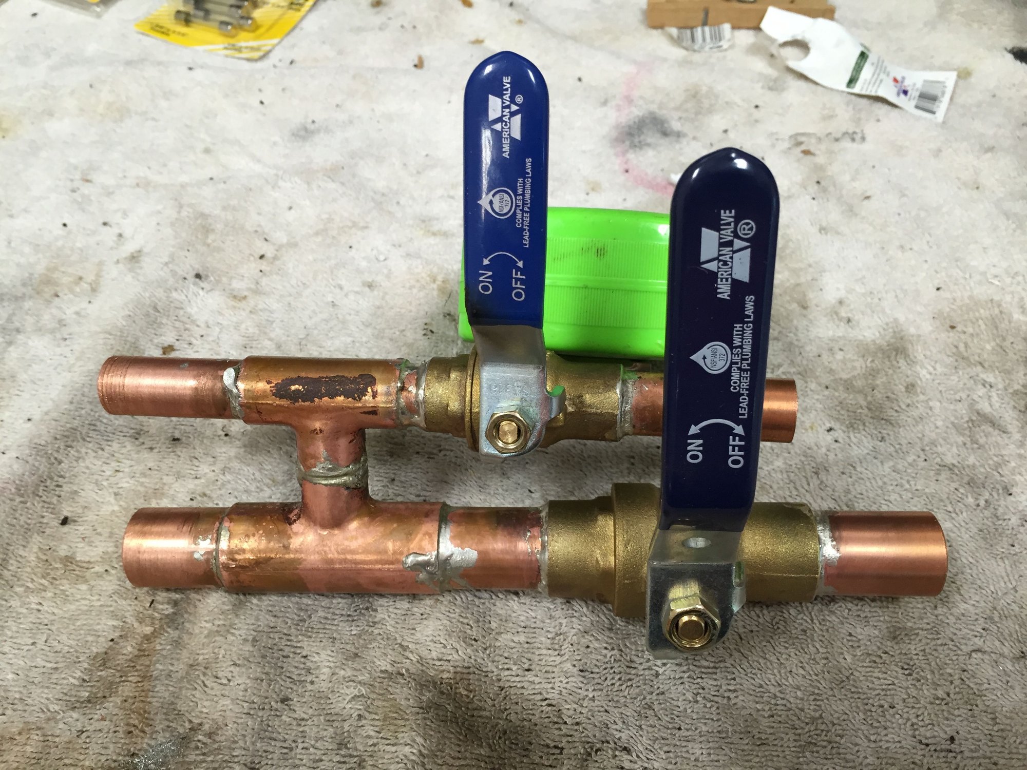

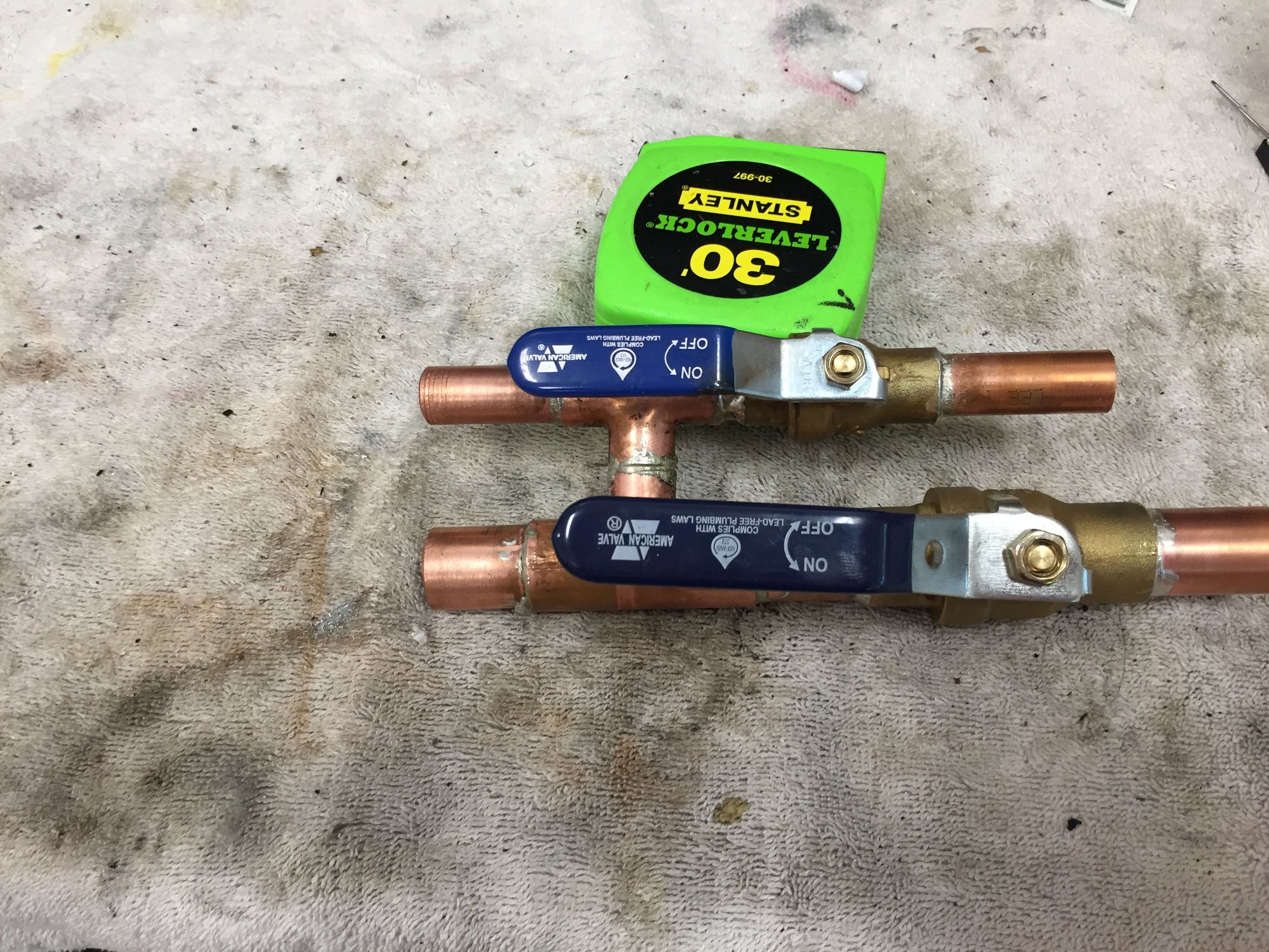

Old Mar 13, 2017 | 10:25 PM
Msbfdx's Avatar
Msbfdx
Joined: Feb 2015
Posts: 194
Likes: 11
From: Tennessee
This is how I rigged mine. It cuts off flow to heater, but still circulates. I painted it black, installed down low and removed handles.

This works.

Originally Posted by mjmike
This is how the previous owner sorted this issue out. Seems to do the trick. Anyone see an issue with this setup?
Mine is similar to this and to Paul74's.
Question:
Is it necessary to open the shut-off once in a while to get fresh antifreeze into the heater core?
Old Mar 19, 2017 | 08:57 PM
Paul L's Avatar
Paul L
Joined: Aug 1999
Posts: 30,995
Likes: 99
From: Ontario
Question:
I would say yes.
