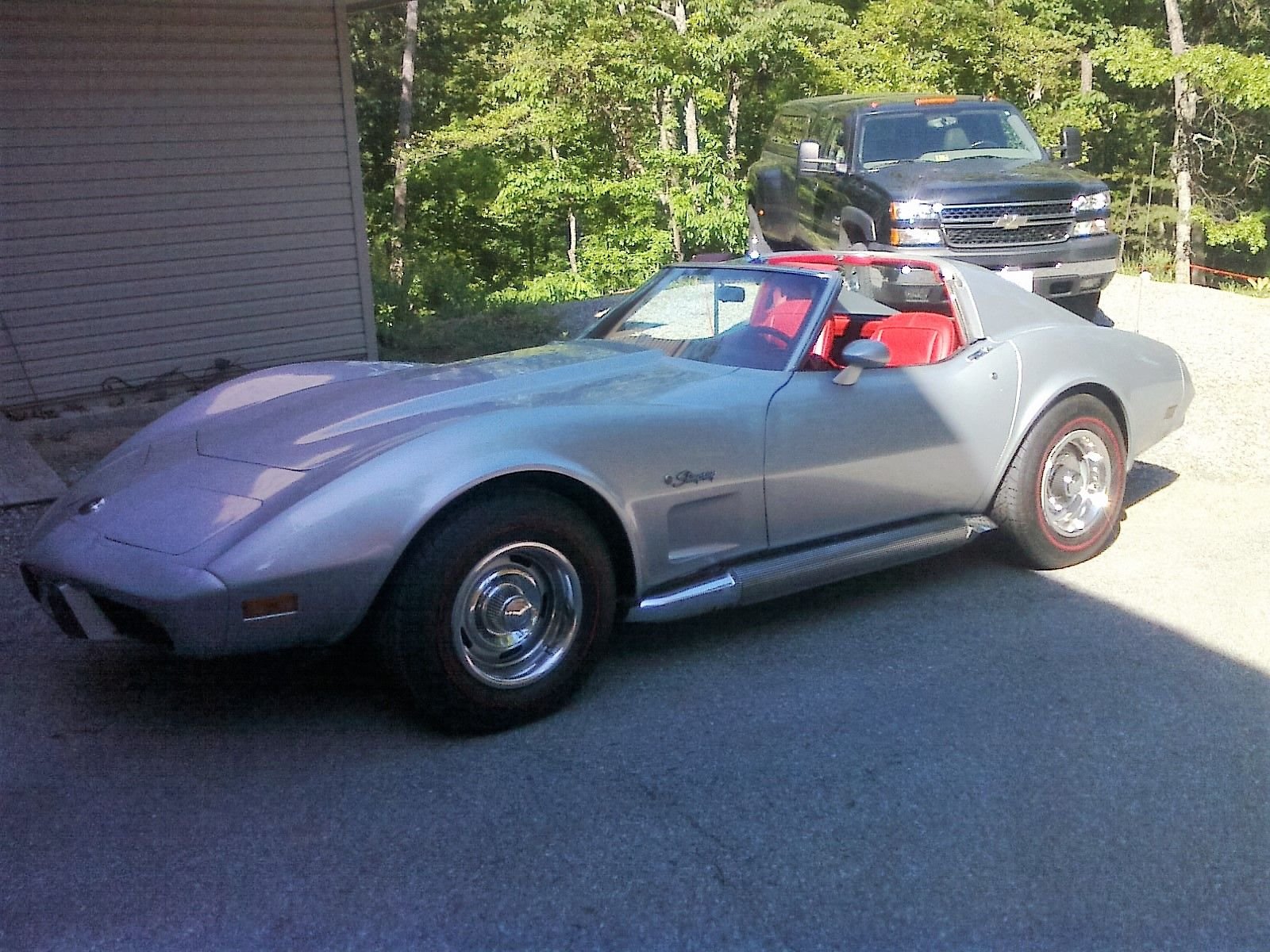

Purchased these from Paragon when I had my 76 and I never heard of that nor did any of the paint do anything and I washed the heck out of the car pipes included.
The picture below is after 2 years.
RVZIO
Have a new set for my 69 project when it's time. Never heard of such a thing.
RVZIO
