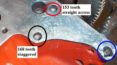

You need this information.
The straight across pattern is for stock 12-3/4-inch diameter flywheels (typically 283/327) and flex plates (Powerglide) and the staggered pattern is for the 14-inch diameter flywheels (typically 350/396/427/454) and flex plates (typical Turbo 350/400).
Rebuilt starters have often had the mounting surface cut when rebuilding to give a smooth, flat surface and as such, normally require some shims to space them out so the gear doesn't hit or isn't too tight meshing with the ring gear.

I have an offset mounting pattern...any way to verify I have a 168 tooth flex plate while it's installed?

it looks like you have a high torque starter it should have a dual straight mount so it will fit both flywheels. you may want to check it out.
I do agree with this as long as its a stock starter...
Don't mistake the video I posted above for my current situation...that is just a random video pulled from Youtube to convey the sound I'm getting when I try to start my car. I'll post a video this weekend of my situation to better gauge what's going on.
Are you saying that my 76' can accommodate either a 12 3/4" or a 14" flex plate? As of now my starter with the offset bolt pattern, which I take it is for a 14" 168 toothed flex plate, is either engaging/hitting the flex plate, so can I assume it's the 14"?
