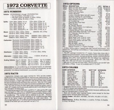

1972 Corvette Alternator ID Numbers
1100543 - 454ci, 270hp
1100950 - 350ci, 200hp, 255hp
1100544 - All with air conditioning
........................................ ................. tom

I believe during the 72 model year production the alternator part number 1100543, was used on the 454/270 hp (without a/c) engine.

you Sir are 100% Correct
i corrected my post
i read info one way and entered it another - old age
thank you Alan71
