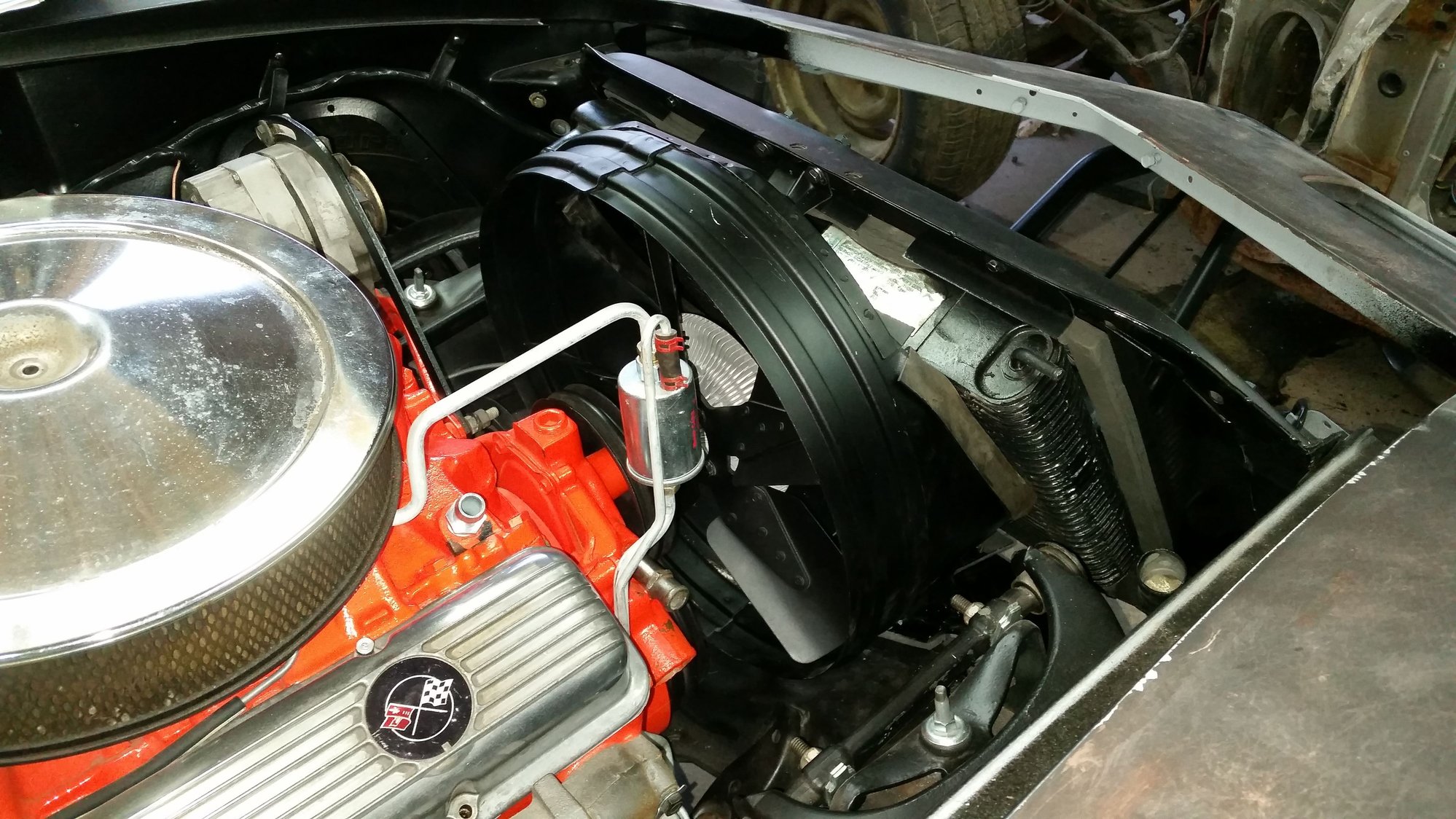

In the mean time, I'm working on getting the fuel lines and filter back to original. Someone removed the original filter at some point.
Before...
And after...
One problem. When I got it put back together and started up the engine, the fuel line fitting exiting the pump was leaking. I had to pull it back apart and reinstall it. Haven't had a chance to test it yet. Anybody else have problems with the flared fittings on these hard lines not sealing right?

Oh yes, when I connected the fuel lines I could not get the pump fuel line to stop leaking. Removed and reset it by loosening that line now I had a leak at the filter. Long story short , a great tip from a forum member that I don't remember who said " a very small thin rub of grease on the flared fitting will allow for it to find it's seal. Worked like a charm. I removed all fittings did that and and have no problems since. Try it you'll like it!
RVZIO
Excellent! Thanks for the tip, Roger! I'll try it when I get back home later this week.

Seems to have worked...so far. I'll monitor the lines for leakage for a couple trips before I proclaim them sealed tight.
Thanks again, Roger!

Glad it looks like it may have worked. I chased leaks for a week. I did notice by running my car that also helped seat things. As a result for me they have all stopped. Hopefully the same for you.

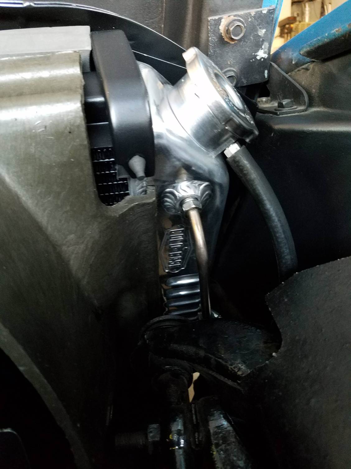

I also managed to make a vacuum hose tee that I needed. Some previous owner disconnected the vacuum line for the climate control. I assume the plastic tee broke and they just took it out and repaired only the main hose.
I found a replacement at Doc Rebuild, but never pulled the trigger on an order. I decided to try and make one. I bought some copper tubing at Ace Hardware and got to work. I sautered a couple pieces together, ran a 1/16 drill bit through the smaller tube to make sure it was open, and voila! A tee that will never get brittle and fail.

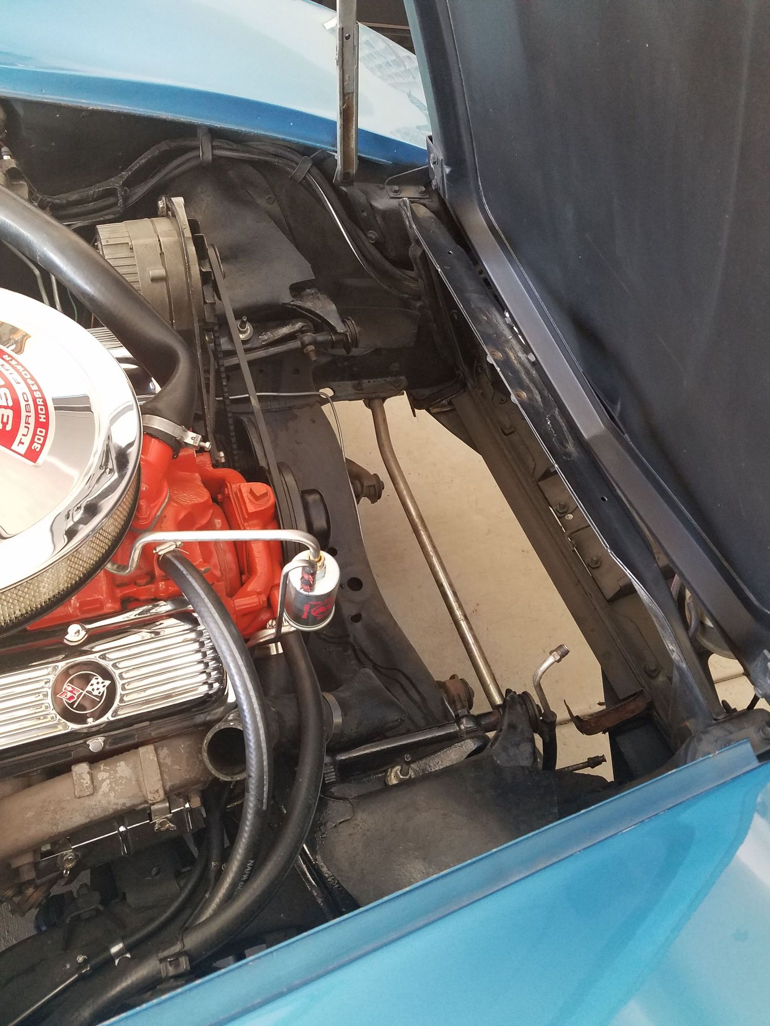

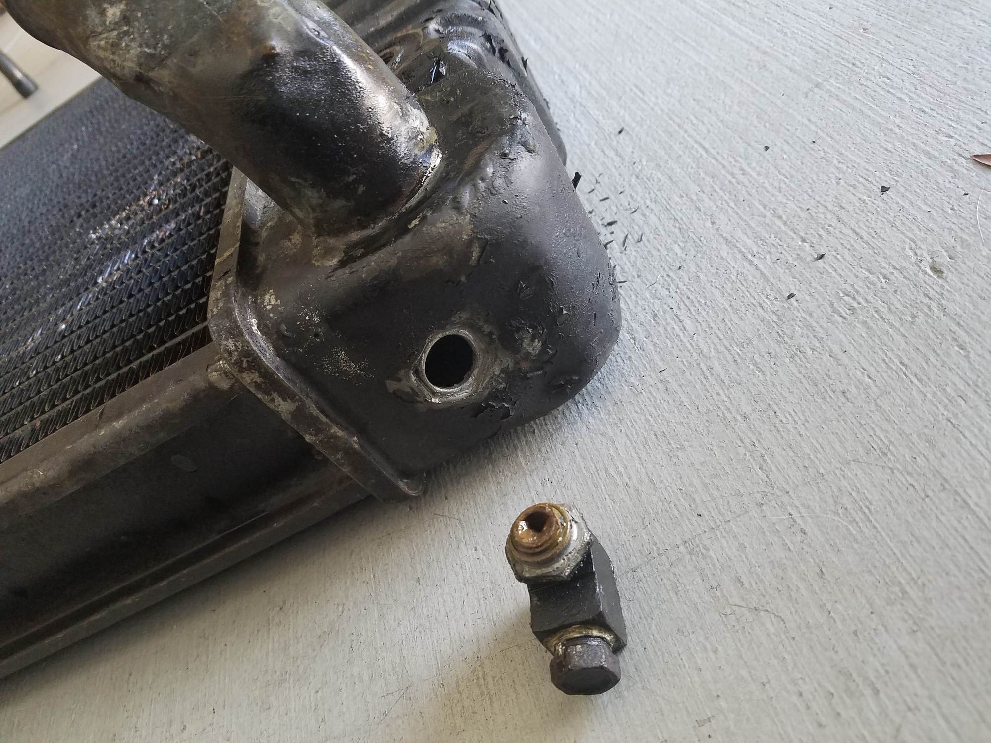

I'm also in the process of replacing my radiator. The engine has been running a bit warm and the old radiator had one or two pinholes that leaked a little, so I decided to go with a new aluminum unit. I went to drain the radiator by opening the drain plug, but I REMOVED the drain plug. Twisted it right off. No going back now!

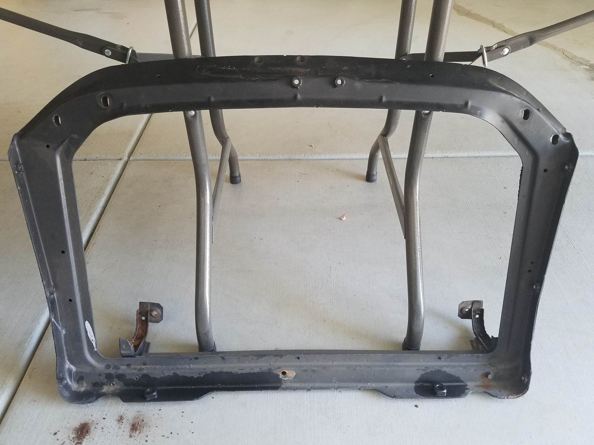

I'm a big proponent of "might as well", so I pulled the support out to clean it up and paint it.

Actually, the lower section was a mess. I covered it in another thread, but I had to rebuild the lower section. I got to practice my welding (boy, do I need practice!) and did a ton of grinding. Still working on that, but I'm getting close to finishing it.

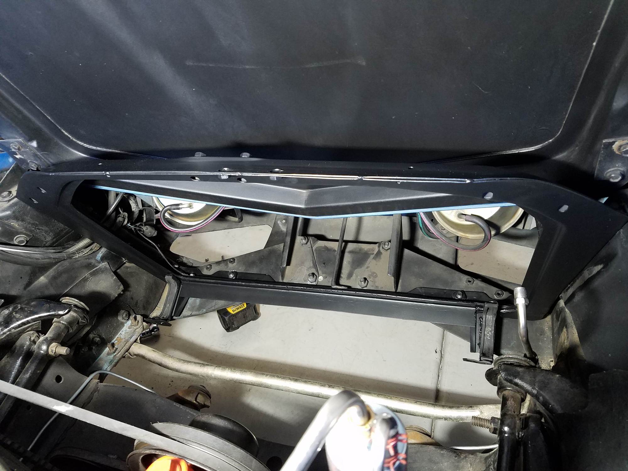

I spent the weekend finishing up my core support rehab project and then installed my new radiator.
The core support needed some extensive metal work on the bottom section. I pretty much replaced one whole side. I welded it all back together, and although I wouldn't use flux-core wire again, I did manage to do a passable job. It's not the prettiest, but with the help of some judicious grinding, it turned out alright.
One coat of primer, sand, then several coats of Krylon Industrial semi-flat.
Reinstalled in the car.

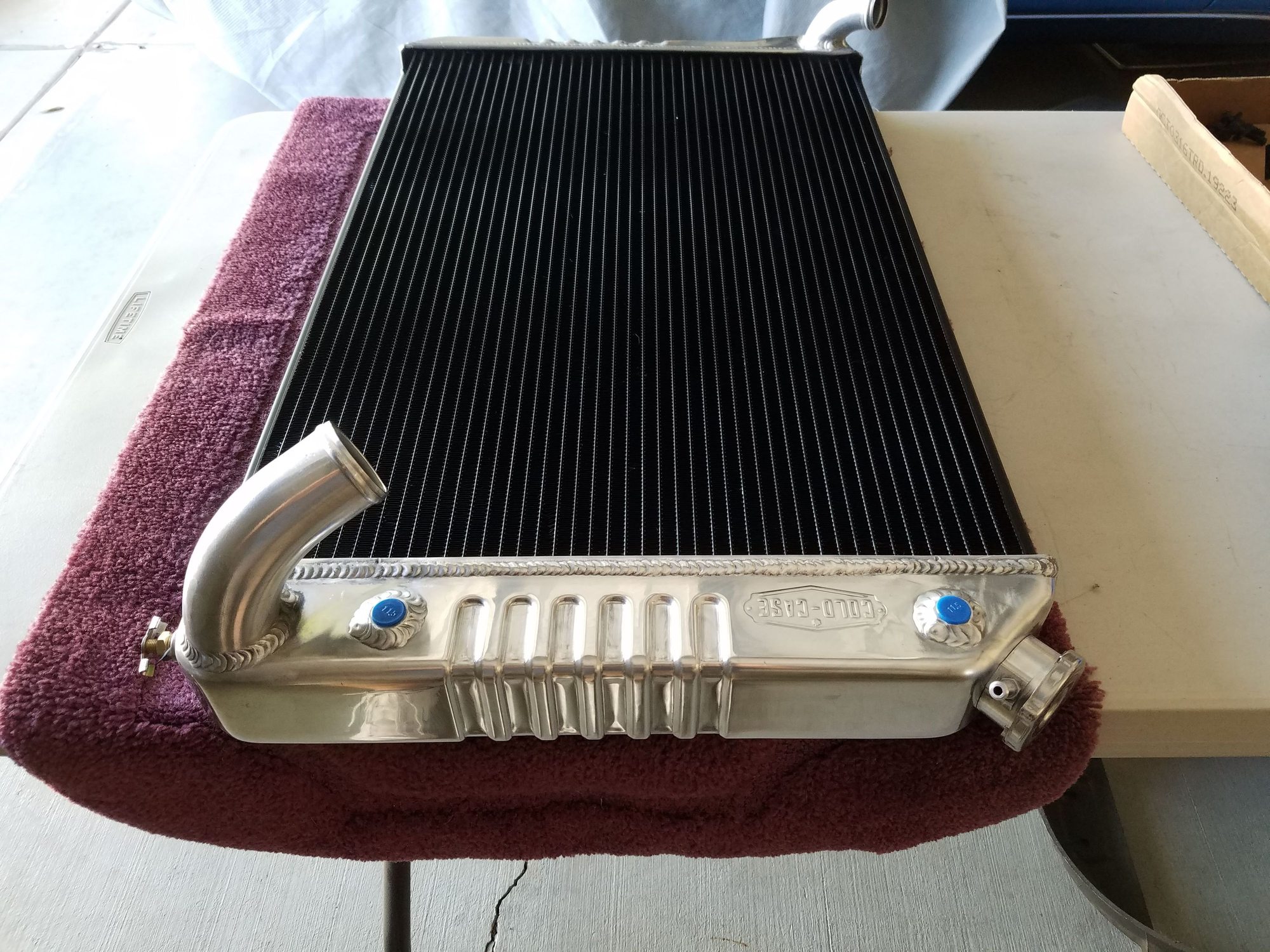

Then, on to the good stuff. I selected an aluminum radiator from Cold Case, based, in part, from a recommendation in a thread here on the forum. It wasn't the most expensive (Dewitts?), nor the cheapest (Champion?). I really liked that the tanks were press molded to look similar to OEM, and not a bunch of aluminum rectangles welded together. It's a pretty good looking unit.
I opted to leave the the tanks natural, but painted the fins.
The install was relatively painless. I had test fit everything when I was welding my core support back together. The only modifications I had to do were 1) I moved the passenger side lower cushion bracket about 1/2 an inch for more clearance around the drain petcock, and 2) the driver's side upper cushion bracket needed some grinding and adjustment to where the rubber isolator sits in order to get more clearance around the upper hose tube.
I still need to install the foam seals to get as much airflow going through the radiator as possible, but I took a test drive after getting the engine up to operating temp and the gauge was sitting at about 185 degrees when in motion. Climbs slightly when idling for awhile. Ambient temps were at 105 here in Phoenix, so I was happy with the results!

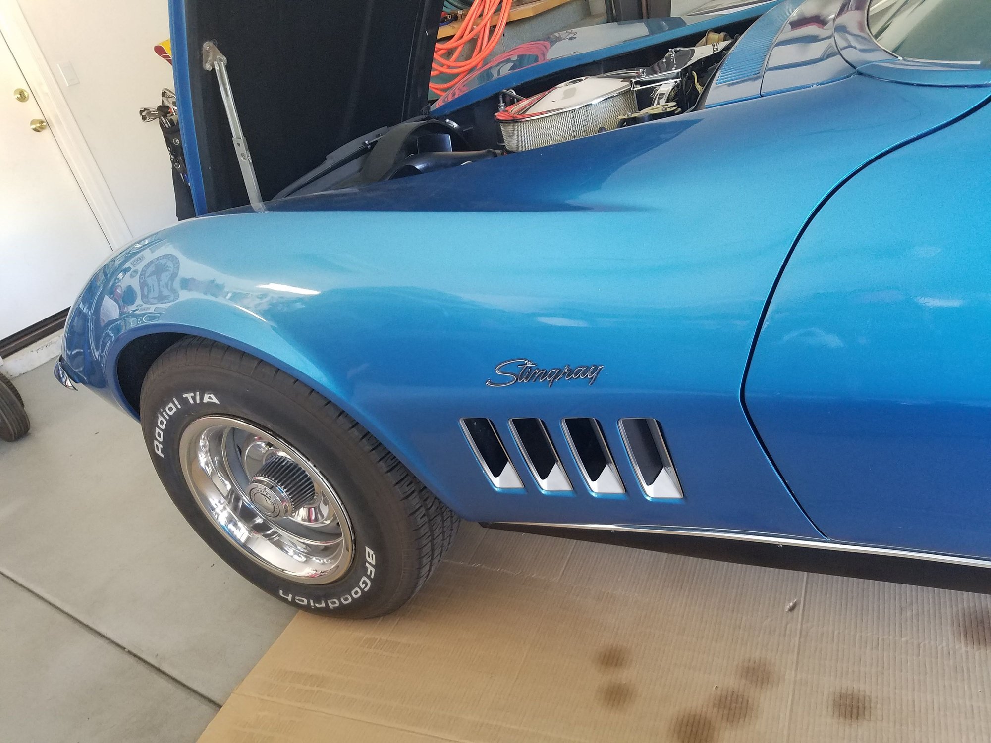

It's been a little while, but I'm gradually getting back to working on my 69.

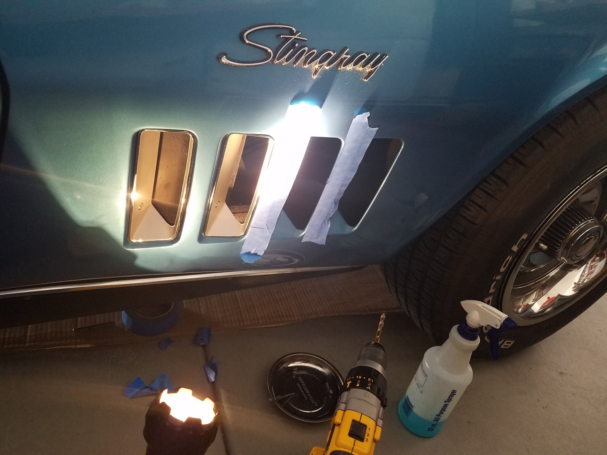

One item on the to-do list that's been long overdue is drilling a bunch of holes in the fenders! Lol. My wife bought me gill inserts for my birthday two years ago, and I finally worked myself up to installing them. Once you start, there's no going back. The fit is not perfect, but not much can be done about that. Just had to line them up as best I could.
I love the way they look. Should have been a standard item.

Nice!
I took the Louvre plunge last year too!
Love the look.
