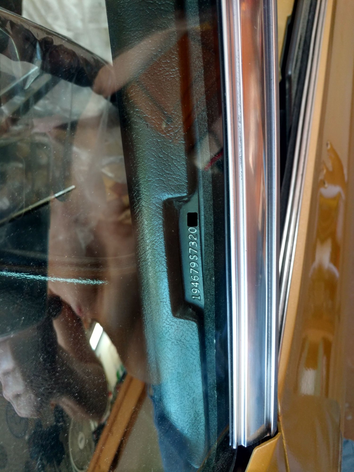

After looking at the existing windshield, it appears whoever replaced it didnt know what they were doing as there is a huge gap at the top between the trim and glass. Obviously they did not do their homework! Will let you know how it goes.
BTW - my friend just bought the car from a fellow forum member...
Heres a pic of the gap...I can stick my finger in it....
That gap is what I'm hoping to avoid. Thanks for letting me know of the change and please do let me know how it goes.
