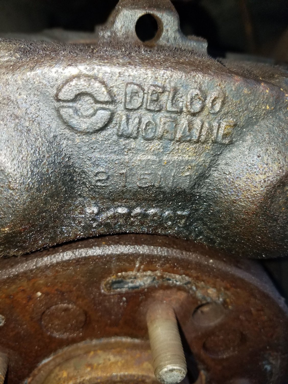

My newly acquired 1975 corvette has started pouring brake fluid out of the drivers side rear caliper. My question is how can I tell if it is the steel sleeved. I'd like to do the oring rebuild.

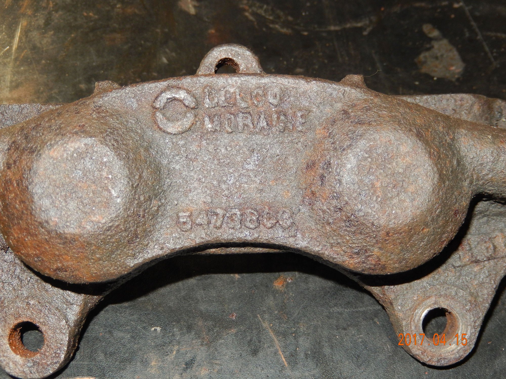

Think they are. I'll attach a picture if you recognize?
Old Apr 15, 2017 | 06:09 PM
gbvette62's Avatar
gbvette62
Joined: Oct 2000
Posts: 12,683
Likes: 3,136
From: Shamong, NJ
5473806 and 5473807 are the rear castings used from 73-82. So they could be the original calipers.
If they have been sleeved, then it's quite likely that they are not the original calipers, as very few people go to the trouble and added expense to send out their own calipers, to be stainless steel sleeved. Most people just exchange their calipers for ones that have been sleeved and rebuilt.
If they haven't been sleeved, then they could be the original calipers, but chances are pretty slim. Very few Corvettes still have their original calipers after 40+ years. The seals just don't last that long, even on a car that has never been driven.

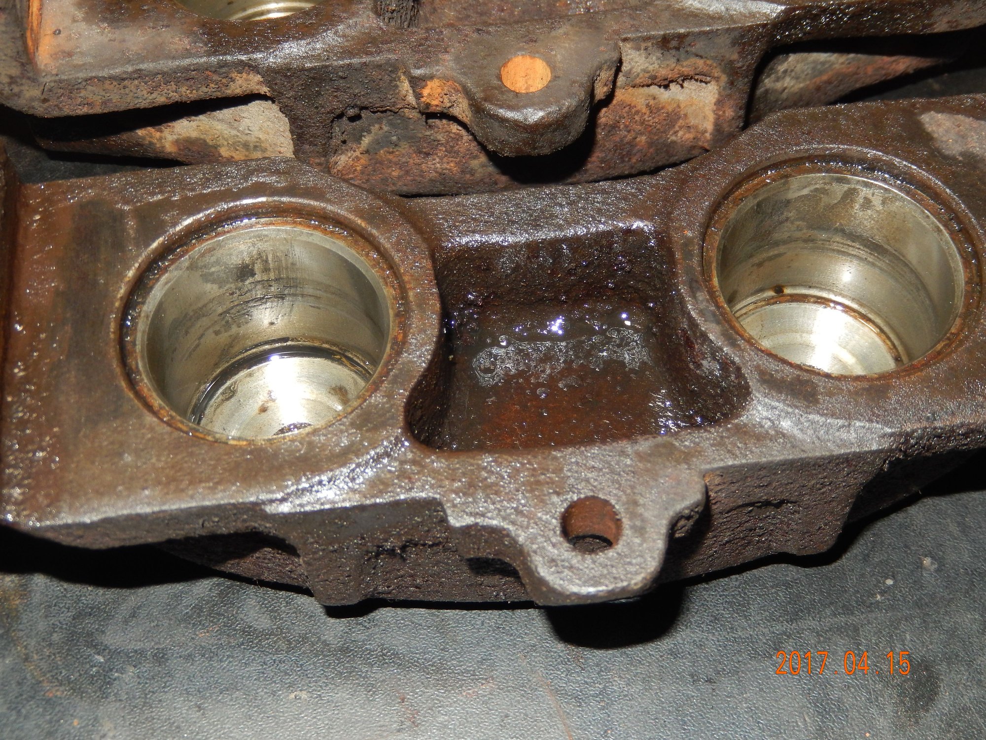

Here is pic of inside. Is this sleeved. I thought it was.

This what a Stainless steel sleeve looks like

Especially since they look like they spent the last 10 years at the bottom of a lake.

I still have the original calipers on my 70. I did rebuild back in the 90's with ZTI o-ring/alum pistons. No piston springs needed. No sleeving since the bores were decent. Just honed. Still operational. Your bores don't look bad to me. The leak appears to be on the outboard half of the caliper. The pistons seem rather corroded and that can become a cause of leaking from the seal around the piston. The bore seal can also be a leak area, but that seal is more prone to air pumping which is why the o-ring was developed in the first place.
ZTI was the original designer of the o-ring setup and I believe that company was bought out. Nowadays its easier to swap them out, or keep your originals and buy new ones outright. Just not much sense doing that, and the parts are more than likely more than what I paid..
