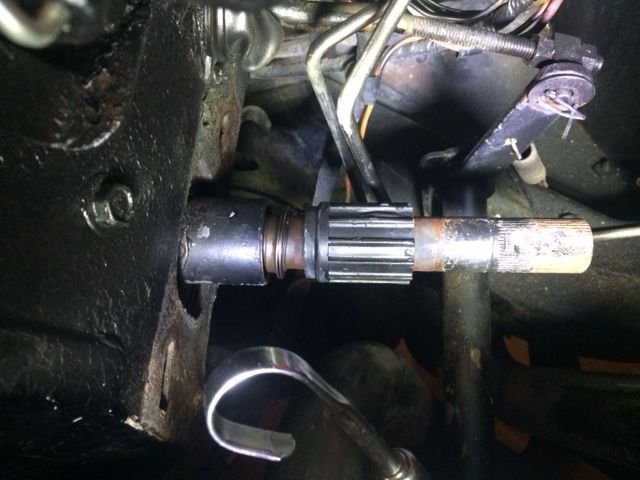

after collar has been moved down the shaft. Are the rings part of the bearing?
This is the gap created when pushing the shaft up

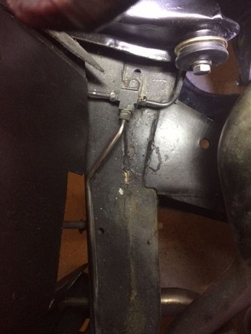

Do I need to move the break lines?
I am in the process of converting from factory manual steering to Borgeson power steering. It is necessary to shorten the steering column by an inch or so. According to the instructions and other thread I have read, the 68 column should be collapsible. I have tapped on the end of the shaft and watched the shaft move into the collar, thinking I have made progress. Then I looked at the cabin side of the column and noticed the entire shaft has moved out of the column. Is that supposed to happen? Do I need to remove the column to get it to collapse like it is supposed to? Is there anything to hold the shaft into the column? Does the clamp hold the collar against the firewall? When the shaft is pushed back down, are the rings supposed to be there or are they part of the bearing, and need to be replaced? Do I need to move the break lines? Can I simply unclamp and slide over or do I need to have them re-bent? Please help! I need some guidance.

Remember how old your 68 is, almost 50. From seeing what happened to the steer column my suggestion is to remove the column and take out the shaft. You'll need to inspect for damage from the column separating that way. 68 columns use some parts from 67 and is a 1 year only column. It's approximately 2 inches you need to collapse the column, when dissembled start soaking in penetrant fluid. Put a chalk mark about 1 inch from collapse point and collapse to that chalk mark. You can put it between 2 pieces of wood and use a hammer to get it to move [DO NOT GO TO FAR] also put the nut on the steer wheel end. Then reassemble column, install and make final shortening adjustment in the car. You don't need that clamp, that collar is on there I had to cut mine off and did not reinstall a new 1. My 6t8 got R&P, the 69 got the Borgeson, had to replace both upper and lower bearings [lower got an iolite bushing] on the 6t8. To get the column to collapse on the 69, it required a lot more that just tapping. Oh ya put grease on shaft before collapsing. Brake lines bend very easily, they should just need a minor tweeking, when doing my 69 with power brakes no mod was needed for the brake lines. T

Should there be a retaining ring on both sides of the upper bearing?
What holds the upper bearing in this casing?
Update...the column is now out of the car and somewhat disassembled. The upper and lower bearings are bad. It looks like I can find the lower bearing at Ecklers, but I have not found a source for the upper bearing. Any ideas where I can get one? The column collapses fairly easily, so adjusting for the new gear box will be a breeze. Once I put the new bearings in and adjust the column to the correct length, what keeps the shaft at the new length? It looks like if I pull on the steering wheel, the shaft sill simply expand back the factory length. Do I need to weld it at its final position?

No welding on shaft, it would not collapse if you did, it's a friction fit. Where have you looked for parts? The upper brg is also a friction fit, if loose in housing a locking agent could be used, might require very light tapping for install. When I received parts the lower brg was wrong, it's more like the 67 brg. You'll have to refer to an AIM regarding the snap rings. T
