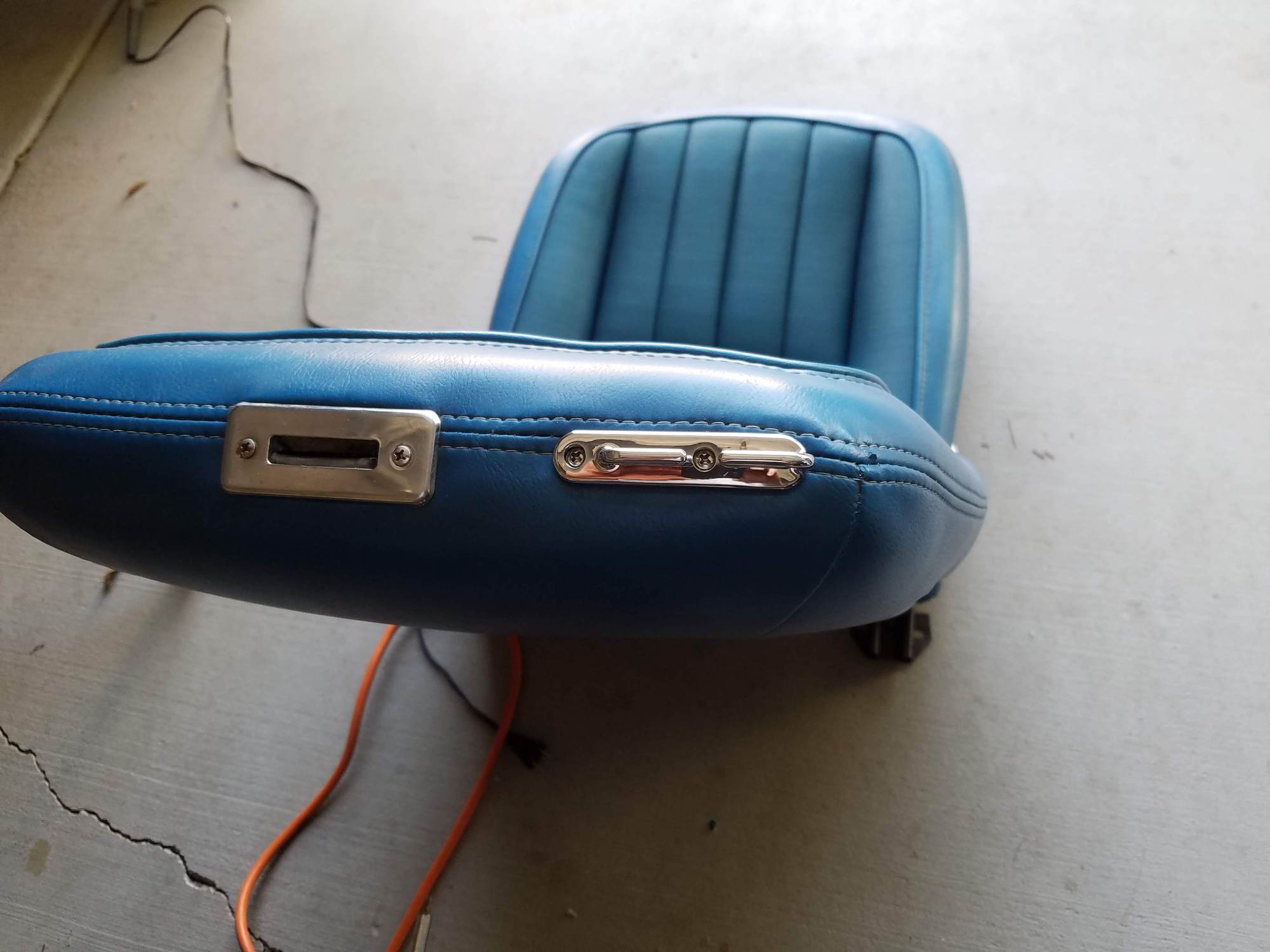

I'll wrap up this thread with my final update.
I sent the original set of tan shoulder belts I bought off ebay to Ssnake Oyl for restoration and color change to bright blue.
Buckles were rechromed, retractor bases were replated, covers were dyed, and new webbing was installed. I think they came out very nice.
Installation was straightforward, since the shoulder belt mounting point was there from the factory. The only pain point was cutting holes in the seat cover to install the belt guide. The mounting holes in the seat back were present from the factory. It was just a matter of finding them by feel, using an awl to make the initial hole, then trimming the hole bigger to let the guide sit flush and screwing it in place.
Passenger side is finished. Still working on the driver's side.
This was definitely not the cheapest way to add shoulder belts, but since I really wanted it to be factory correct, I'm very pleased with the way it turned out.

so, were the brackets between the top of each seat and the headrests already there or did you have to add them? My seats do not have them currently...

My 69 convertible didn't have the shoulder belt brackets either. I had to add them when I added the shoulder belt. $24.99 ea from Corvette America.
Installation was fairly easy, but I did have to chase the threads on the hole where the shoulder retractor goes. They'd gotten kinda rusty and corroded.

You can feel two dimples in the frame ,just under the head restraint. An awl will get you started.
then a little X over the hole when you find it. They aren’t screws ,they are small bolts. You can
order the correct ones . I got mine a Zips. Not fun poking holes in the seats . And the head rests
wont go down all the way after they are on there. Good luck.

I had just recovered the seats so I measured the distance to the first hole. That made it less scary. You can feel it through the cover. Punch the first hole. Install the first screw in bracket and then the second hole is already lined up for you.
