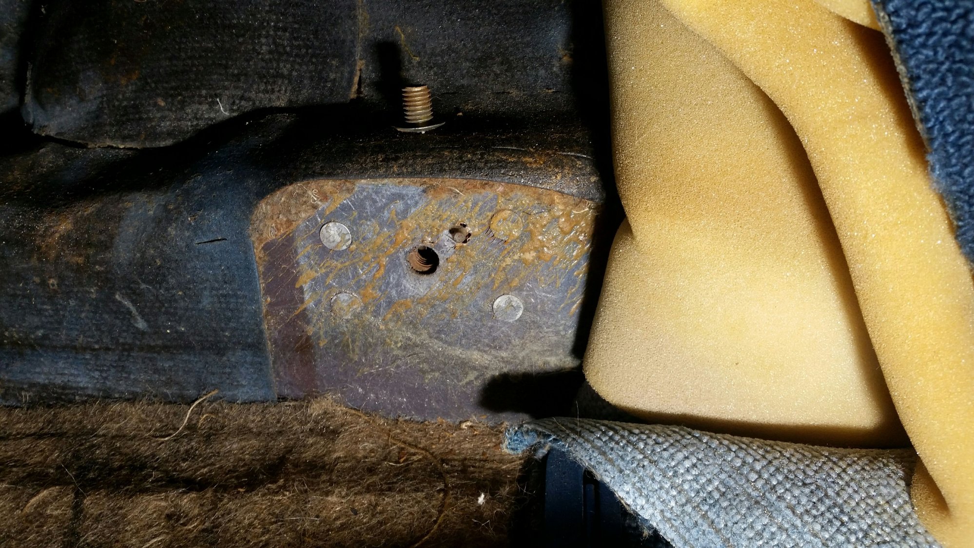

Well, the first hurdle has been cleared. I located the mounting point for the shoulder belts. Pulled back the rear wheel well carpet and found the mount, plugged with a plastic screw. That's a relief, because adding the reinforcement would have been a PITA.
So, even though very few 69 convertibles were outfitted with option "A85 - Custom Shoulder Belts", it appears the factory installed the mounts anyway (at least as early as my car's July '69 build date).

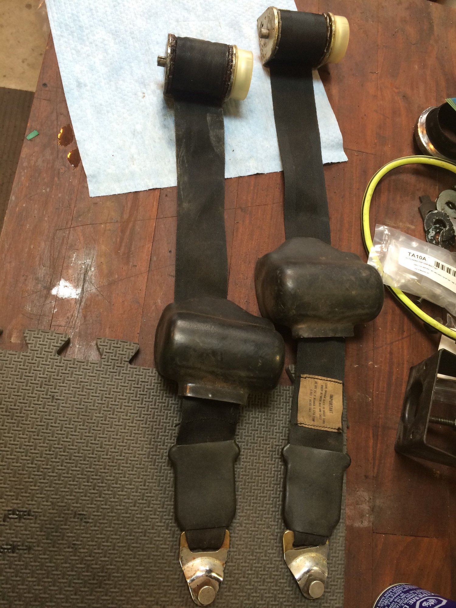

I did source a set of original '69 shoulder belts. Going to have to have them refurbished with blue webbing and dye the plastic parts. Then, need to buy and install these...
