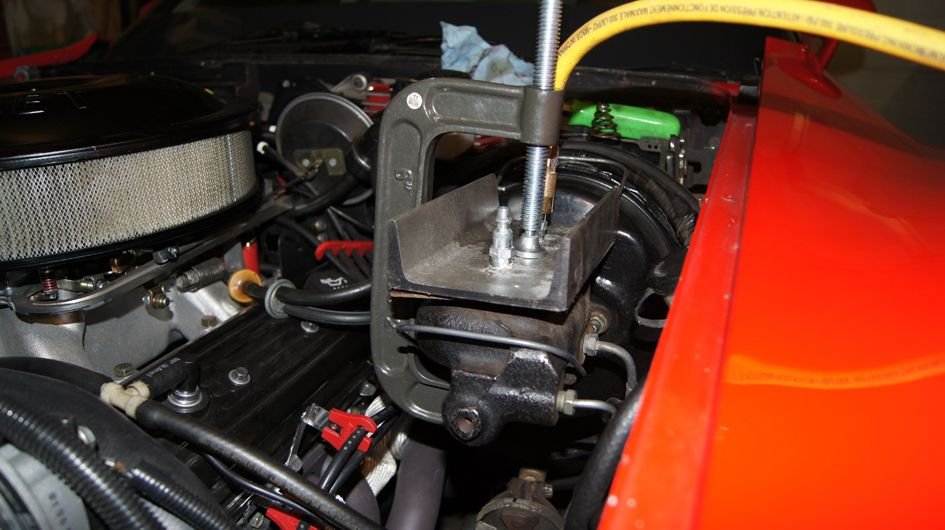

I made my pressure bleeder out of weed sprayer since I didn't want to wait for one via order. I was going to replace it later, but it works so well that there is no need.
It was cheap and I got it at the local hardware store. I used an aluminum plate, rubber gasket made out of old inner tube, with the typical valves, and a c-clamp to hold it on. It's worked great for years and I've used it on multiple vehicles. Just add brake fluid to the weed sprayer vessel, hook up tygon tubing, pressurize to about 10 psig.... bleed away.
Not only that but I can actually release the pressure before disconnecting the hoses to the pressure plate. Here's an old picture.
