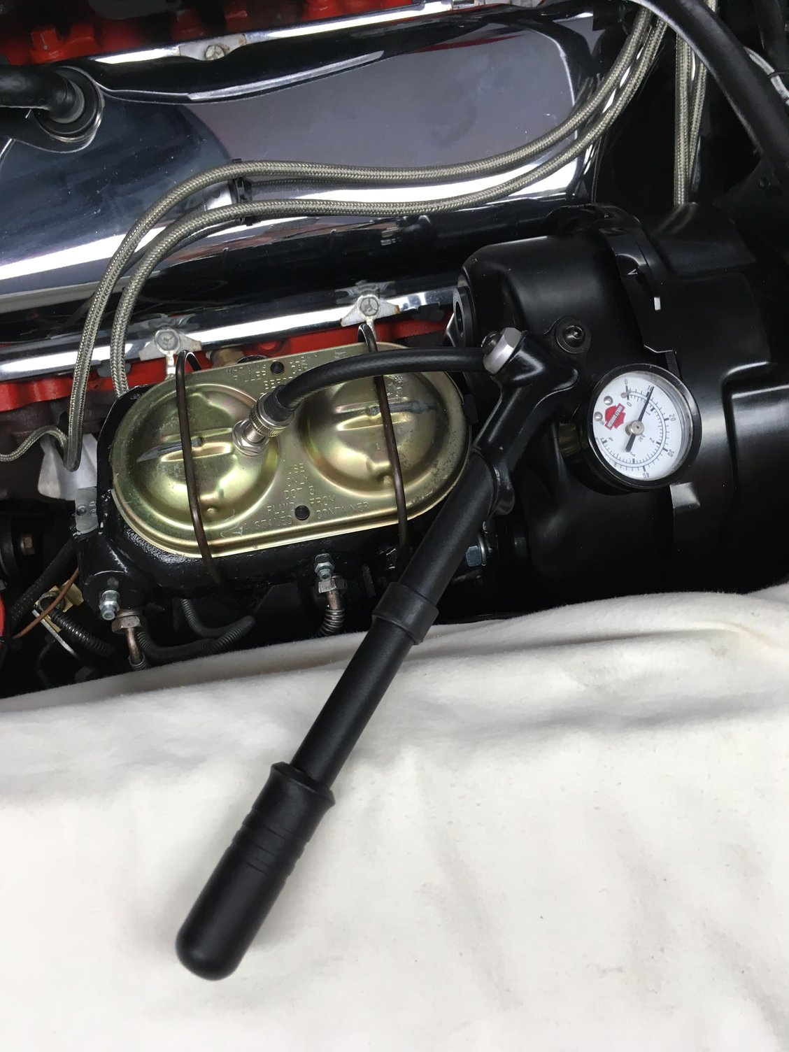

I'm trying to finish up redoing the brakes and based on reviews here I also ordered a a Motive bleeder when I ordered my parts.
I'm confident I can get it to seal after I go buy another big C clamp, but once you get it bled where is the fluid in the tube supposed to go when the cover is removed since the MC is now over filled? How do you use it without spilling brake fluid?
Ernie

I sent the Motive bleeder back and borrowed the schrader valve idea. The valve does have to be installed through the rubber gasket. Used my air shock pump from my Harley, works perfect.
New MC, booster, pressure switch, calipers. Did not realize how bad my brakes were before!

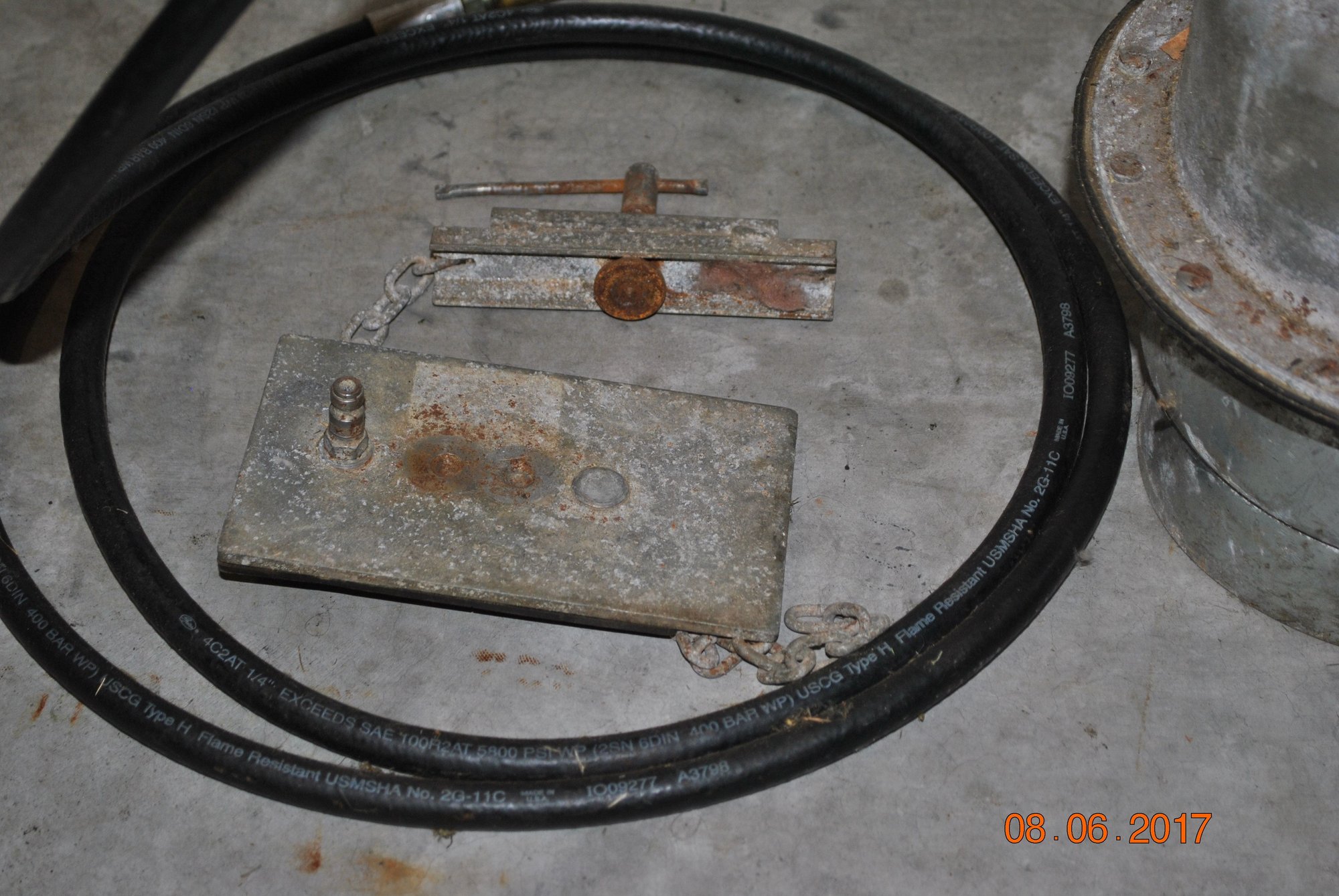

Reviving this thread......
I just had the camera out, so I dug out my "old" pressure bleeder. Maybe this is similar to the one that "DUB" uses.....
To Power Bleeder question
I have the EXACT CLONE to this pressure bleeder. I mean EXACTLY the same.
I would die if it stopped working for me.
I have another pressure bleeder that is a different design but does the same thing... for the DOT5 cars that I have to work in from time to time.
DUB
DUB
I haven't used mine in quite some time. I pulled it out of the box, out in the garage, and was surprised how "dirty" it had gotten. I'm rather embarrassed by it's condition...
What it looks like on the outside means nothing....it is the condition of the area where the brake fluid goes is what matters.
Yeah..I must say mine looks a bit better...but HECK..I have been using it for over 30 years.
DUB
