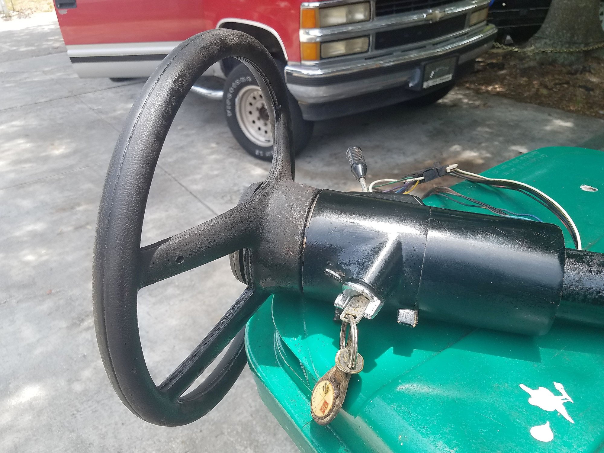

Before refurbish
After refurbish. The pictures to follow show exactly the combination of components for the steering column.
Cant wait to use this for its original purpose.

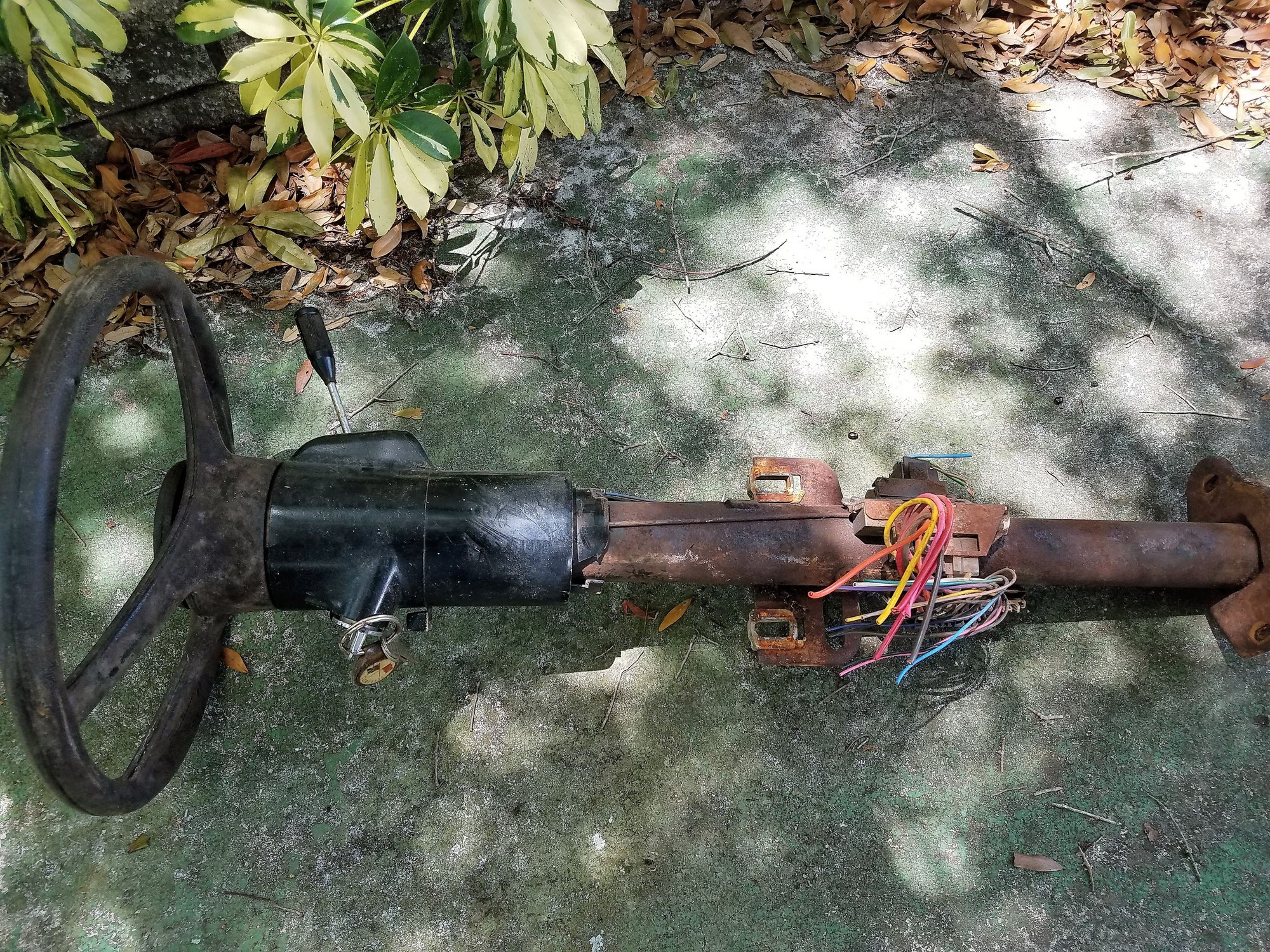

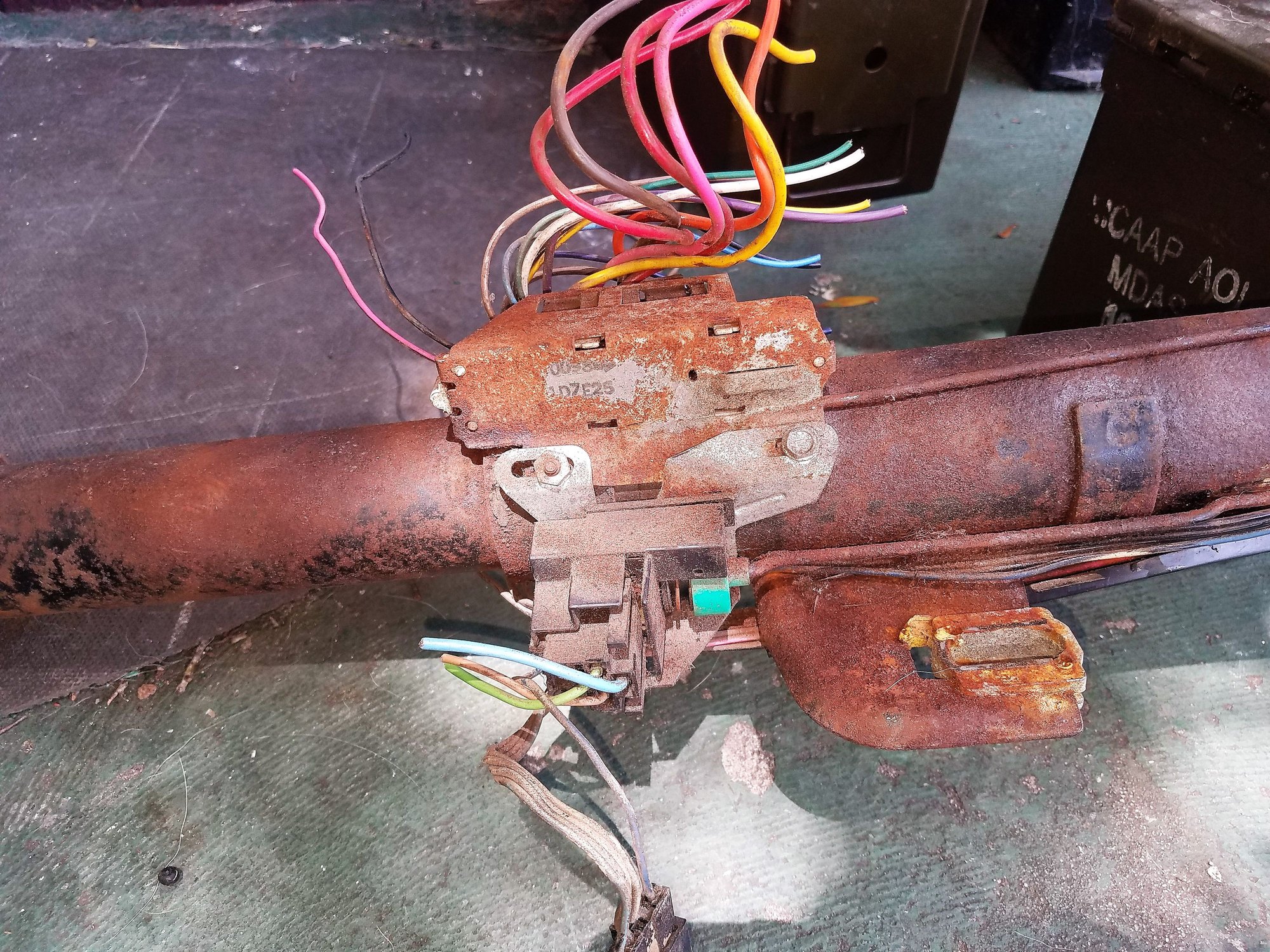

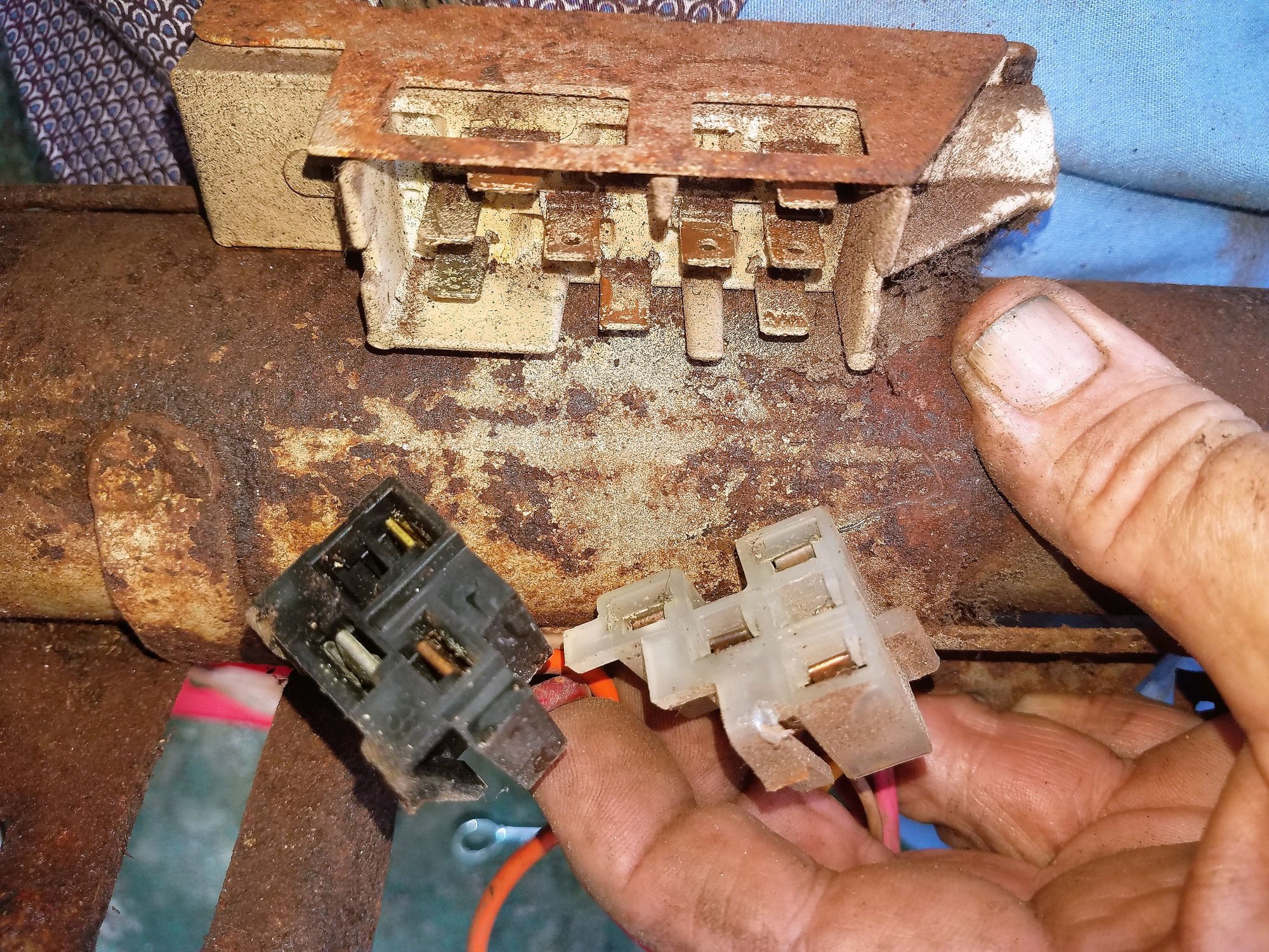

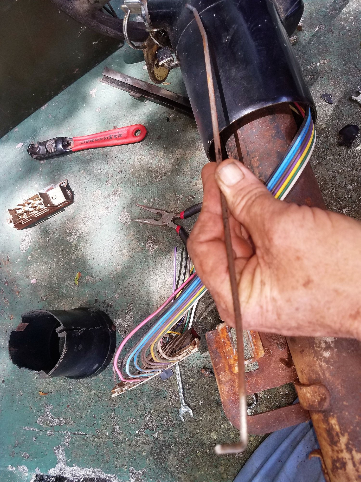

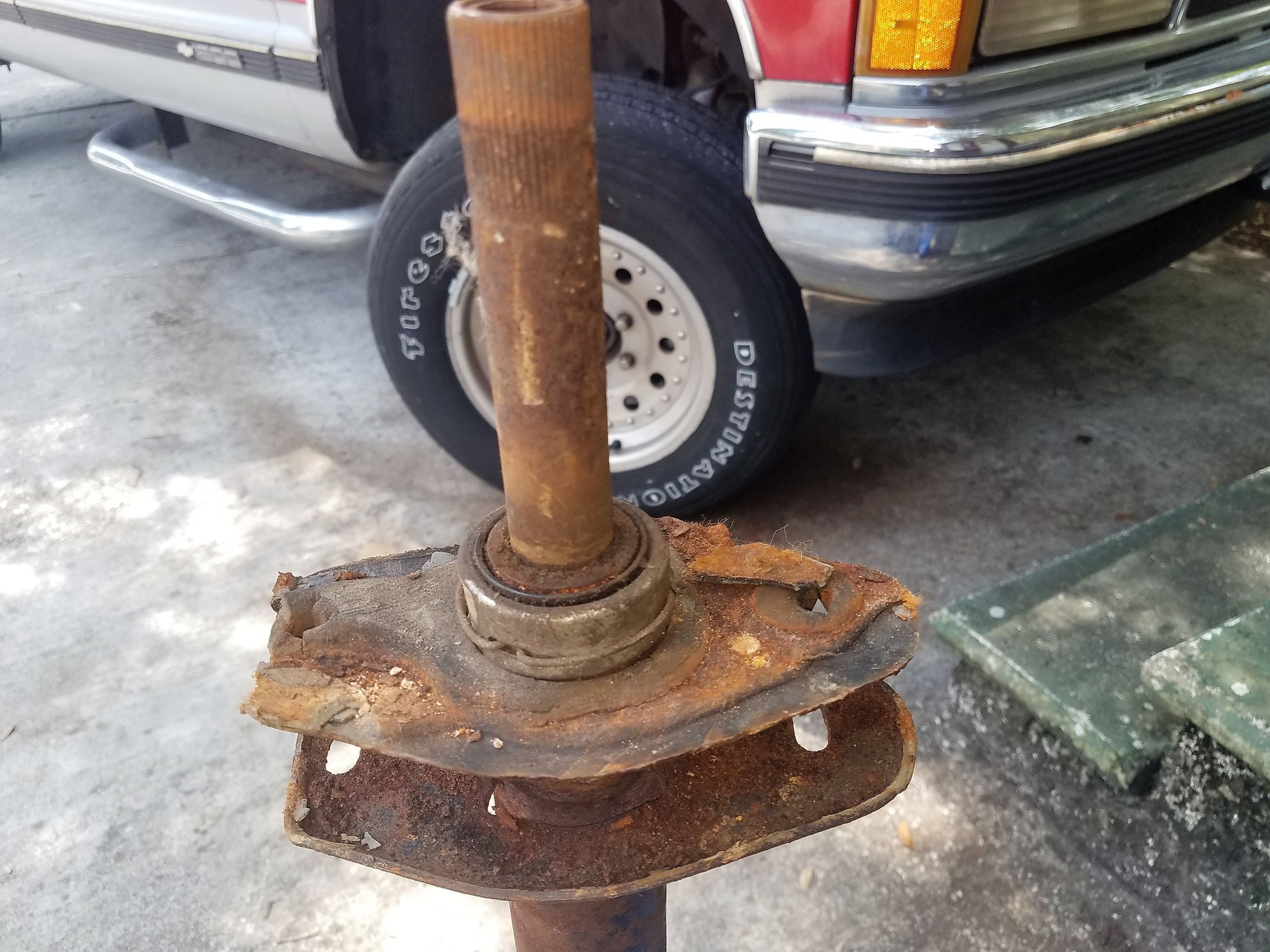

Spline and bracket assembly.
Two plug electrical brackets removed from column. Locking starter rod removed.
Little green cap leads locking rod o switch for key activated locking mechnisim.
Close up of two brackets and plug assemblies.
Separated switch,bracket and starter/key locking rod.
Another look at previous condition.
Close up of components.
Another view.
Wiring receptacle component removed from metal bracket. Also wire covering cowl.
Sub cowl plastic piece.
Plugs and plastic recepticle from metal bracket attached to column.
Close up.
Another view.
Removing starting locking rod.

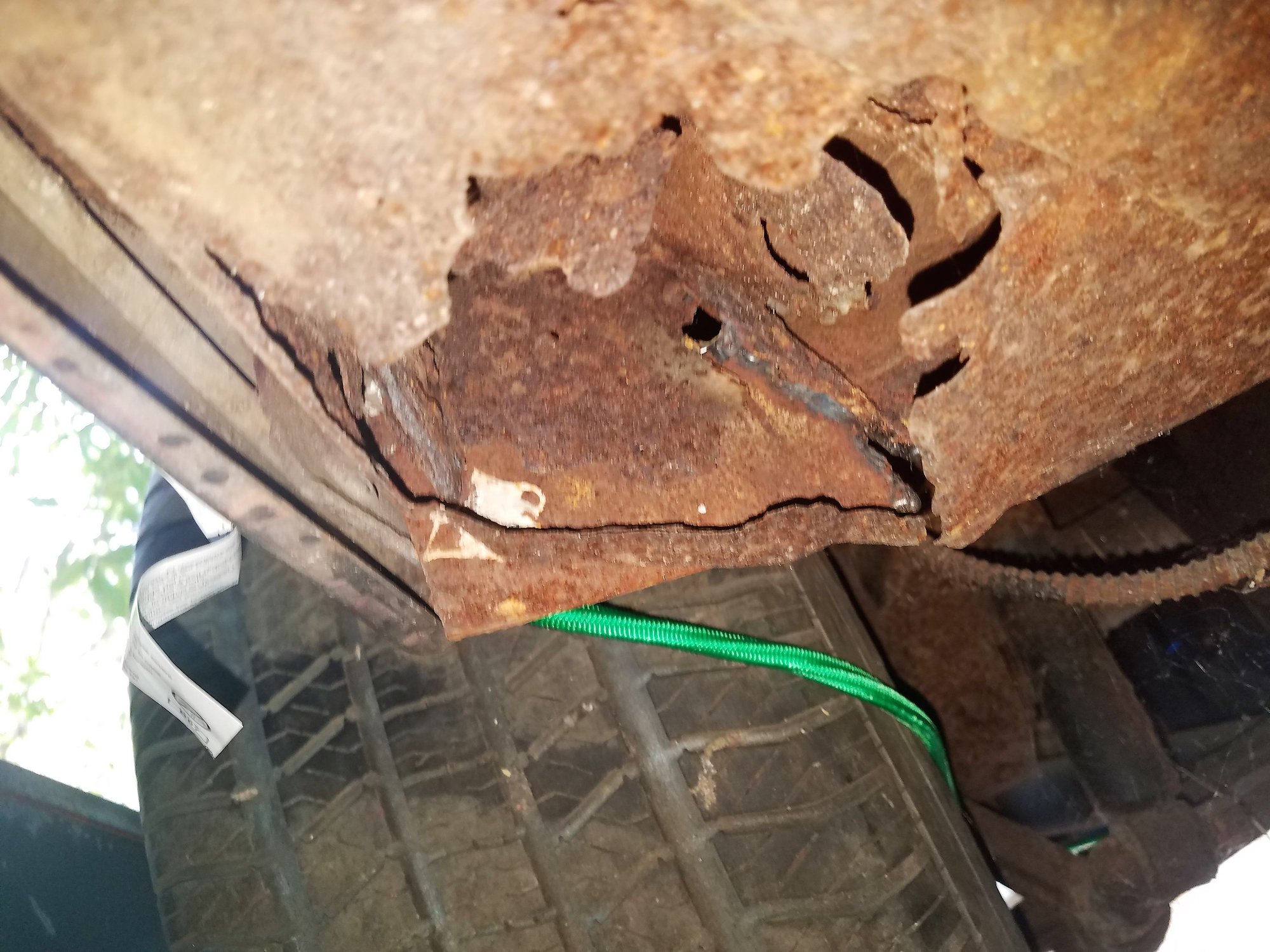

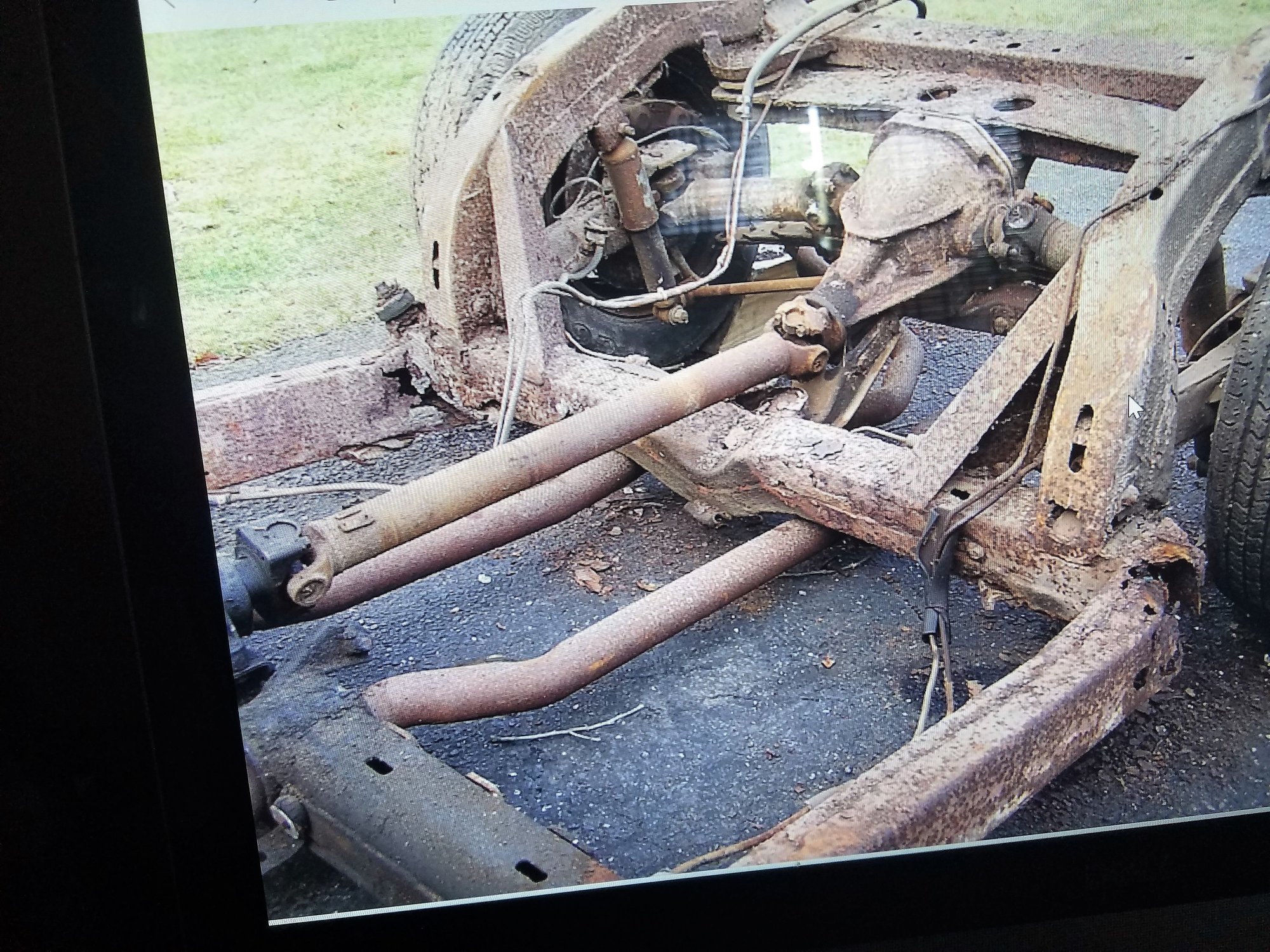

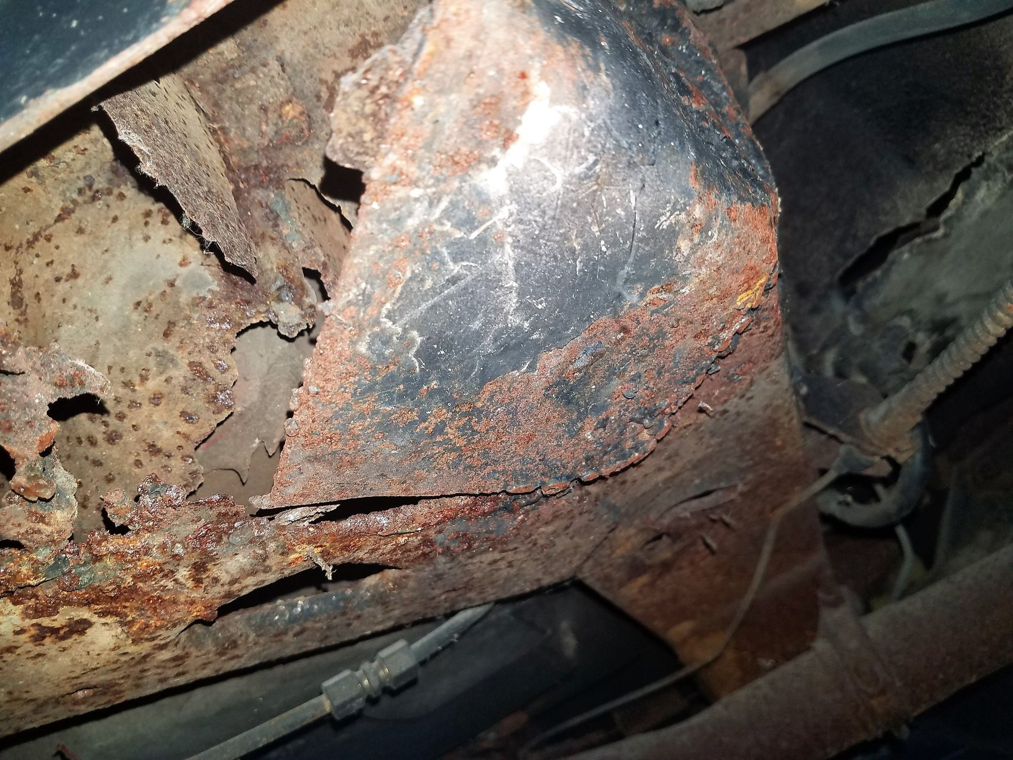

Although I have been generally pleased with everything. The one area of fear was the area right in front of the rear left wheel. As illustrated in the next following pictures, it shows OTHER Corvette issues which illustrates a weak point or common area of other Corvettes as well as mine. Again, the next few pictures are of OTHER Corvettes.
Old Jun 1, 2017 | 04:42 PM
  #65
Skyfall7's Avatar
Skyfall7
Joined: Feb 2013
Posts: 110
Likes: 9

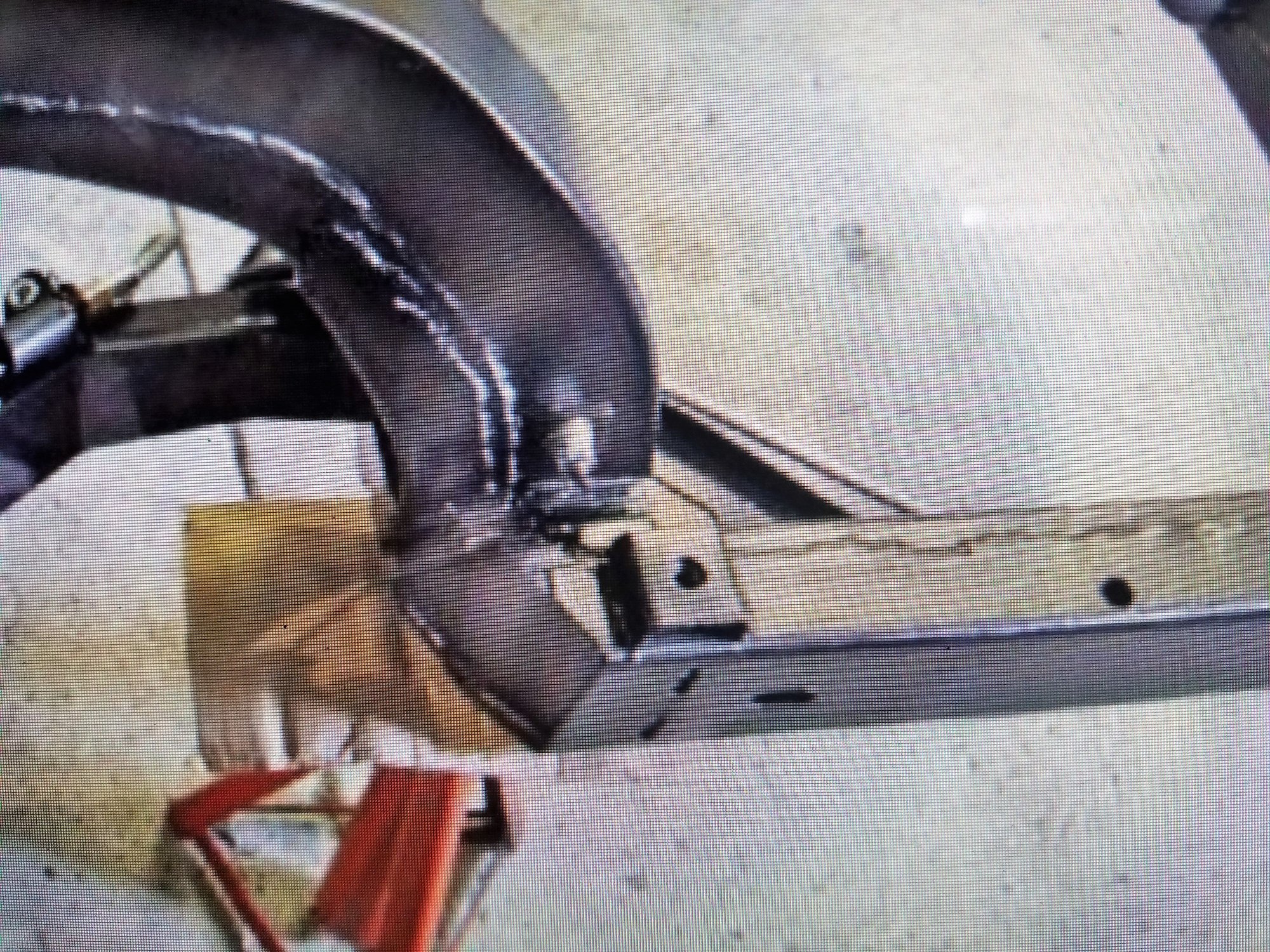

This is a close up example of ANOTHER Corvette, not mine. As you can see, seems to be a weak spot at the rear corners of the frame at the 90 degree joint points.
This picture illustrates the weak area on both sides. Unfortunately, as you can see on the upcoming pictures of my Corvette, mine has the same problem.

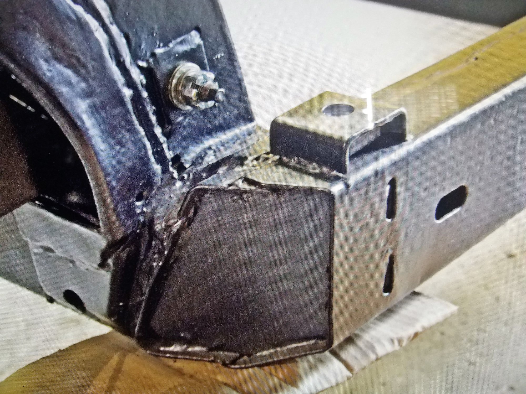

The same area with no damage.Again, all these pictures not my Corvette.
Good example of good solid frame. I will have to remove body to properly reenforce and refurbish frame of mine.
Close up.

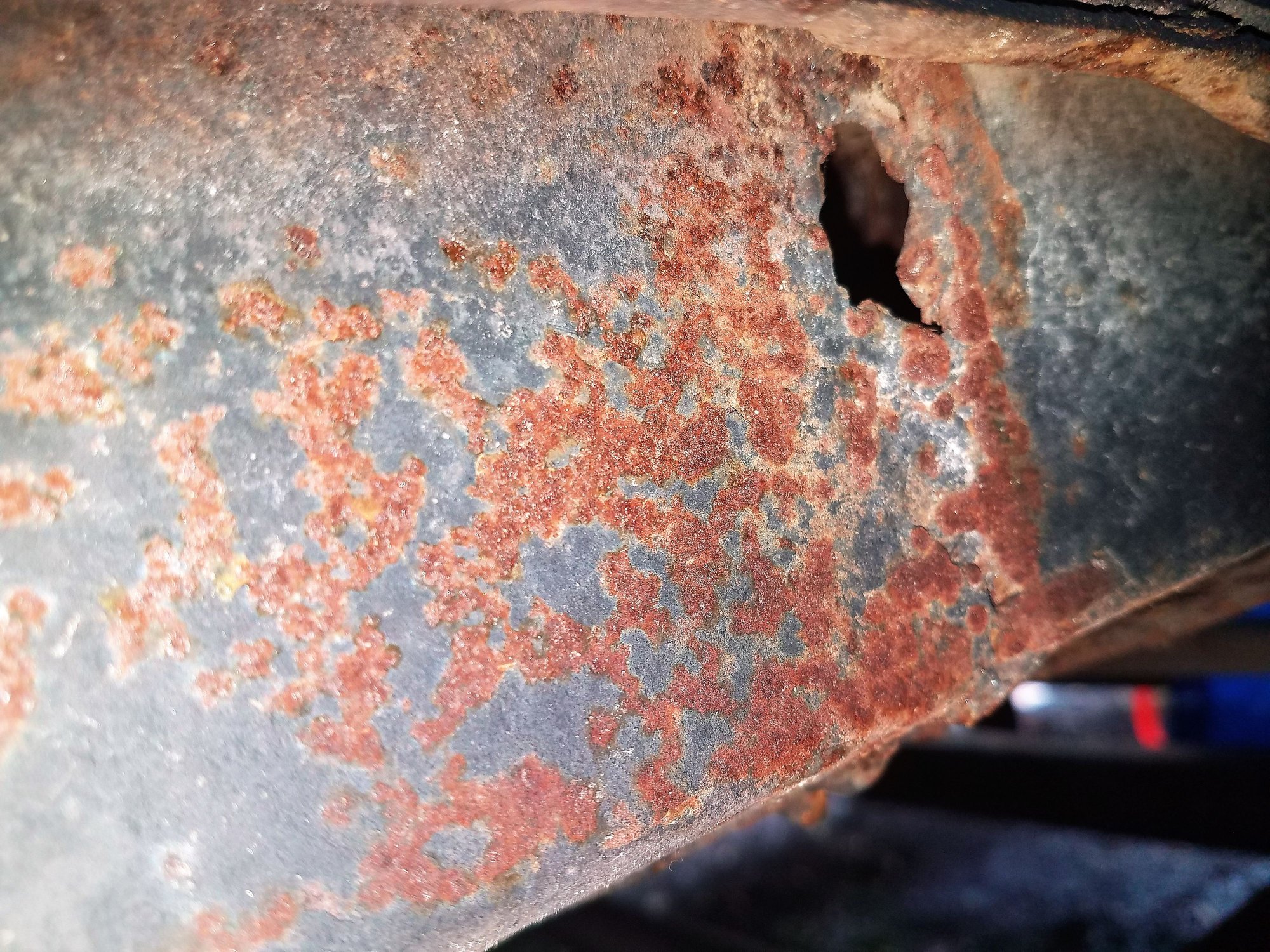

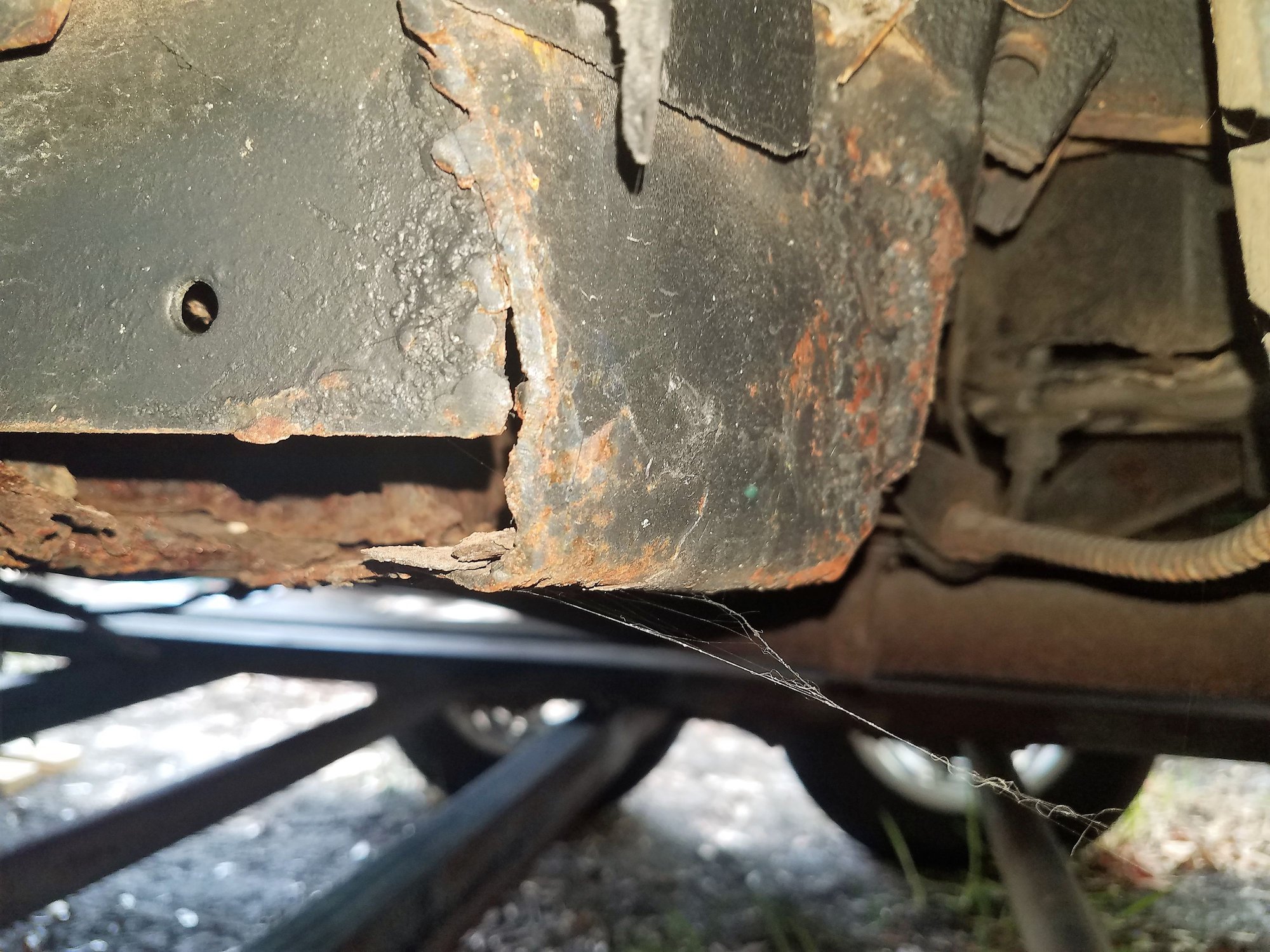

Left back side of corner of frame.
Another view
Oh yes, Houston we have a problem.
Looks like this was fixed before.
Yep
Total body removal in store for the future now. Got to refurbish entire frame.

Default Same deal on the right side.
This fits into my total refurbish plan also. This will make me take the body off, leaving just the frame. I can concentrate on fixing it right. Also, work on the other major components-motor/suspension/brakes.

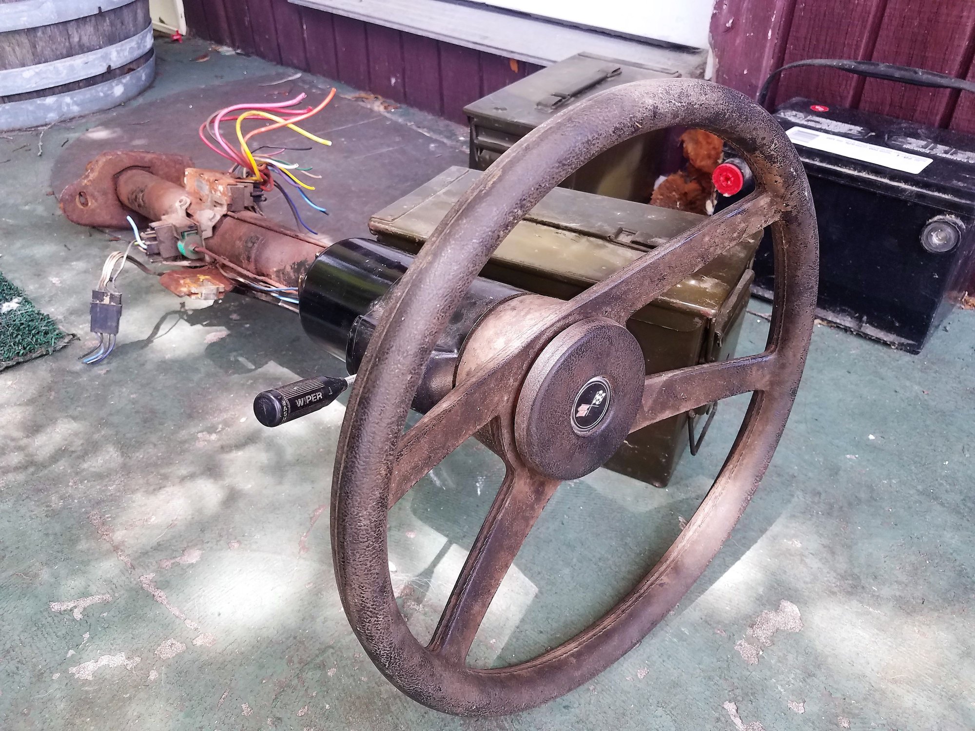

Wow , I think that steering column may have been submerged in water.

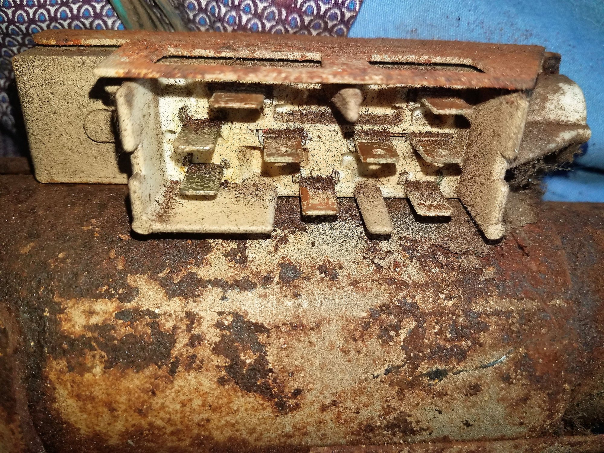

Another view.
Good work on your steering column...
That switch with the green plunger appears to be a headlight dimmer switch.
I believe the first year for the column mounted dimmer is 1977.
Also, the turn signal lever looks like it also controls the wipers.
This is also a feature unique to 1977 models.
