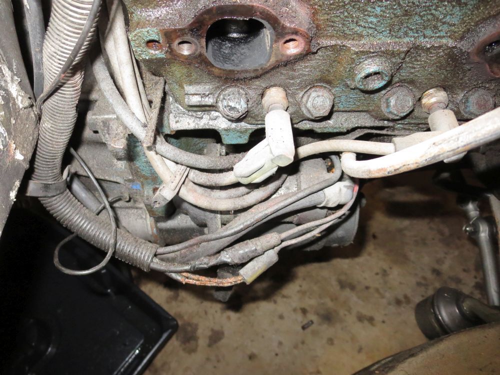

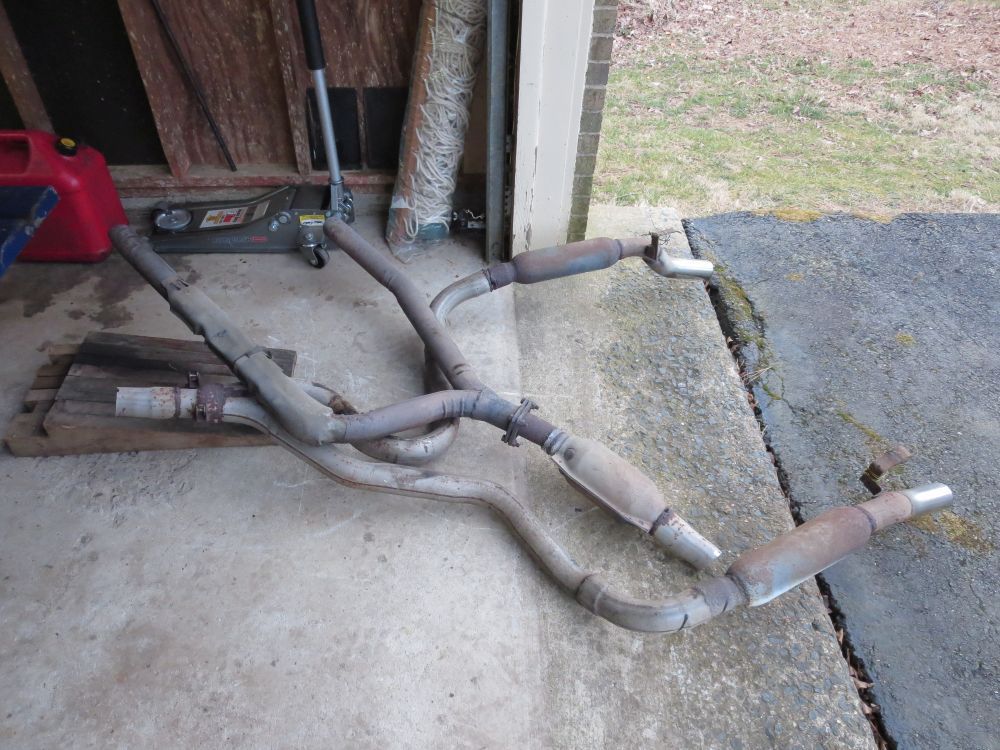

Spring started this afternoon! Let's hope it holds for a while. So while it was warm enough to work in the garage, I did as much disassembly as I could without taking off the front wheels.
Front sway bar is off. Pitman arm is off of the steering box. Exhaust manifolds are off (with a working 2" heat riser and actuator, if anyone needs one). Let me just say, I am really glad I had the Kwik-Lift for this task. The heat stove on the drivers side blocks the two center bolts, so I had to disassemble that first. 7mm screws! You can see one in the picture. The AIR pipes were remarkably intact. No gaskets, these may never have been off the car.

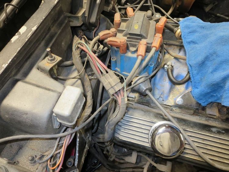

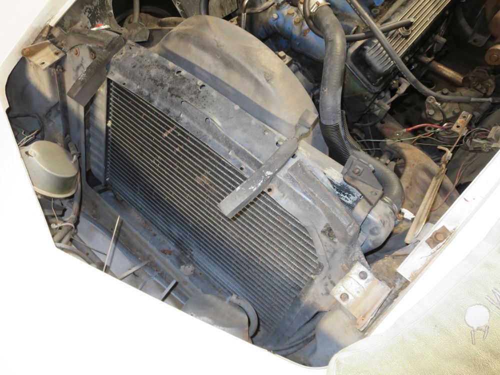

With stuff out of the way, there's a surprising amount of room in the engine compartment. I'll have to do something about the wiring to the starter. It looks like some of the fusable links have completely melted off their insulation. Now is also a good time to replace any other dodgy wires, and to cut out all of the AC bits.
Does anyone have any thoughts on these images? The plug in the head mirrors the location of the temperature sensor in the driver's head, so I may put my fan switch there. Also, now is a good time to change the valve cover gaskets. The old ones appear to be leaking a bit.

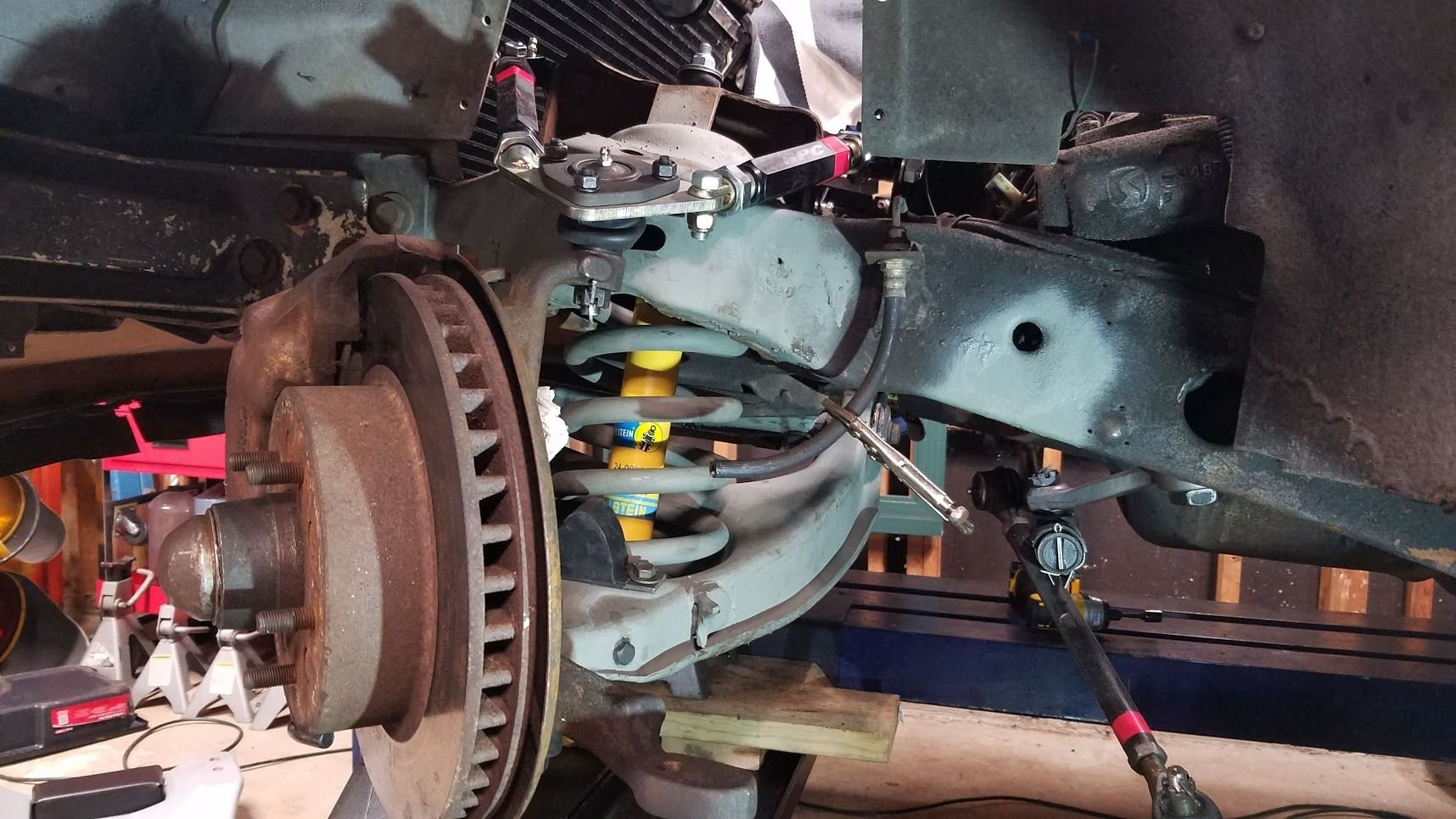

Now that I have the complete front suspension in place, I have upgraded the car to what she would have come with (or better) with the ZN1 package, except for two things: I don't have the better radiator (I'll get a DeWitts if I need it, but I haven't needed it yet), and the trailer hitch.

I finished the front suspension and bled the brakes again. She's back on her wheels, but still on the Kwik-Lift. I have her steering column out now so I can swap out her steering box. I am also tweaking the column a bit, at least regreasing the lower column bearing. I replaced the one in my wife's 79, but this one isn't nearly as bad.

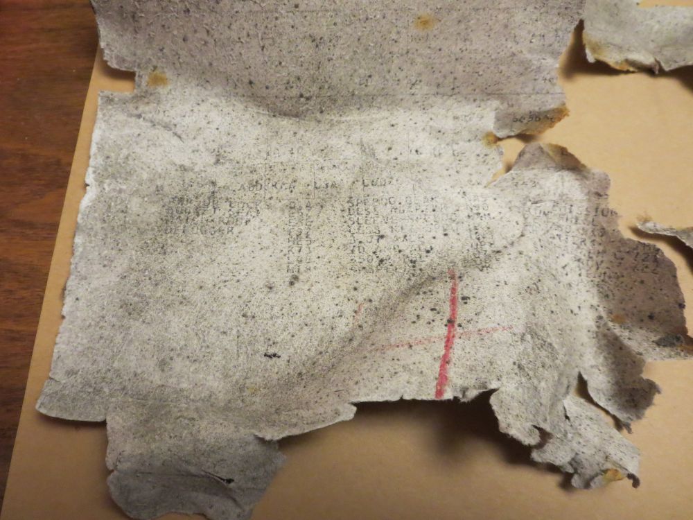

I also retrieved her build sheet, which was just hanging there. It confirms that she was an L48, 4-speed car, with a red interior. The exterior color is still stuck to the tank on a silver-dollar sized dollop of glue.
Sadly, no evidence of the FE7 gymkhana suspension or the ZN1 trailer package (which I knew to be the case, but I looked anyway). Also, the destination dealership was completely unreadable. The options were only barely readable.
Brother, I can identify with where you are in the project. I bet it will not be too much longer before you are done with this phase of mods.
Your finding the build sheet is a great bonus, and readable to a good degree. I have mine, the PO salvaged it, unfortunately it’s mostly a black sheet of paper. I have thought about scanning the document to see if the scanner can pickup some detail my eye cannot see.

I'll try the scanner idea. It came off in two crumpled chunks. I'm flattening them out now.

It appears to me that you need valve guide seals from the way oil is baked on the exhaust valve. Since you are going to replace the valve cover gaskets and you have a lot of parts out of the way, this would be a good time to do it. You'll need a spring compressor and a fitting to put air into each cylinder as you take the springs off to keep the valves from dropping in the cylinder. The umbrella seals will work fine.

I have the plugs out now. I'll try to post a photo, but they are as black as you'd imagine. One probably wasn't firing at all.
The fusable links are without insulation in that image. I ordered a new L82 starter extension harness, thinking that I could get that plug out on the head. Even with Kano Kroil and an impact driver, it won't budge. I'll try some heat next, but I may have to put the switch for the Spal fans on the intake instead.
