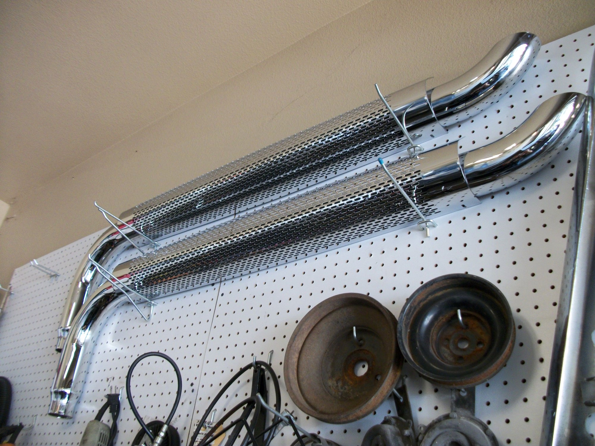

I went from these to
these
I was not looking for last ounce of HP just looks and sound. Factory 2 1/2 Manifolds -- 2 1/2 Stainless Chambered with Crossover Pipe.
Personal Preference
Here some info on my install Click Here
George
