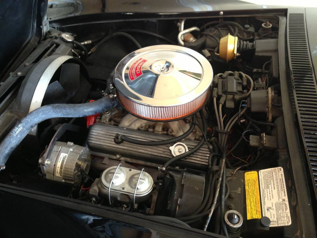

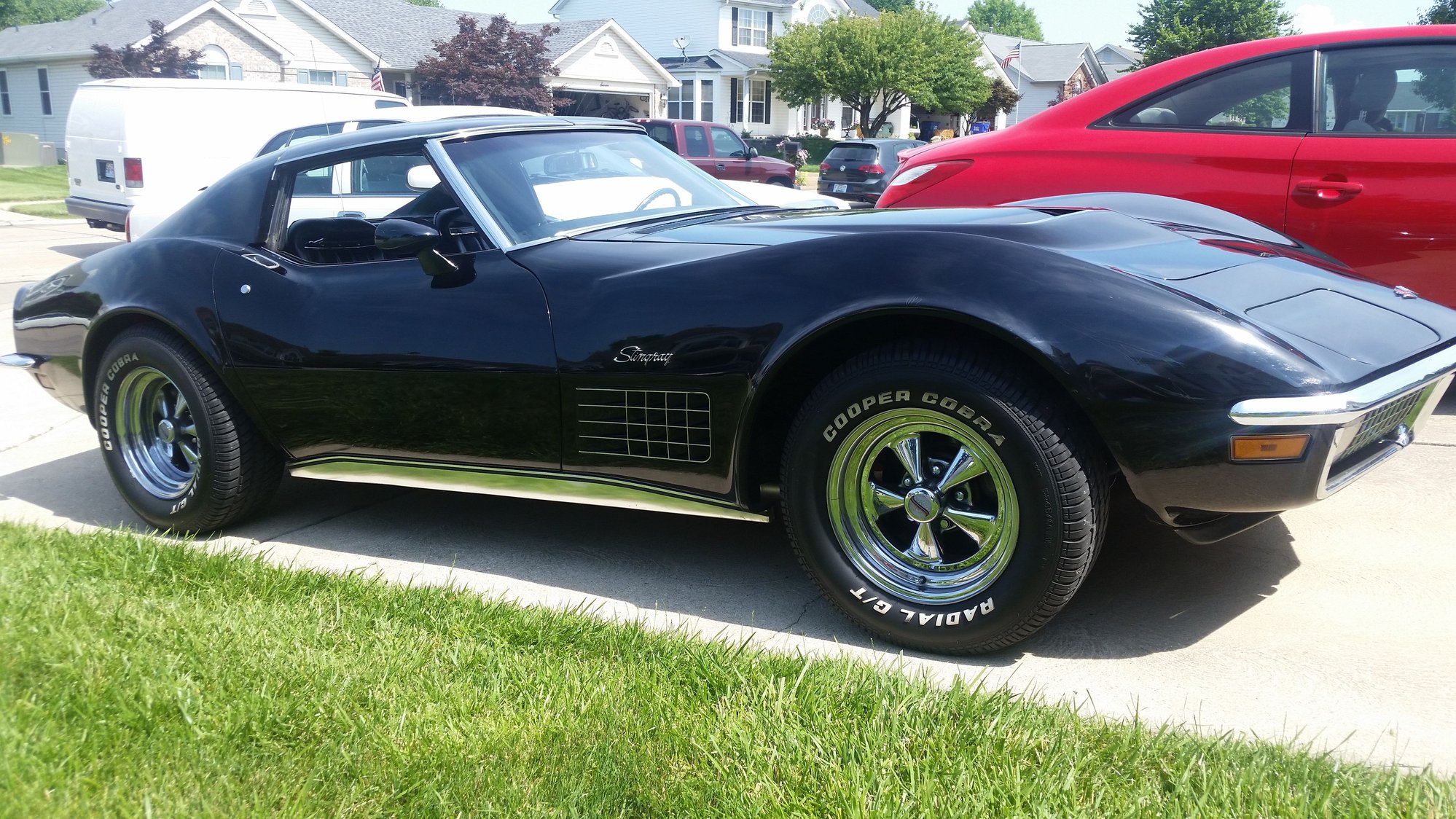

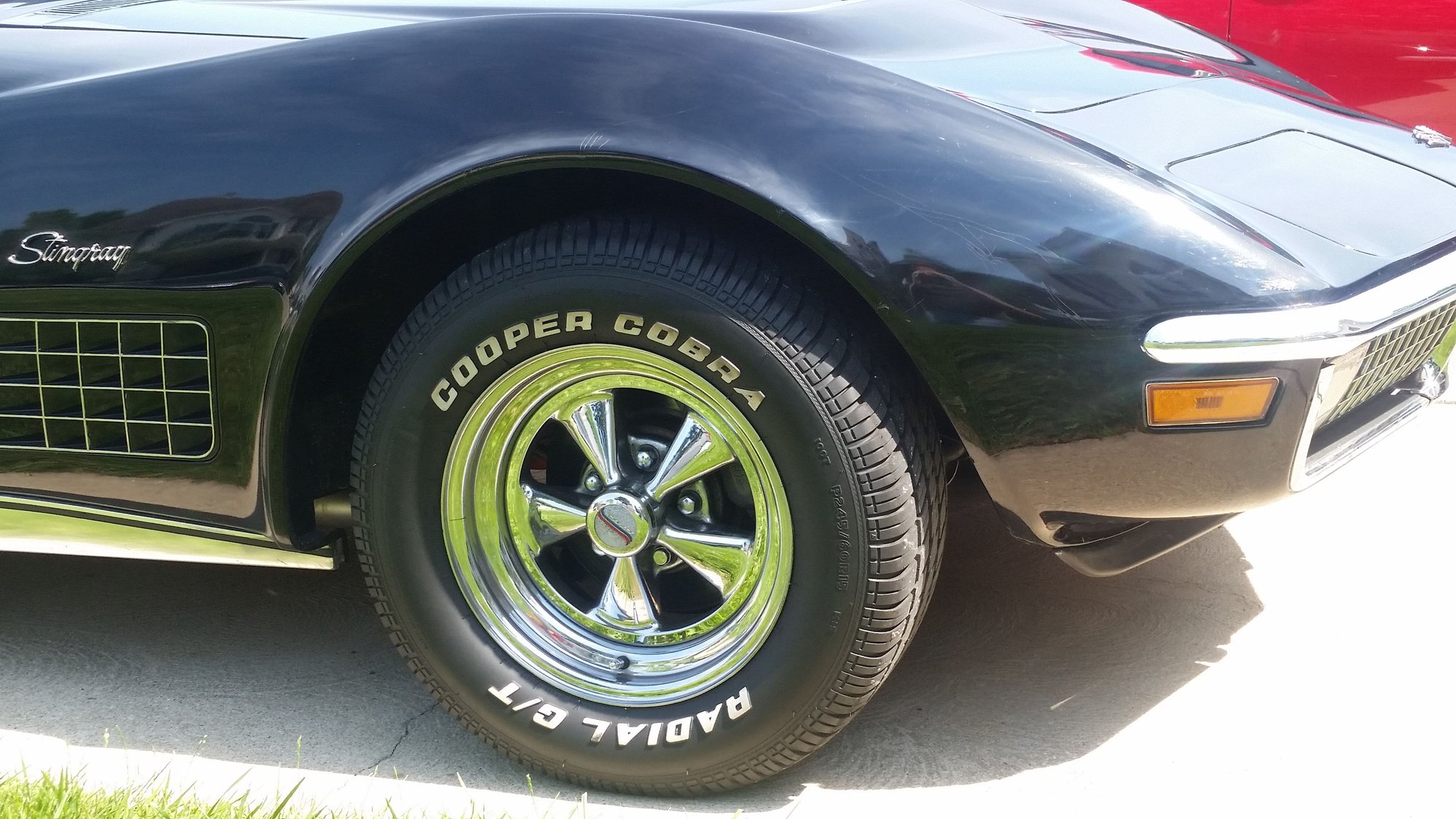

Funny how a car can look great in the ad, then in person .. oh well. The asking price of 22,500 is what caught my attention. The car was originally Steel Cities Gray which I would have preferred but was painted in black lacquer over 20 years ago. Actually the paint looked great. Very straight body panels. It was also an L-46 when new. The front was high because it had big block springs in it. Well, on to the next possibility.
60 series tire and BB springs raised the front.
Made to look like an LT-1
To Looking at a '71
