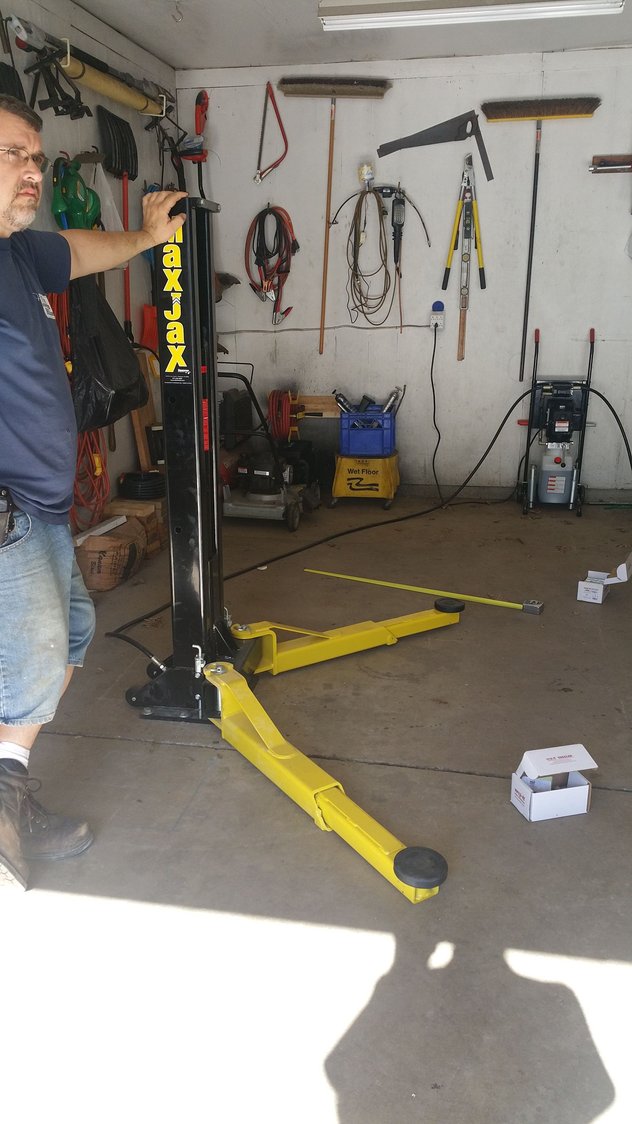

The shortest 2-Post standard lift on the market is Mohawk who makes a 2-Post A-7 model that is asymmetric, you would need to run the Hyd. lines in the floor vice the top. Pricey and still a tight fit.
http://www.mohawklifts.com/wp/compan...de-in-america/
The simplest is the Dannmar MaxJax Portable 2-Post Lift, never seen or tried this setup but it seems to fit the bill for low overhead and the home garage.
http://www.maxjaxusa.com/buy-purchas...d-package.html

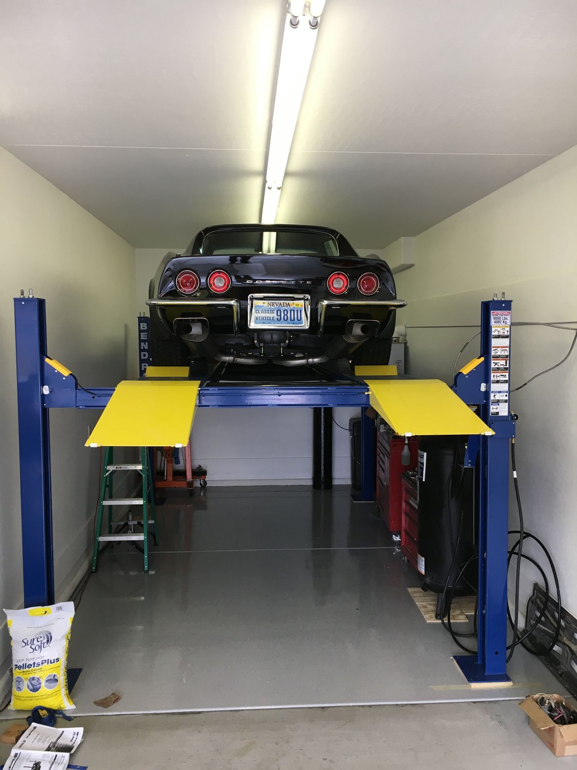

Bendpak in my garage. I also have the RJ 45 rolling jack. 10' of ceiling ht, so I can lift the corvette to maximum ht of the lift, 5'10" from the lower edge of cross rail to floor. Its the 9000 lb model. Cost about 3200 delivered, not including the RJ.

My buddy just got his,,and we can also set it up at my garage too, Check them out, I'm liking it a lot

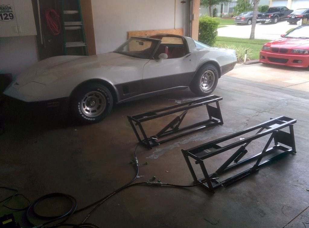

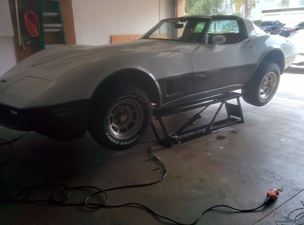

I just got this Quickjack this past week. Still have to lay down, but they store up out of the way.
