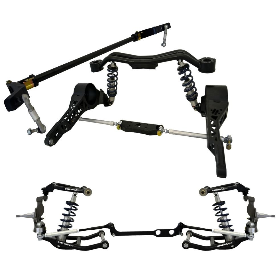

Our complete coilover kit for the C3 Corvette will suit your needs perfectly. We spent quite a bit of time fine tuning this kit to make it handle like a new Corvette. Our package contains front upper and lower control arms, tall spindles, billet steering arms, inner and outer tie rods, front MuscleBar, rear trailing arms and 4 HQ Series Coilovers (that come with our 1,000,0001 mile warranty).
· The Upper StrongArms feature corrected ball joint angles for the tall spindles. The upper ball joint have been moved back to allow for additional caster setting to improve high speed stability and steering feel. Offset slugs are also available for additional caster. Injection molded Delrin bushings with 13% Teflon are used to reduce deflection and stiction.
· Lower StrongArmsfeature a double sheer lower mount for increased strength. We have also dropped the lower shock mount to increase suspension travel and moved the lower ball joint forward to increase caster settings while keeping the wheel centered in the wheel opening. Injection molded Delrin bushings with 13% Teflon are used to reduce deflection and stiction.
· The TruTurnSystem includes tall spindles which induce more negative camber gain to maximize tire contact patch during cornering. It also include billet aluminum steering arms, center link adapter, tie rods and adjusters to virtually eliminate bumpsteer, correct Ackerman angle and allow for wider tires. This spindle is designed for use with 1967-1969 Camaro brake systems. Use Coversion kit part # 11529595 to utilize stock Corvette brakes.
· HQ Series CoilOversutilize an impact forged aluminum body and Monotube design to deliver excellent ride quality and handling. They allow fine tuning of the ride quality and handling the rebound **** is located at the top of the shock for under hood access. They come standard with a 1,000,0001 Mile Warranty.
· The Front MucleBar is a splined design and helps reduce body roll and creates room for wider front tires. It includes the PosiLink endlinks that provide immediate engagement between the chassis and control arms.
· The Rear StrongArms are offset for increased tire clearance and are fabricated into a truss design for maximium strength and minimum weight. They feature R-Joint rod ends at the front mounting point to reduce stiction and roll bind. Also incorporated is the adjustable coilover mount, conveniently locating them behind the axle for easy adjustments. The upper coilover crossmember simply bolts in place of the stock cross member. The strut rods are outfitting with R-Joint rod ends to combine the best qualities of low friction movement, lateral stability, full range articulation, and quiet operation into one special bearing that is as home on the street as it is on the racetrack!
Check it all out here - https://www.ridetech.com/products/su.../product-3292/
