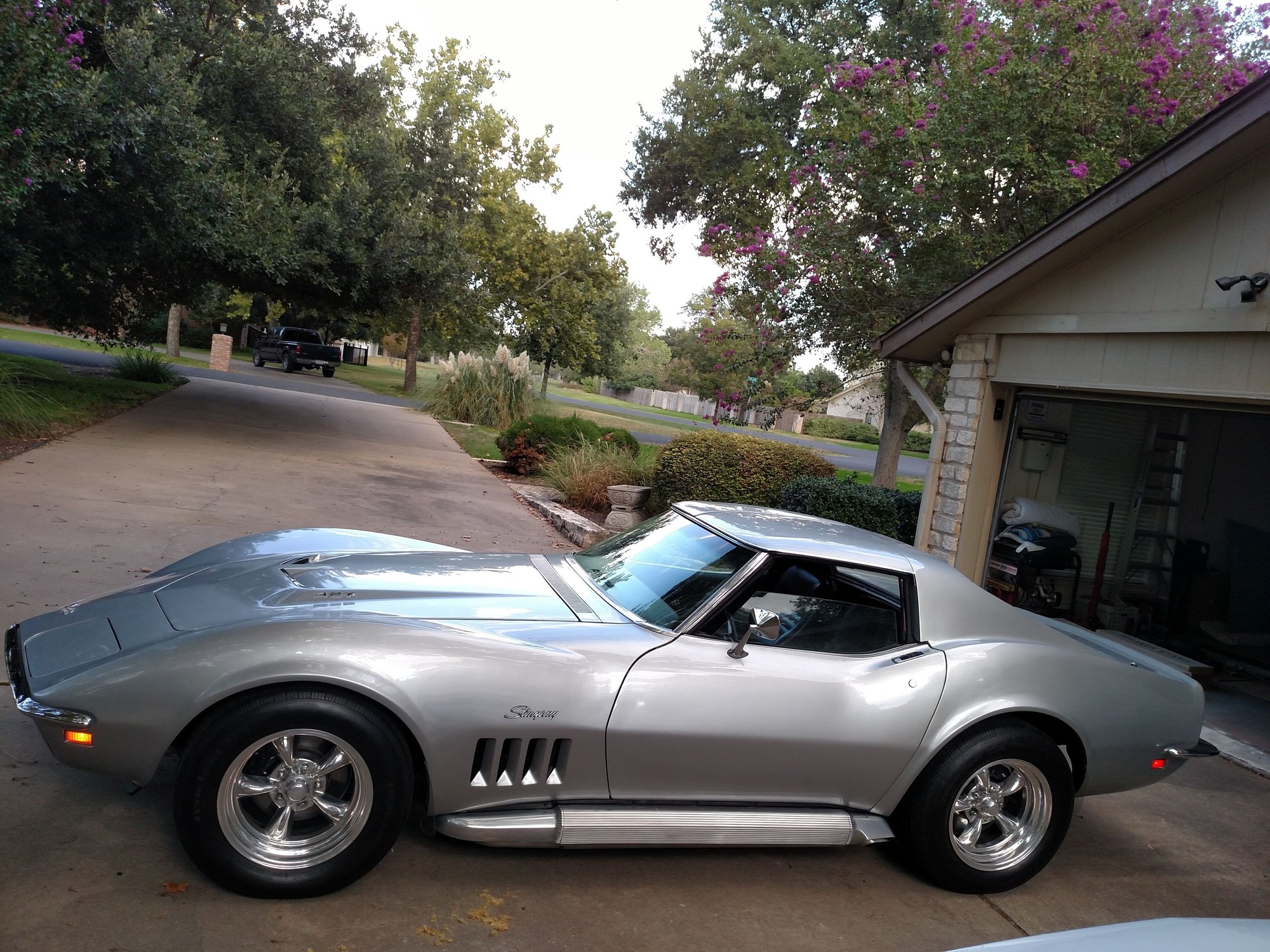

if you zoom in and look very close behind my wheels you will see my solution.
I have built several nice cars and protect them all, I basically make a paper template of a curved mud flap,
then have several cut out of leaxan, and attach with clip on binder clips.
so no holes are drilled into body, have never lost one even if I do I HAVE SPARES.
THEY KEEP THE ROCKS OFF., Show time I just remove them, then slip them back into place.

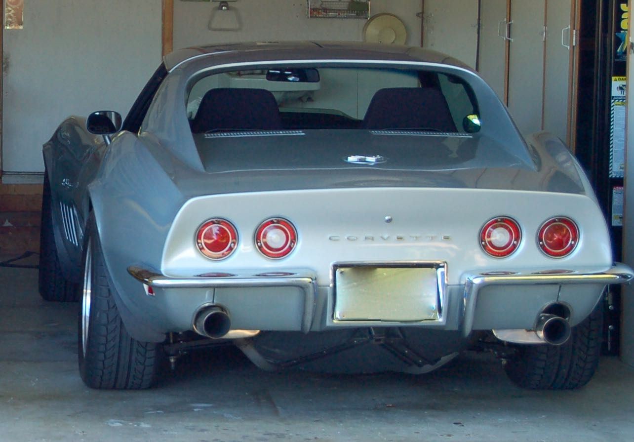

I did what 69vette did on my 71 too-
But the rocks still chipped the rear- so I am looking at something like this-
Several Corvette venders sell these too-

That looks like a straight forward solution. Thanks for the idea.

all four tires do this but there are fewer edges behind the rear tires to catch flying debris.

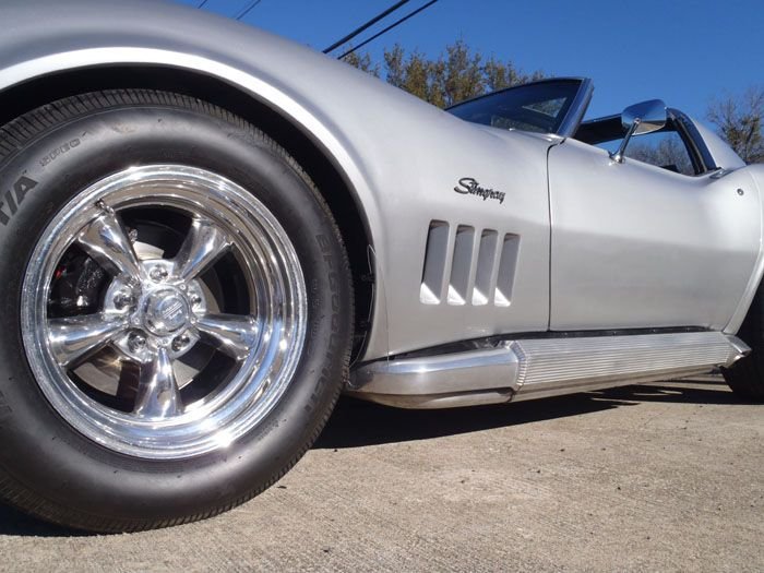

Look closely at this picture, you almost can't see this, I know I never notice it.
There is also a product called "Cleartastic" which is cut to shape for certain areas on your car. I've used that at the front of the rear fender well and it works fine.

I like the look of the cleartastic product. How well does it protect the rear quarterpanels?

What I like about the Cleartastic for small areas is that it has no adhesive. I put it on with eyeglass cleaner and it stays on for highway speeds.
I do not have it on the rear quarter panels. My wheel guards have completely protected that area. They are rolled aluminum with Kevlar fiberglassed to the back side. One place I have Cleartastic is forward of the rear wheel well. I've probably hit a few autoX cones with it and have seen no effects. I also have it in the door jam area to protect against seat belt dings.
