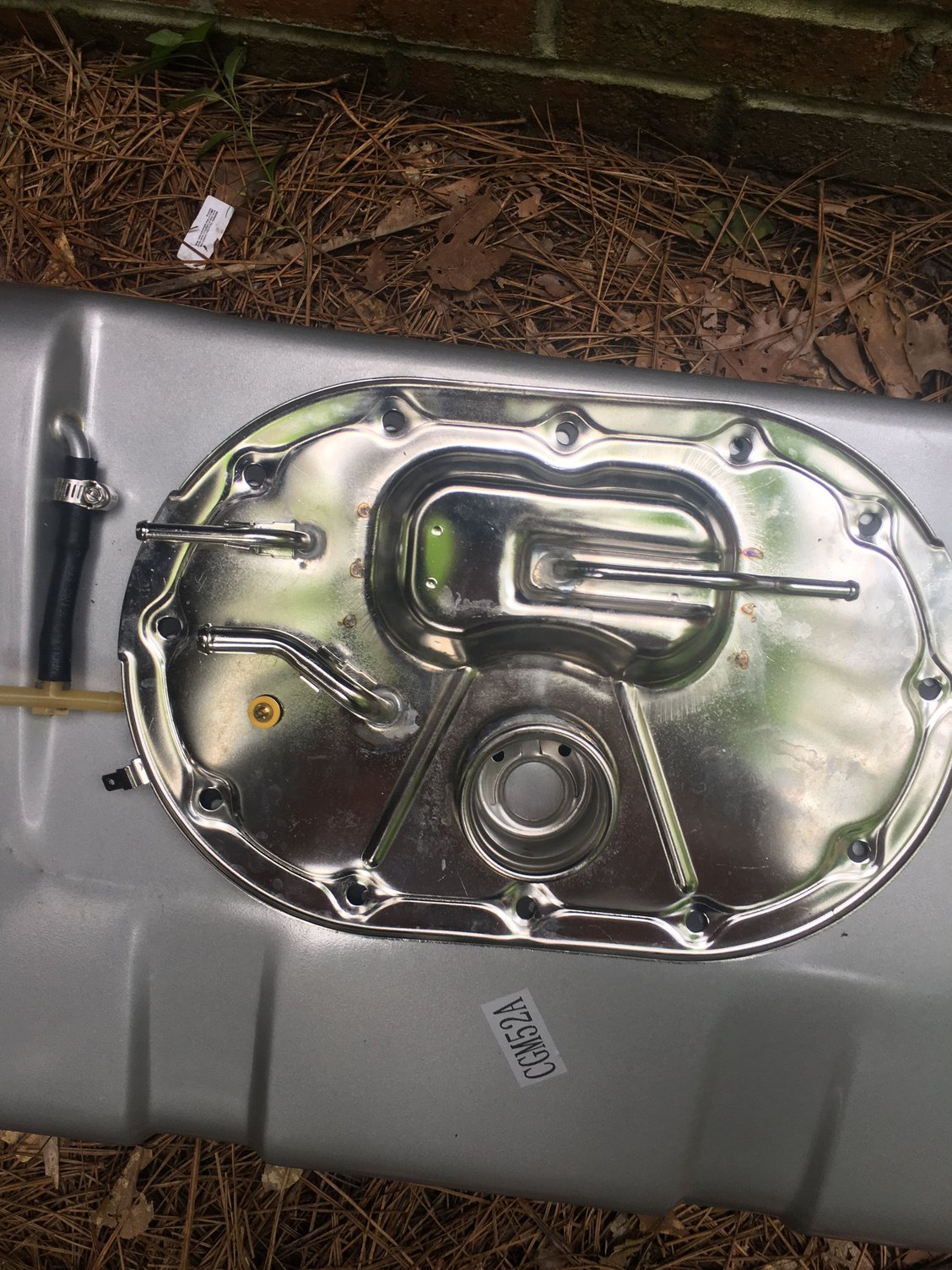

Hey guys we re putting the gas tank in and is that the right way to set the fuel sending unit on there?
Thanks guys
Tanner

No , it goes the other way around .
there's two fuel lines running down the right side of the frame rail, they join up with the two that now point in the wrong direction .
there should be a single line running down the left side (to your charcoal canister , that joins up to single metal (vent line ) with the plastic T joining that short line into it as well .
then the fuel gauge sender wires go on

I agree,,,,just turn it 180, , , , filler neck goes toward front of car, , , that's the only way the rubber drip collection boot could work, don't forget that,
okay thank you
okay thanks!
