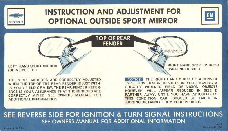

I see people on the forum frequently complain because all they can see in the outside sport mirrors is the rear fenders. If your car came equipped with sport mirrors, your car was delivered with a sleeve pulled over the driver's sun visor. The operation of the mirrors was explained one side of the sleeve.
So if all you can see are the fenders; you don't have the mirrors adjusted correctly.
