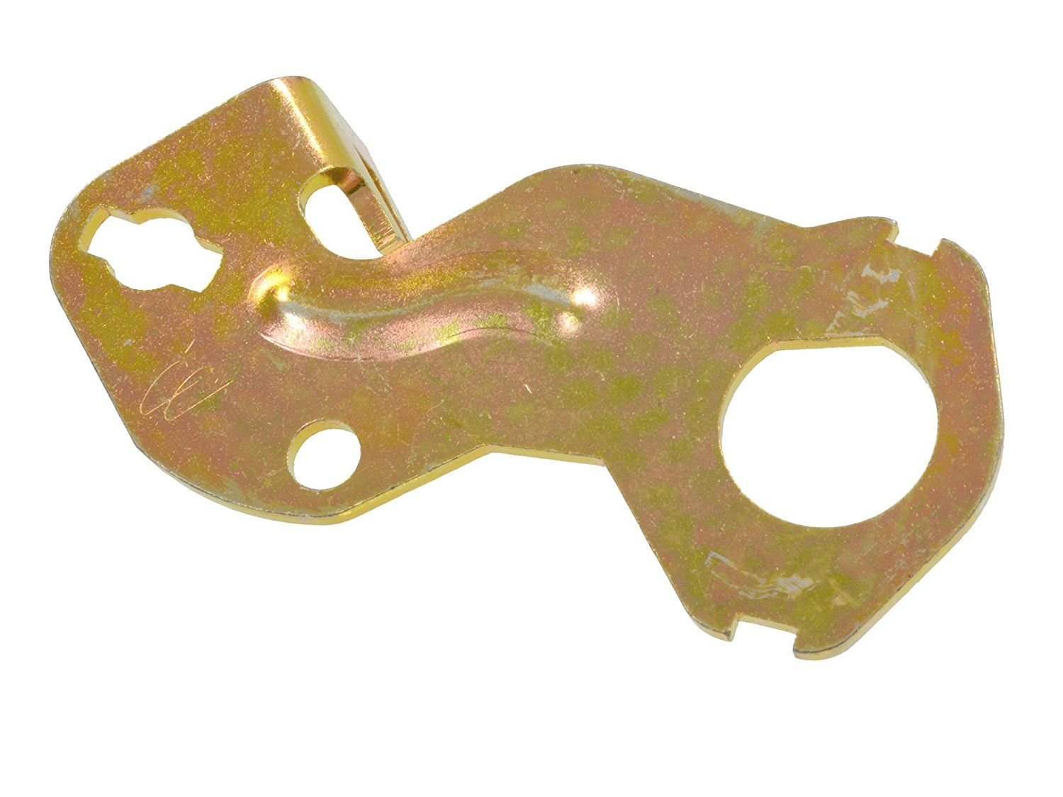

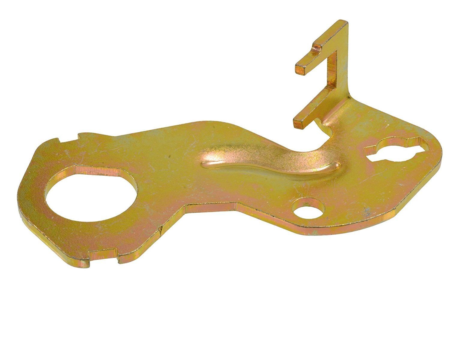

Do you have a picture of a 1971 idle stop solenoid bracket attached to the carb?

Found on Amazon

Another view

I think this may even be one of Alan's pictures...
Good luck... GUSTO
Old Aug 3, 2017 | 08:14 AM
Alan 71's Avatar
Alan 71
Joined: Sep 2006
Posts: 31,281
Likes: 4,372
From: Westminster Maryland
Hi Dennis,
It's an unusual screw that mounts the bracket to the q-jet.
It's a fillister head but it's counter sunk which centers it in the hole for it in the bracket.
Regards,
Alan
What looks like a washer is just the reflection of the screw head in the bracket plating.

Can't see Alan's pictures at work so I will look at those tonight. But the bracket in post # 2 & 4 points to me having the wrong bracket. I'm still waiting on a rebuilt 71 Carb I ordered 3 weeks ago and in the mean time getting all my hardware together.
The bracket I have is for a Holley, I need the Q-Jet bracket.

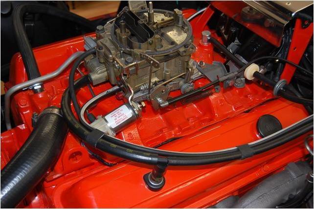

Here is mine, engine still out of the car after rebuild...
Old Aug 4, 2017 | 03:55 PM
Alan 71's Avatar
Alan 71
Joined: Sep 2006
Posts: 31,281
Likes: 4,372
Hi Alex,
Nice photos
Always a question though!
Is there a 'Rochester Products' logo on the front of the plastic choke pull-off?
Thanks!
Regards,
Alan
Old Aug 4, 2017 | 04:11 PM
Alex66's Avatar
Alex66
Joined: Nov 2015
Posts: 600
Likes: 110
From: Mainz
Originally Posted by Alan 71
Hi Alex,
Nice photos
Thanks!
Regards,
Alan
This is the original choke pull of, Lars send it back to me after he rebuild the carb. I have to look for it...
