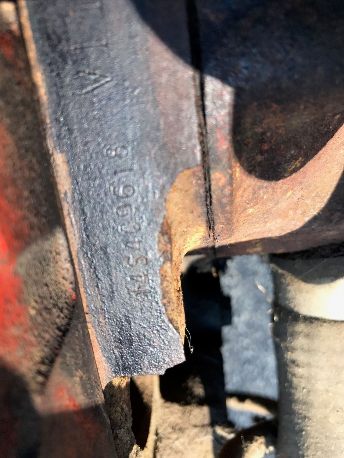

Originally Posted by jv04
It is still not adding up. Could you double check the VIN derivative and confirm that is says 14s469618?
Any chance of taking a picture of the engine pad and posting it.

OK, now I see what you mean. But the OP still hasn't confirmed that the engine suffix code is CLA (unless I missed it). The last word I heard was that the last two characters of the engine suffix code could not be read.
OP, can you take another look at let us know everything that is on the engine pad. Hopefully a picture would help. Thanks.

Any chance you could post a picture of the engine pad?

Old Aug 19, 2017 | 10:24 AM
JohnnyQuik's Avatar
JohnnyQuik
Joined: Jul 2016
Posts: 226
Likes: 108
From: Crescent Beach, FL
Looks like CLA to me...

OK, good job.
I agree that the engine suffix code is CLA.
I also think that the VIN derivative is 14S409618 (not 14S469618). THis would be the engine for a 1974 Corvette, 9618th Corvette off of the line that year.
Cleaning the paint and grease off of the engine pad will make things clearer.
