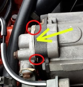

First of all ... Happy New Year Everyone
A BUMP from a previous post ... My year is off to a good start ... my smog pump is whistling more now and I can feel air coming from what appears to be a section of missing gasket.(45+ years and it is falling apart ) I can also feel some of you, as you read this, are saying get rid of it but that is not an option, She is a Survivor and I will respect that.
I have been researching my heart out as to why it is whistling and can I get replacement gaskets or make my own? Do I want to even go there?? Has anyone had this issue or do you have any thoughts as to how you would tackle the problem?? ... One thing for sure is that it stays. ... Thanks in advance!!

Hi OZ,
Might Bill Hodel (330-832-0871) be a source for the gasket?
Does he sell rebuild parts?
Regards,
Alan
Make your own gasket. It is not rocket science.

I'm hearing you my friend ... first it was just a random whistle but now it is becoming more frequent.
... but you have to pull it apart to fit that gasket, have you personally done this?
Originally Posted by SIXTYTWO
... Mine was an original 68 with 37,000 miles but I didn't want the pump to seize or grenade.
Your situation is exactly like mine, however mine can whistle
I will contact Bill and go from there.
